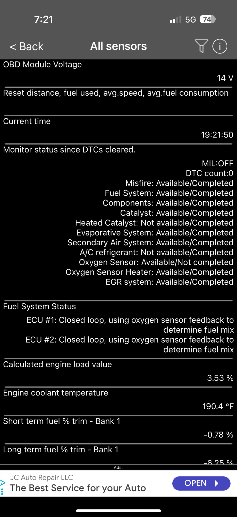

I probably should have mentioned that the car has run great on the same mods and tune for years. I have not modded anything for years - just maintenance.

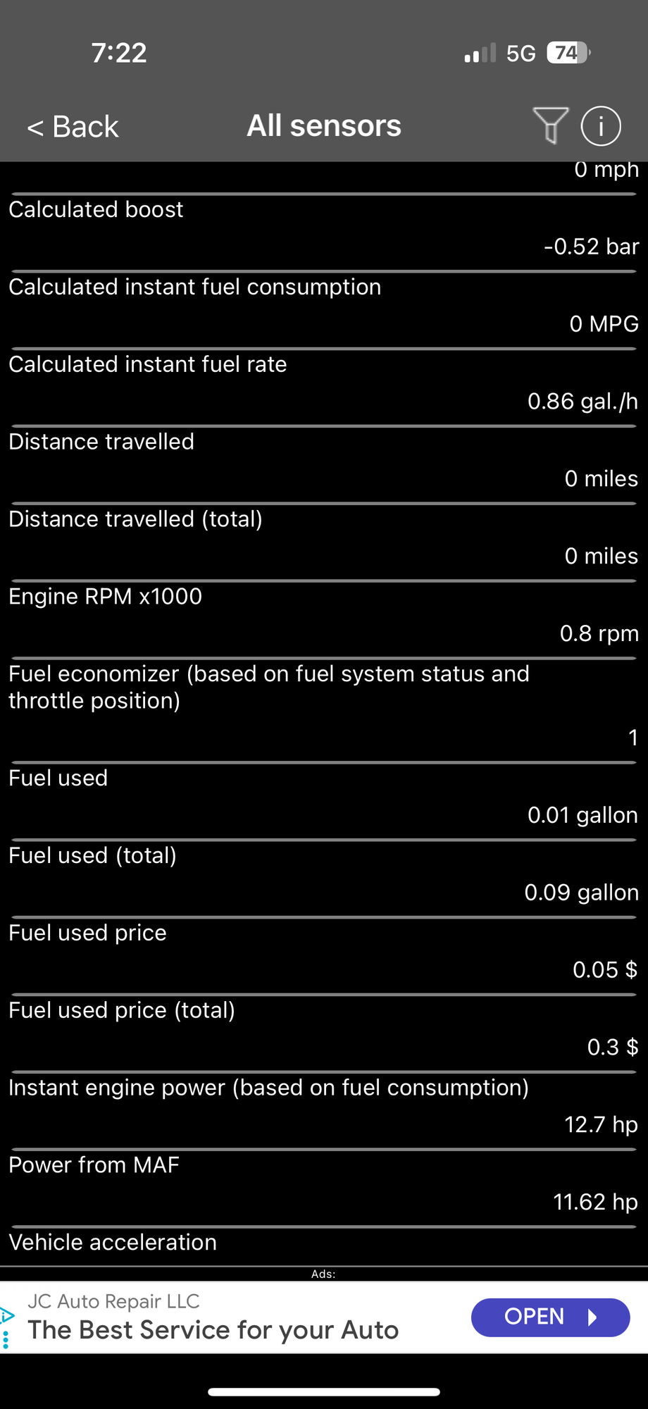

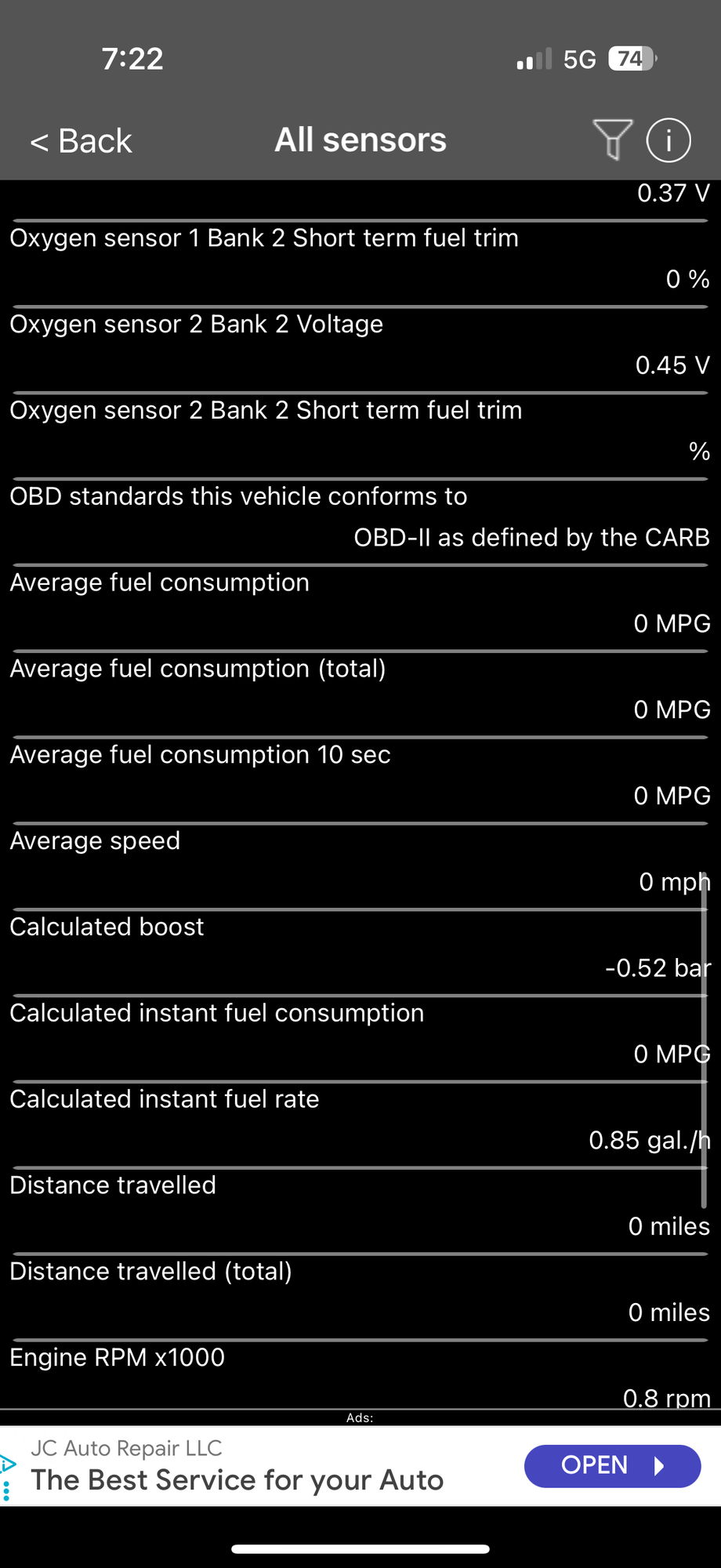

I was thinking it was the maf but I unplugged it and got error codes. Below is the info I got from the car scanner app
I’m not sure if any of these analytics identify an issue

Thank you again for all the responses. I ran it today and it was still running rough and down on power but no backfires. I’m not sure if it’s in my head but it seemed to have a louder tick than usual
I ran a scanner and it did not register any misfires
