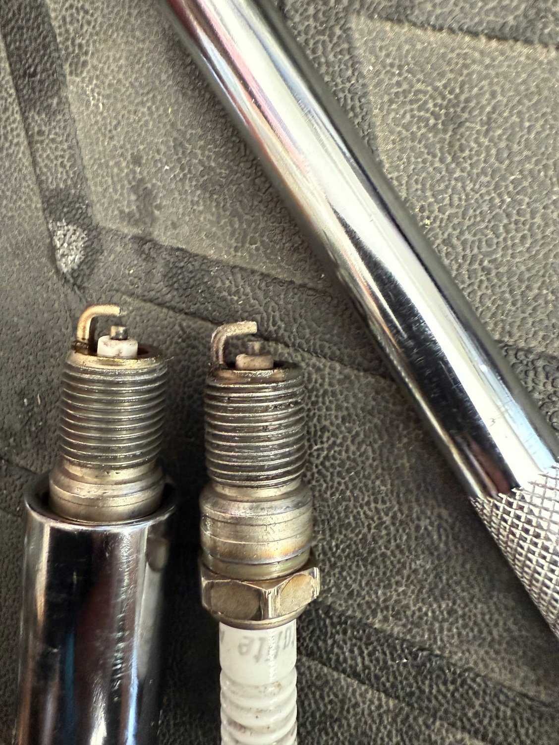

any of the plugs look drastically different than the others or all about the same?
Old Jul 29, 2025 | 02:59 PM
Posts: 7,848
Likes: 5,197
Do the plugs read rich? How do they look?

I think we're all interested to see what plugs look like and what some scan tool diagnostic data would see?
Old Jul 29, 2025 | 04:34 PM
occhevelle's Avatar
Joined: Feb 2011
Posts: 118
Plugs all looked fine. The #2 plug was a little tough to get in and out and I'm wondering if it wasn't fully seated and needs to have a thread chase etc. I'm going to mess with it again tonight when I get a minute to see if that's the issue

Old Jul 30, 2025 | 05:08 PM
occhevelle's Avatar
Joined: Feb 2011
Posts: 118
#2 vs #4 plug
