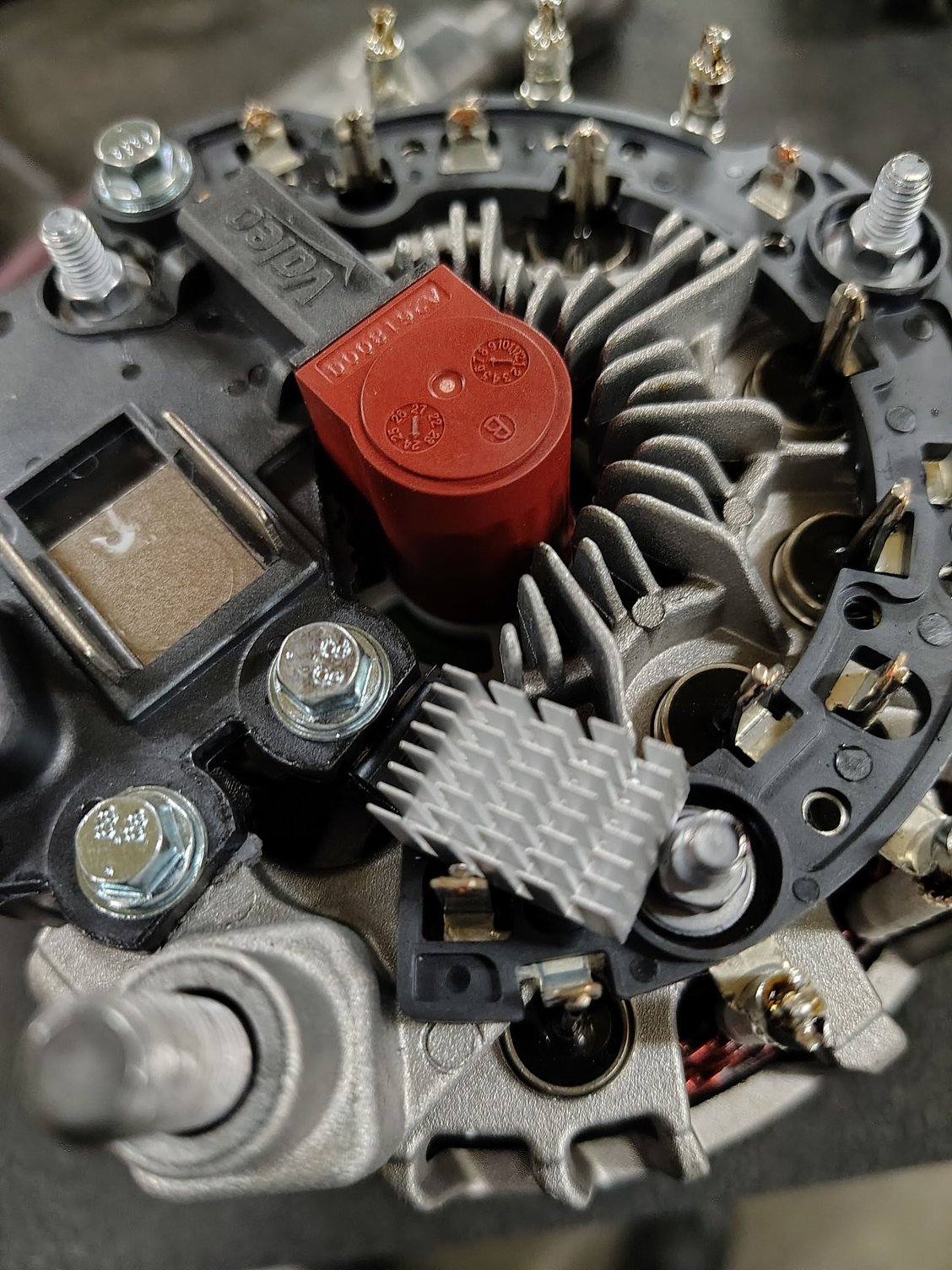

I have a 2011 Camaro SS2 6.2 LS3 it's had cam changed heads front 2 peace timing cover vengeance's racing cam tuned ran perfect..my alternator bearing starting singing loud so I ordered a new AC Delco altinator replaced it my car went crazy.i pulled it off an the heat collector on the back had fell against a hot post I put the old one back on an now I have a prolong crank ck engine light on for knock code an cam code.i changed the cam sensor still same thing any body got a clue
This is what the back of the new alternator locked like after I took it off an popped the back cover off

Sounds like you shorted the alternator's power post to its case (ground). That likely sent a surge through the electrical system. You probably fried a fuse or damaged the ECU. Check all your fuses, especially any for the fuel pump and ECU. Even if they look good, swap them. The ECU might need to be checked or replaced. The cam and knock sensor codes are a symptom, not the cause.

Traced cam sensor wires back from sensor an pig tail found a burned up wire repaired it starts up fine an codes went away thanks for your help an I'm glad I found it
