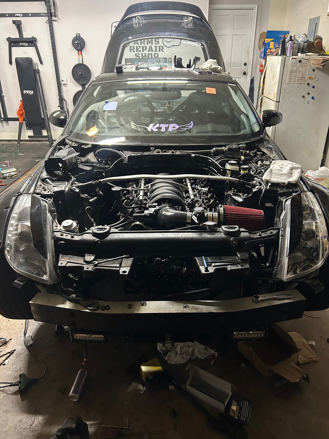

Hello!
I’m in a pickle here, i need this car done and fully broken in, in time for GAT this year. I needed this thing running last week. I’ve been having alot of troubles getting this car running. I first tried to run the motor on the stand unsuccessfully because my ECM type was never set to (Manual) so it wasn’t trusting the P/N safety and wouldn’t pulse the injectors. Then after I dropped the motor into my Nissan my tuner came over to flash the new tune after realizing he forgot to switch the ECM type to manual. And sure thing first attempt to start it, it fires up, and then immediately dies. I assumed it was because my tuner hadn’t yet corrected the injector data for my ls2 injectors, but me and him looked at the data, and even though it’s not correct it’s very similar, only about 2-3lbs off. So it should still run, just not well, so I got back to it to try and get it running, but then it all the sudden wouldn’t start at all. I could still smell the gas, but the thing wouldn’t start. So I replaced the battery because I had been doing lots of wiring and I figured I had just killed it. And then after I pop the new battery in, it starts, and then dies after. So I was like “great now I can play with it and maybe try to keep it alive with some throttle input” but no, I come back to it the next day and it’s the same thing, it won’t start at all. So now I’m here hoping someone with a fresh mind can tell me I made some silly little mistake that is inexpensive and quick to fix (hopefully). Any ideas please let me know. ( tomorrow I’m going to get my big snap on scanner on it to verify the vats has been properly deleted and is not activating, and to also hopefully spot the issue. ) thank you

So I verified that’s the CMP is good and reading well, and that the VATS is no active, and I’ve also confirmed the car stays alive with spray, also looked at my live data and it’s commanding an a/f ratio of 0.3:1 WAY TOO RICH, pulled #1 plug, sure enough it’s soaked. So it’s running way too rich to run. Why is it commanding a rich fuel ratio. Also keep in mind I’m running ls2 injectors which aren’t compatible with my computer but only have a slight difference from the factory injectors of 2lbs, so do you guys think even though the injectors are close, that maybe the ECM just can’t control them the same way? Or should it still run? Just not well.
