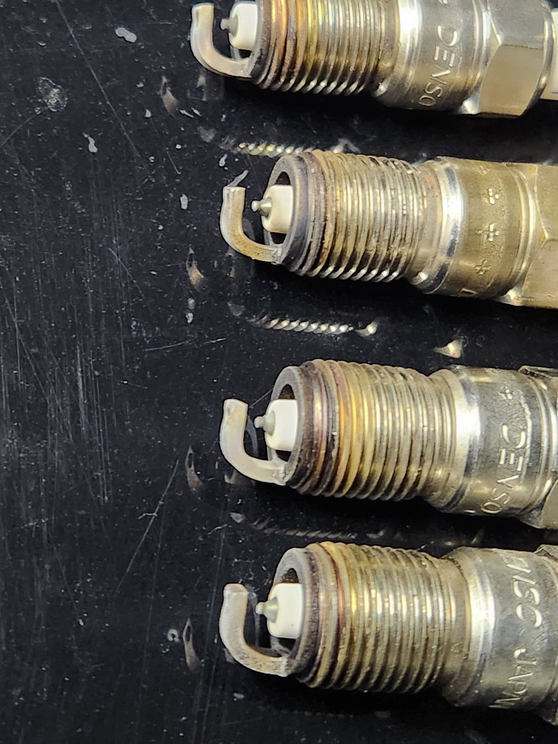

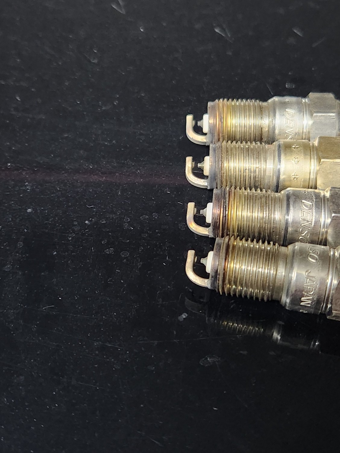

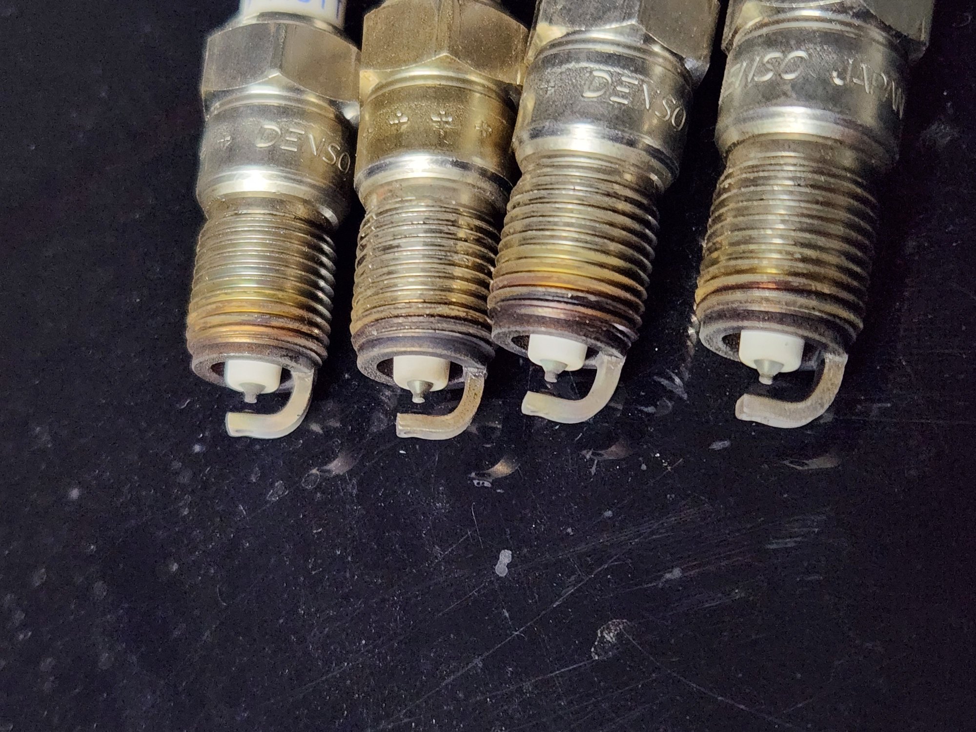

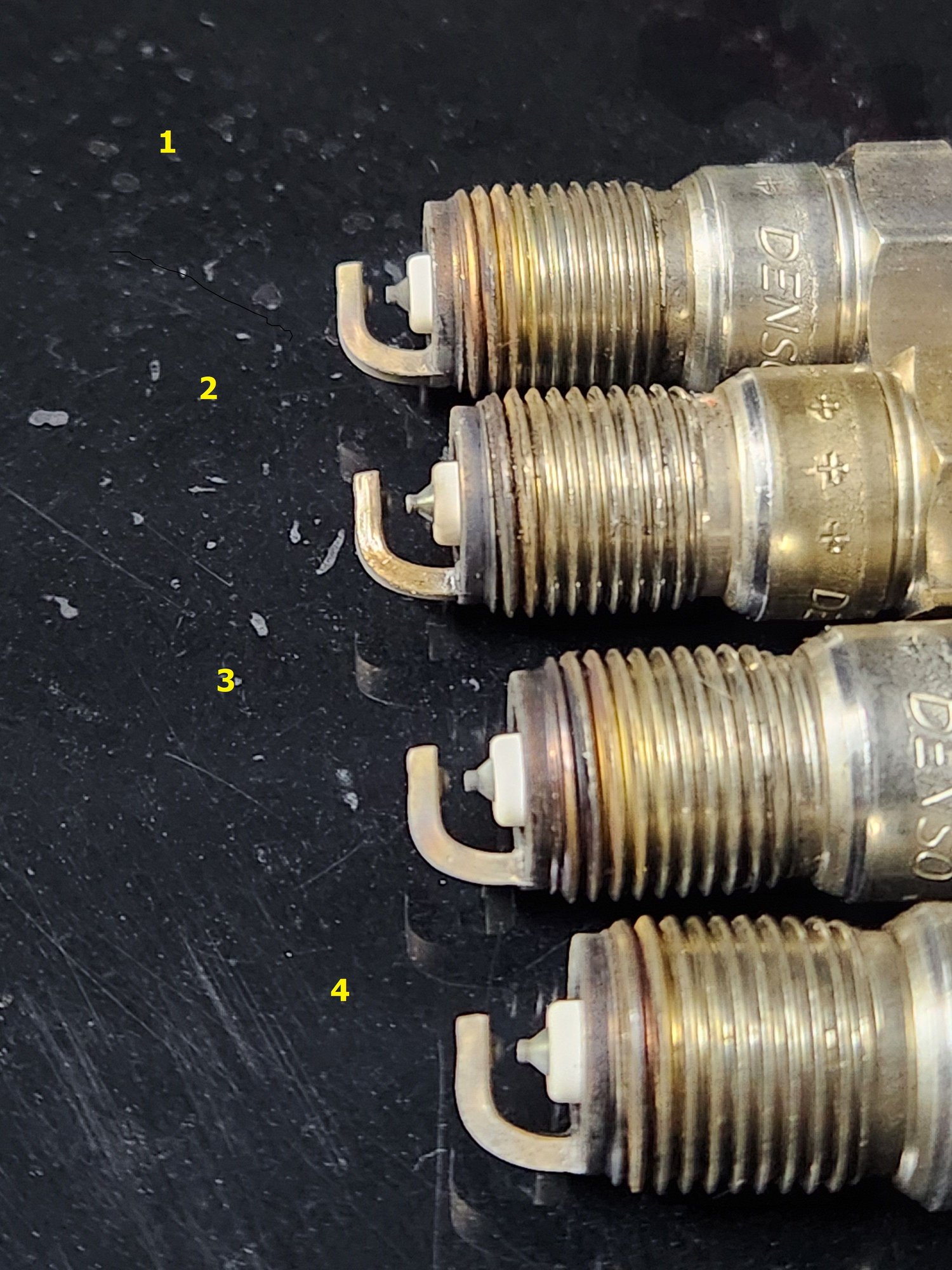

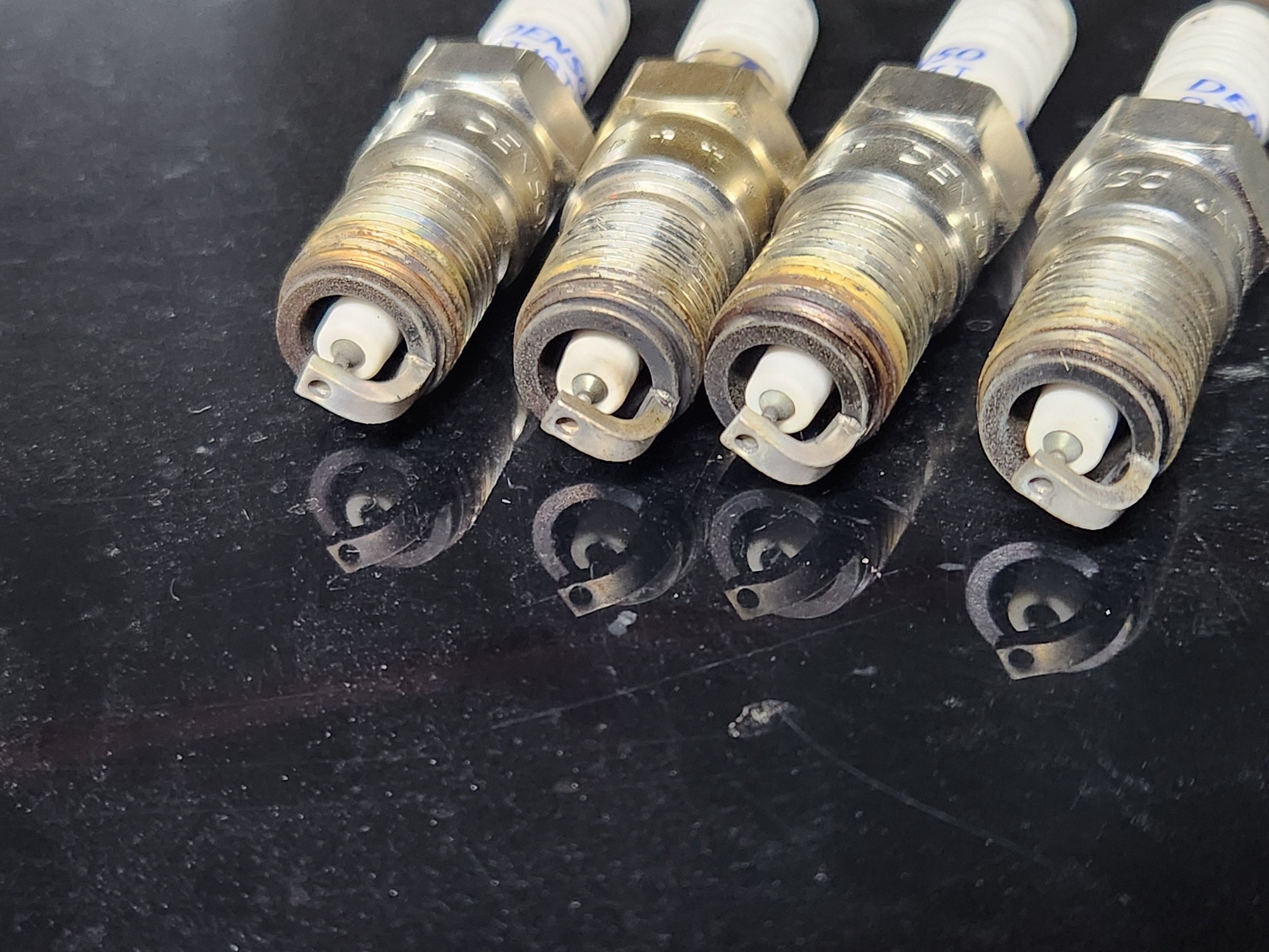

Check your plugs on bank 1. It is reading so consistently lean that I suspect more than just exhaust leaks. I have a feeling you have a cylinder barely ever firing.
uh oh.... does it look like plug 2 is getting too hot? (maybe an issue with injector 2?)
plug 1 is towards front of the car on bank 1.
Plugs are DENSO 4511 with stock 1mm gap. bought new and have been run for 500km tops since the swap.

Hopefully someone who knows what they are talking about when reading plugs will chime in here. That 2nd plug definitely looks different, but beyond that, I could not say much with any confidence. It is possible that an exhaust leak before the o2 sensor is causing a false lean reading, but I don't know what to make of that plug looking so different.

PS. I went down the plug rabbit hole when I built my engine and started tuning. They can tell you a LOT... That said I think they look fine. If you need to buy a new one and hold it next to yours. I don't think they look fuel washed, nor carbon built up, the electrode doesn't look burnt out either.
