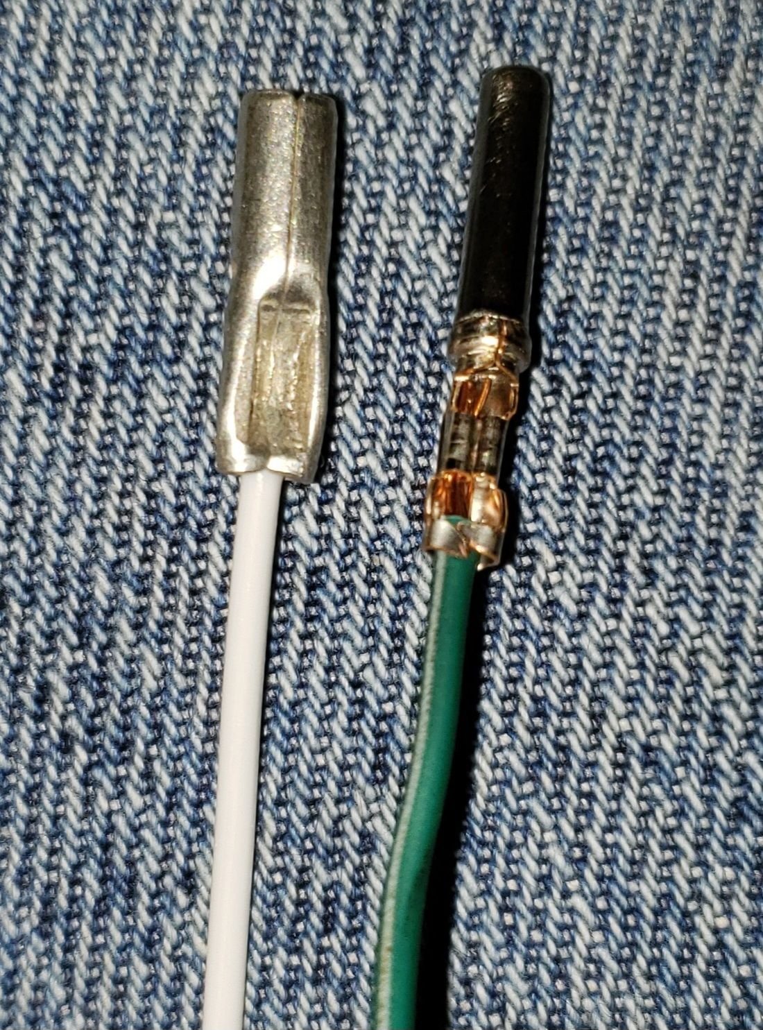

Proper crimp and then 4:1 marine quality epoxy lined heat shrink to seal out moisture permenately and strengthen the joint. I like uninsulated barrel/butt crimps large enough to insert the insulation jacket for strain relief. Insert both wires fully and give a twist before crimping. The only places I have seen GM ever solder a factory harness have been crimped first and covered with epoxy lined heat shrink. I have tested the resistance of both methods, the average solder joint does not win. The average crimp will win 9 out 10 times. I just built the harnesses to run my IGN-1A coils and there is not a single soldered joint anywhere in it.
Both GM and Nissan allow for solder sleeves for wiring repairs though take that as you will. If you must use one, twist the wires together first, then slide it over the twisted wiring splice then heat it to solder/shrink it. I would still put 4:1 epoxy heat shrink over it. I used solder sleeves in a pinch replacing the 13 pin transmission connector pigtail that was damaged on my 4L85E by road debris on a trip numerous years ago laying on my head under the vehicle but that is not my normal go to repair.
I did a rather aggressive tug test on these crimps. I broke the actual wire before the crimps pulled out and that was without the epoxy heat shrink on the barrel crimp. On that open barrel the jacket is inserted about 1/2 the distance from the end to the center stop. The conductors meet at the center stop and are lightly twisted into each other before the crimp is made.
