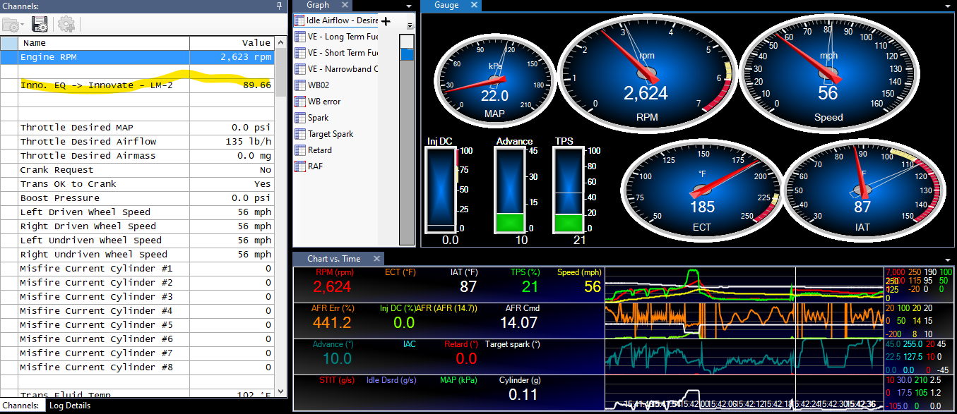

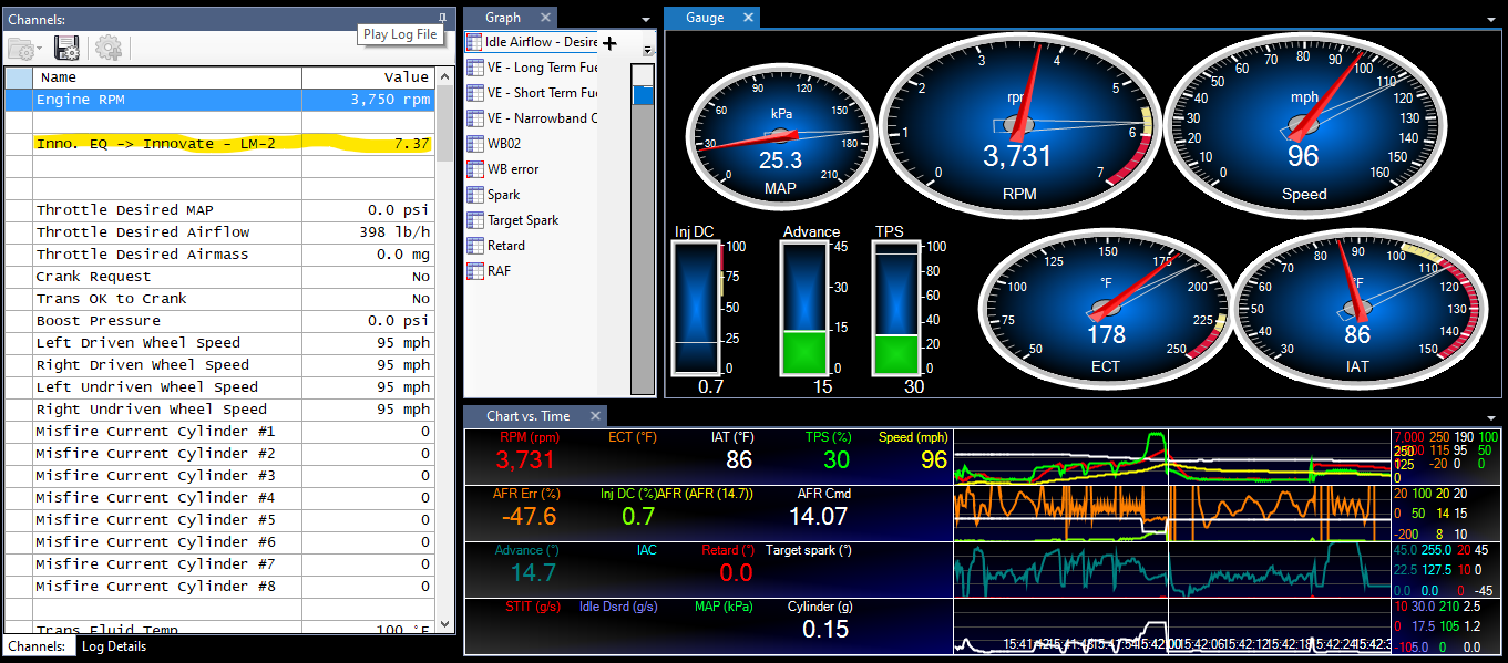

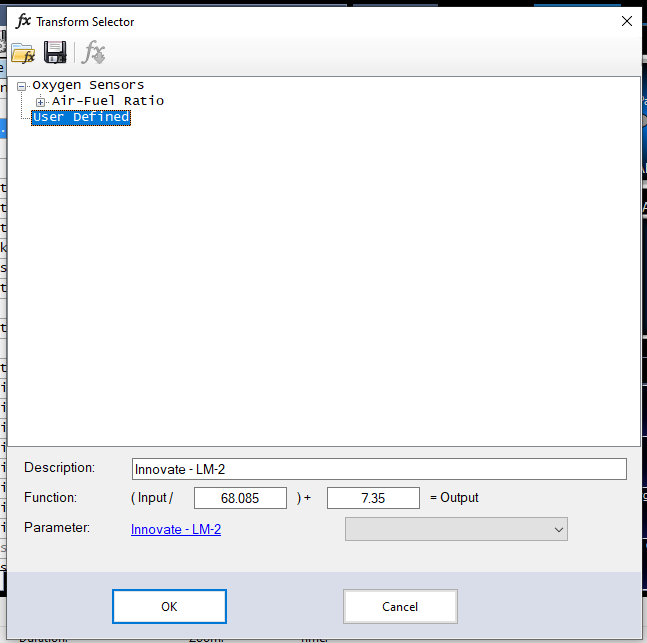

I am trying to figure out some wideband issues I am having with my Innovate EBC-1. I have it hooked up via serial and it seems to be working fine during cruise, idle and WOT. However, when I decel and it goes full lean I get these crazy numbers and it just gets hung up on 7.37. But while on decel it throws crazy numbers all the way up to 1xx. Has anyone ever encountered this? I have attached some screenshots for reference.
