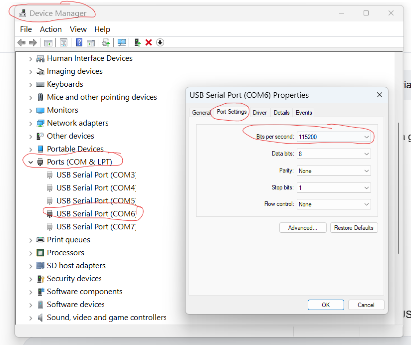

Make sure your Com Port setting Baud Rate matches the Vgate vLinker (115200). Also, make sure you use USB 2.0 port (A plain trident symbol usually indicates USB 2.0) Also set your Latency Timer to 1ms and make sure your Receive/Transmit Buffers are set to 4096 Bytes

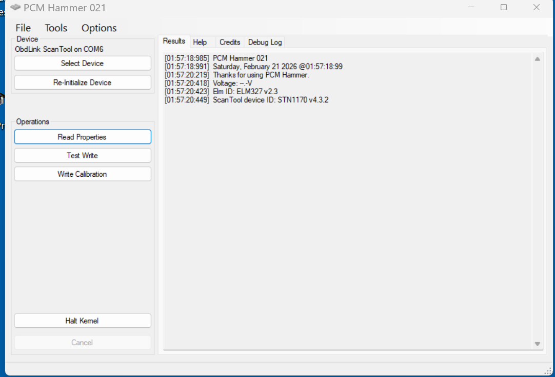

[QUOTE
Can someone who has one please copy-paste the first few lines that PCM Hammer prints, when it connects to the device? I'm curious as to which version of the STN11__ chip it has.
Thanks![/QUOTE]
Thanks for the instructions here, however even after doing this it remains extremely slow to read and now just times out when trying to read entire PCM. Both of my USB ports on my laptop however are USB 3.0 and not USB 2.0.

Here are the first few lines from the bluetooth MS version:
[03:52:13:764] PCM Hammer 021
[03:52:13:773] Friday, February 20 2026 @03:52:13:77
[03:52:15:516] Thanks for using PCM Hammer.
[03:52:16:826] Voltage: 12.3V
[03:52:16:830] Elm ID: ELM327 v2.3
[03:52:16:874] ScanTool device ID: STN2120 v5.8.1

According to what little information I have, the STN1170 is equivalent to the chips in the ObdLink SX and LX, but the STN2120 should be able to support sending and receiving larger messages, which should make it a bit faster. However, a code change will be required to take advantage of that, and it will take some testing to validate that change. I've ordered a VGate VLinker to experiment with, but I can't promise when I'll get around to it.
Also, these devices, and the ObdLink devices, suffer from an issue where they miss incoming messages from other modules in the vehicle during the "everybody shut up, okay?" step of the flash process, which means they could miss a "no I won't shut up" message from another module, and that module could subsequently interrupt the read or write. I haven't seen that happen in my own vehicle but I do wonder if that's what causes issues in other vehicles.
