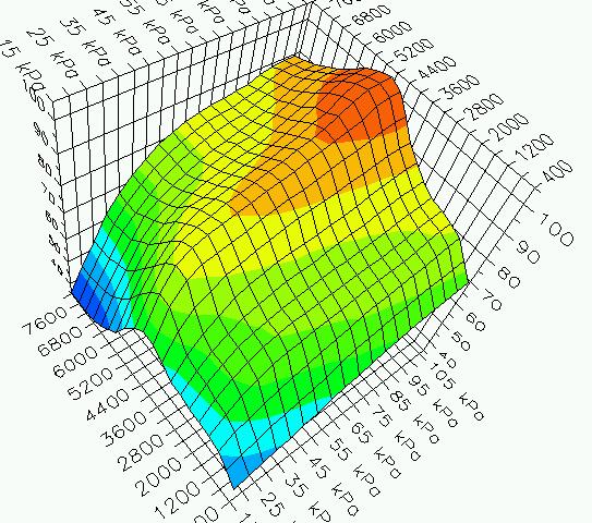

We spent alot of time last night on my car but here's my new VE table Idles better than with the MAF that's for sure...

They are all starting to look very similar. Mine looks pretty close, but I am not done yet.
