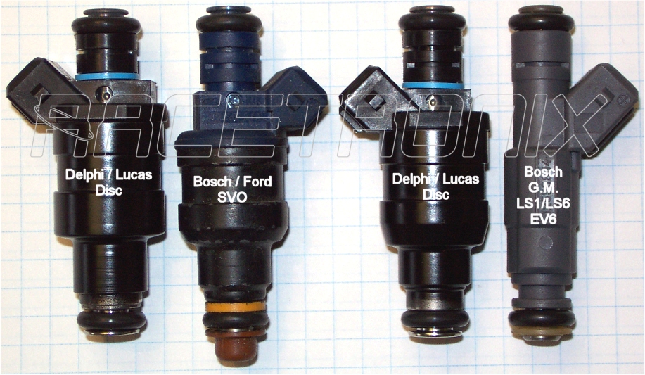

also, look closer at my picture, it looks nothing like the one you posted up of your injector that is next to the gm one mine looks like the one next to the ford one. why is there a difference in size like that, and does that matter how much it seats in the rail??
The Delphi injector with two slots is a 42# and the injector with the single slot is the 32#. As long as the o-ring is pushed in far enough so that it compresses to provide a seal you are ok. The injector should not be able to come out from the fuel rail or intake bore far enough to break the seal once it is secured. Always clean the bores 100% and lube the o-rings before insertion. Once done run a pressure test and check for leaks.
Now thats a little better
