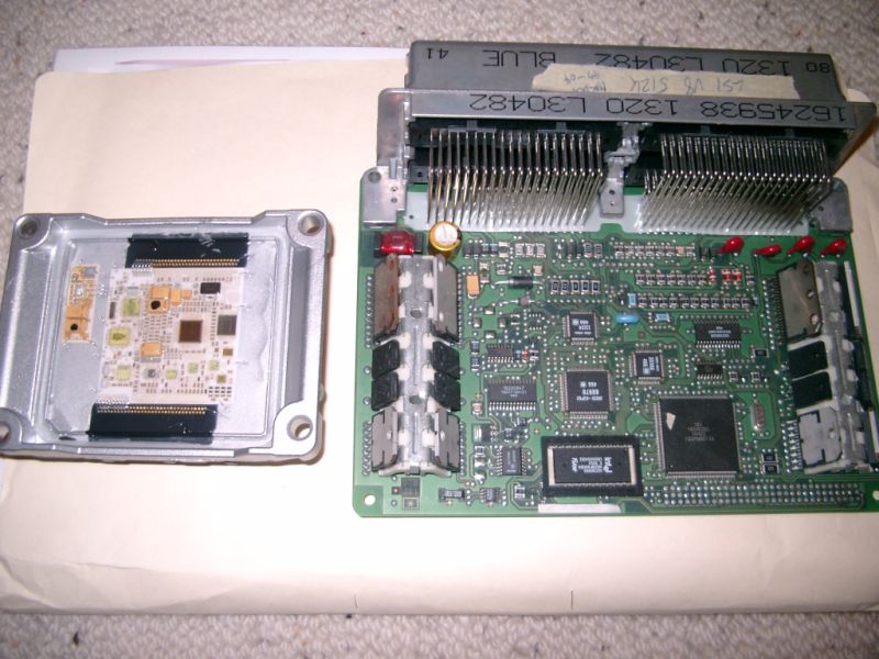

Hard to pick one OS and one calibration if you then want to flash that back into the customers PCM. The main point i was making is the hardware difficulty moving forward.
As an example take a look at this. Thats an LS1 on the right

^^^ ruh roh... I think that voids the warranty on your PCM
