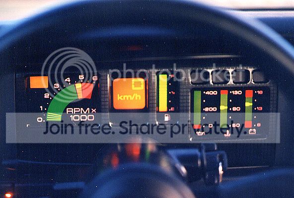

okay thanks. I need the CLS to not only plug the hole, but to keep the dash from telling me low coolant (when in fact it is not)
Image borrowed from google shows what I mean about the dash. (I'm not sure if you guys that have 4th gens know of this option on 3rd gens)
It looks great at night, but when something doesn't work, it certainly makes a point of telling you. lmao
