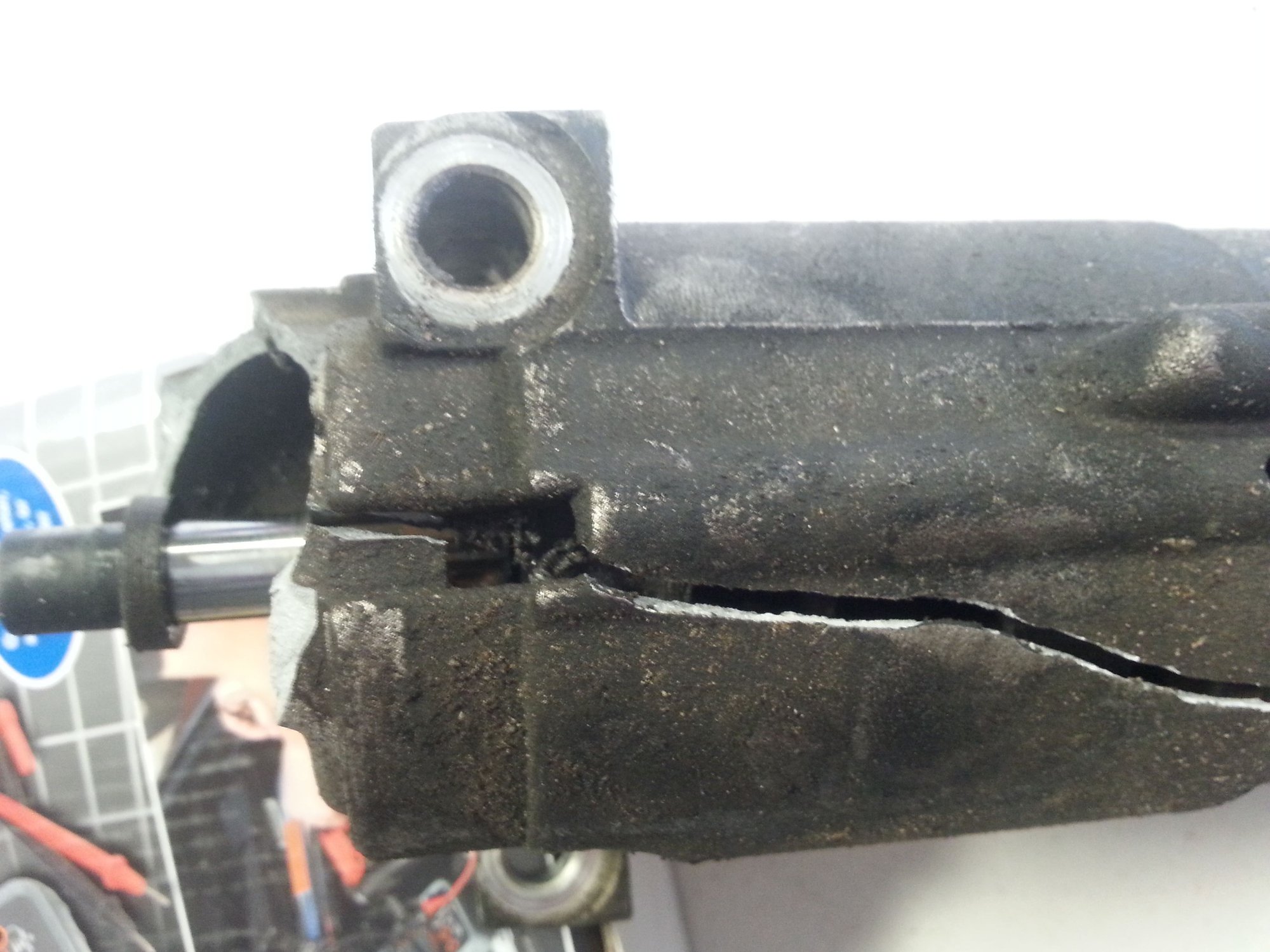

I have a 1998 firebird trans am 5.7 bone stock 114k miles. Yesterday we cranked it up it started then immediatly died, when it was turning over it seemed slow turning like weak battery or out of time. After it died the starter would just click. Checked battery and it is fine, pulled starter and the nose was broke off and case was split down the side. No mounting damage. Pulled out broken pieces of starter from bellhousing then I installed the new starter, engine cranked right up but there was a loud knock. The knock sounds like it is coming from the top of the motor. Any recomendations on what it could be or what I should check first. I was going to start with pulling valve covers and checking that area out. Any ideas will be appreciated, Thanks in advance.

This is the starter

Unfortunately what you describe in a hydro lock situation. Has the car been sitting outside in the rain? What can happen is the rain leaks past the windshield cowling down on top of the engine. The water finds a way into the intake manifold through the gaskets and slowly collects in the intake. Then you try to start it and that water goes straight into a cylinder hydro locking it and either breaks the starter OFF completely or it breaks the housing and sometimes does internal damage. Bending a connecting rod, broken piston etc.
I think if you close your hood and run water over the windshield then open the hood you will be very surprised how much water is leaking onto the engine. When the car is new and gaskets and intake manifold bolts are tight you can get way with it, but with time the gaskets shrink and bolts loosen then water can get in quite easily.
I'll give you a good example over time the gaskets shrink and bolts corrode in the threads. The bolts feel tight but only the threads are tight, the manifold itself is loose. Its hard to get this through peoples heads when I tell them I'll bet the intake is loose but they say no the bolts are tight.............................
At this point you need a good mechanic to pull it apart, find the damage and have it repaired.
1st thing I do to every fbody I buy is seal the windshield cowling and loosen all the intake bolts. Lube the threads and bolts then tighten to proper torque. I had a few close calls in the rain before I discovered why. My 02 Formula always started funny like you described above after sitting overnight in the rain,until I opened the hood and seen the water dripping over everything. After I sealed the cowling and tightened the intake never had a problem again.
Good Luck to you

That sounds like what could have happened. It was sitting in the driveway and it rained all day before we went out to move it. We had multiple inches of rain.

Dropped the motor and found #6 connecting rod bent. Everything else looks fine so far. I will definetly be sealing the cowl before I put everything back together.
