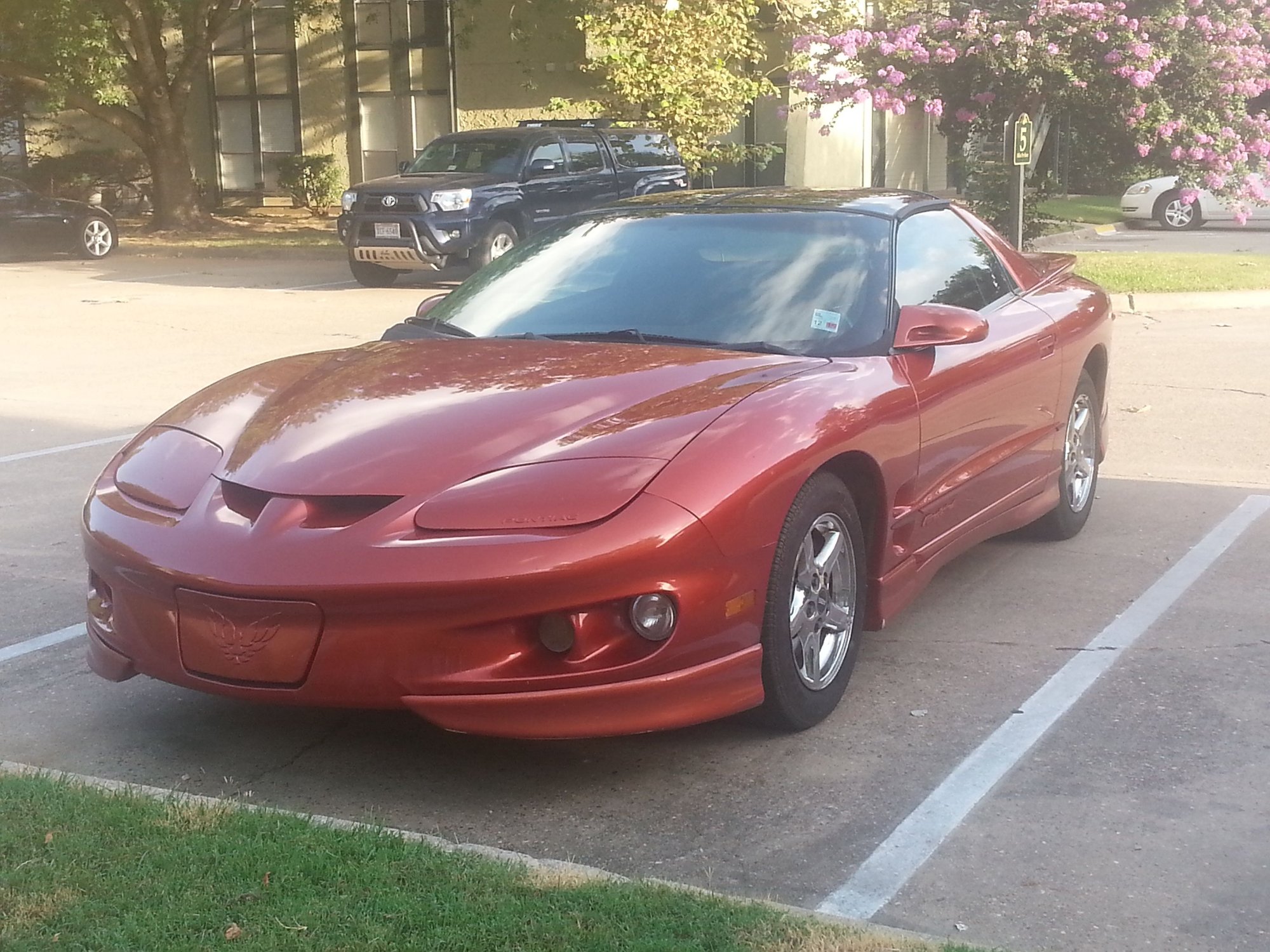

Hello everyone, I need help. I have taken my car to 5 different mechanics and none of them can find the problem so I turn to yall!!
Ok here goes, its an 01 Firebird 3800 (but its SOM haha) The temp gauge goes up into overheating, no service engine light, but the car is not hot! has been checked with computer and everything so ok they say bad gauge, common problem right...idk..... once the car sits on 240+ degrees for maybe 2 miles it will quit taking fuel, the engine is running just nothing happens with the pedal it will spit and sputter for a second before it does this....but basically when u give it gas it does not go....this happens while driving....give it a couple hours to cool off and it will run just fine for maybe 20 miles then same ol same ol....anyone heard of anything like this before? any help greatly appreciated

Sorry - no help but all the best getting this resolved, just wanted to say that is one beautiful Bird!

Nice car, and unusual color.

Stan1911- thanks!!
If anyone is interested I am located in Chicago and the car is for sale. Car has 173k miles but engine has 143k (I have documentation).Interior is in excellent condition. paint is loosing clear coat on one quarterpanel. T-tops do not leak. It is Sunset Orange a very rare color! I do not know the details on how many were manufactured but I think there is a SOM forum here that im sure someone could help with that info. If anyone would like more info hmu.
