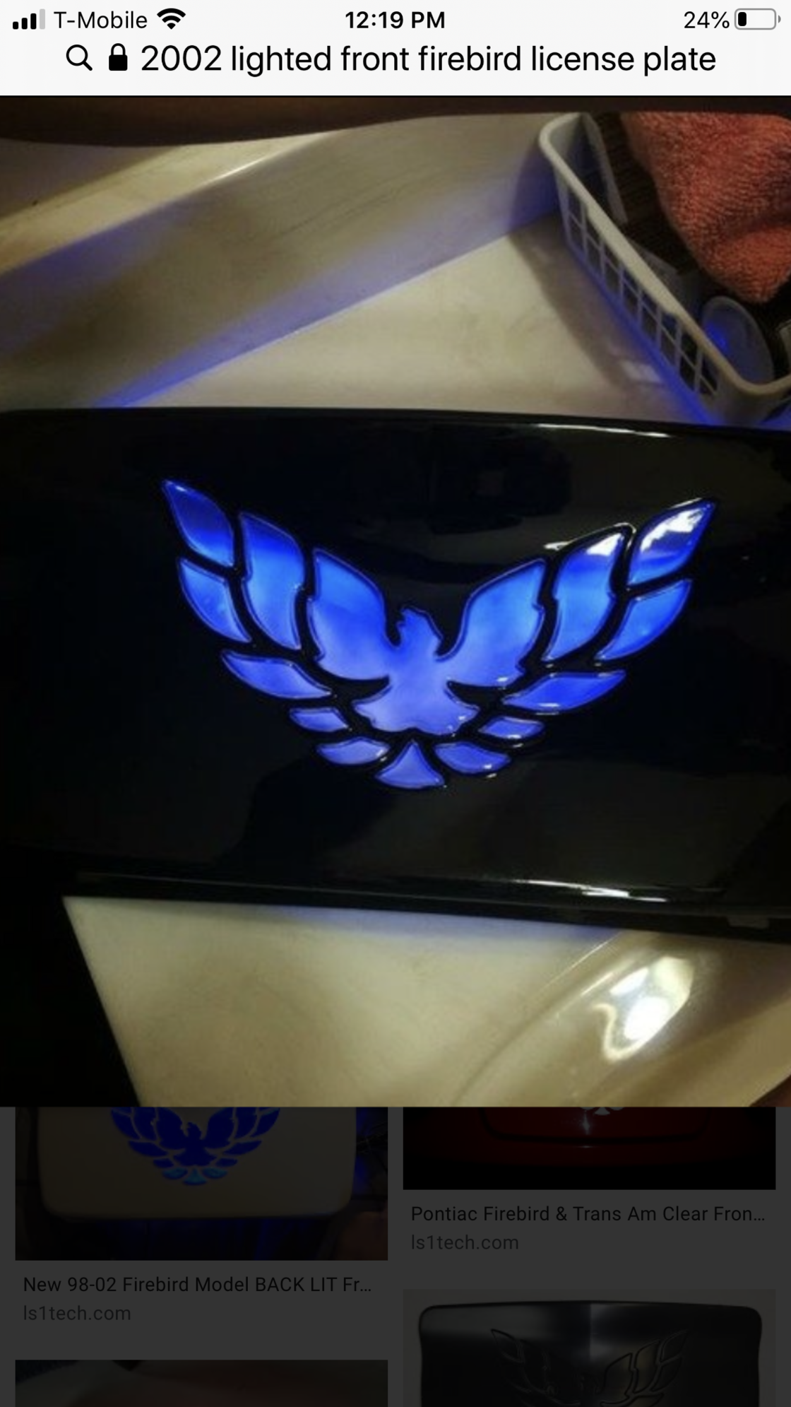

“Lit” front bird
Old May 10, 2020 | 11:22 AM
toplesswhite's Avatar
Joined: Apr 2020
Posts: 57
Likes: 15
From: South Florida
Default “Lit” front bird
Does anyone sell these?

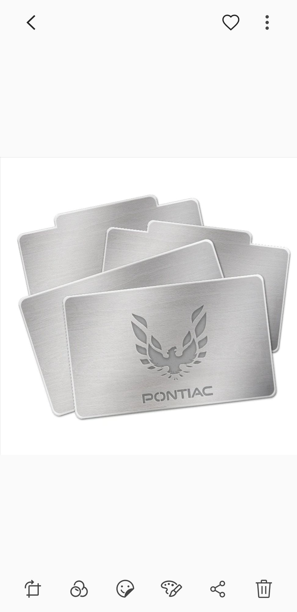

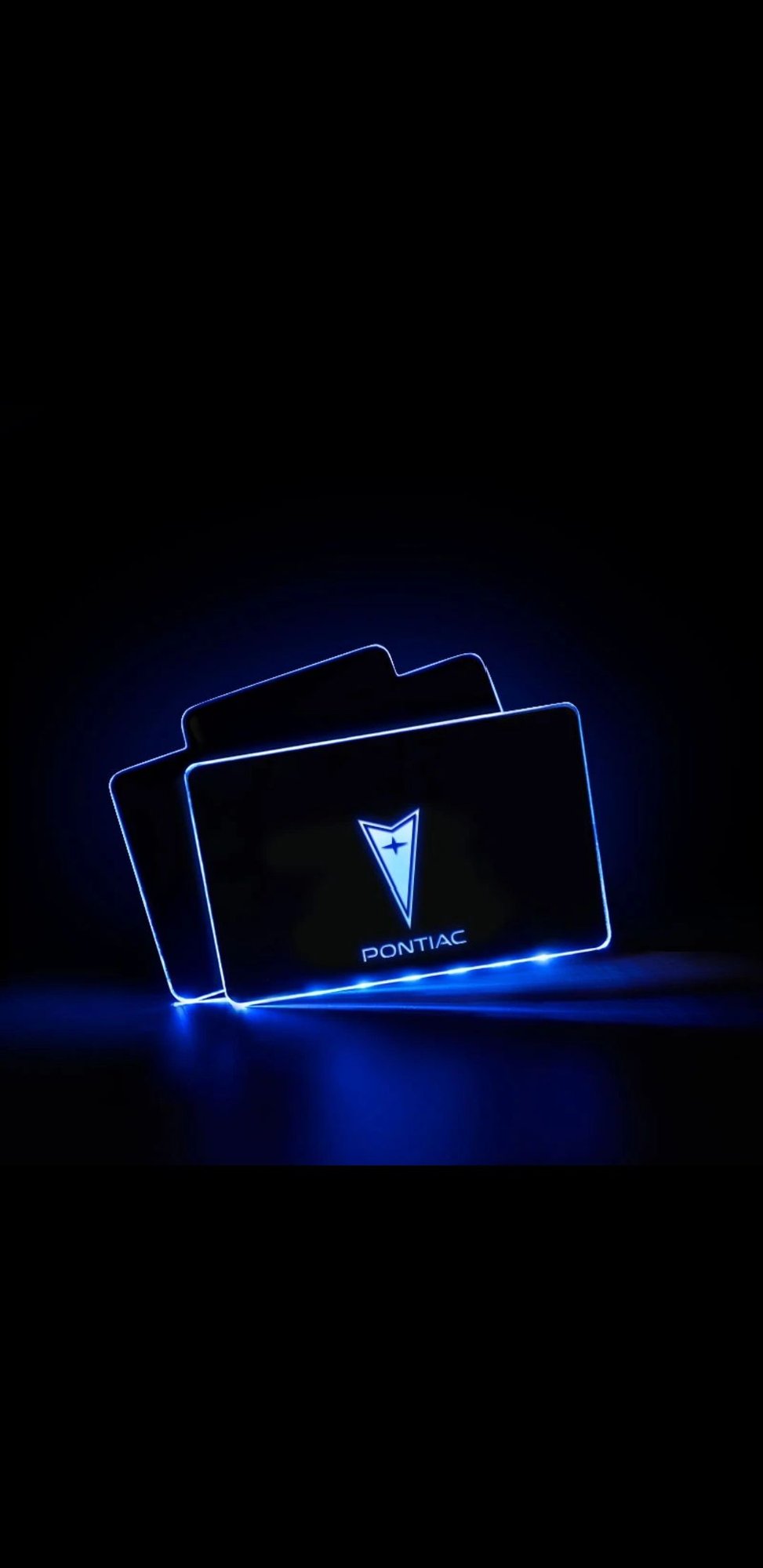

photos below are
illuminated color changing sill plates...floor mats...projector lights...clear license plate front cover...fog light switches.....
up to you to think outside the box and get creative with all the cool lighting options available to us out there and projects to build and create yourself

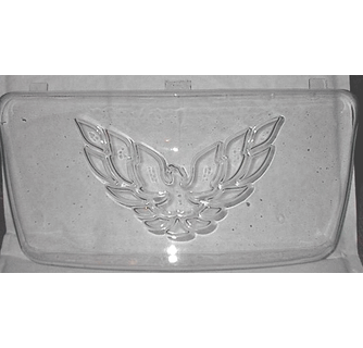

Clear front license plate cover. $65.00 each

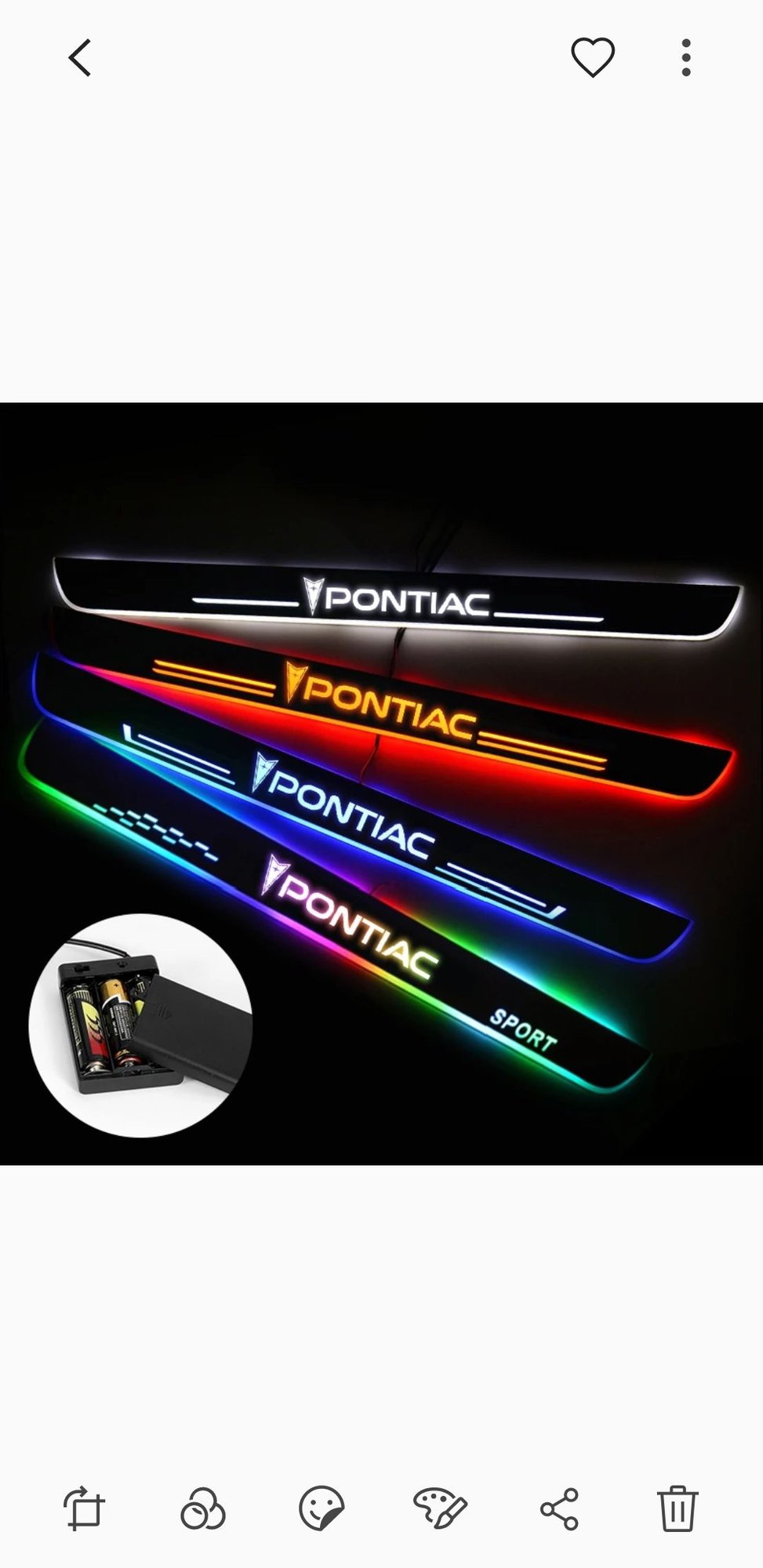

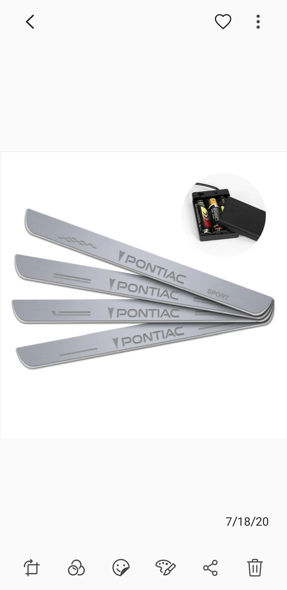

Illuminated sill plates
Illuminated floor mats
Illuminated sill plates. 99.00 per pair

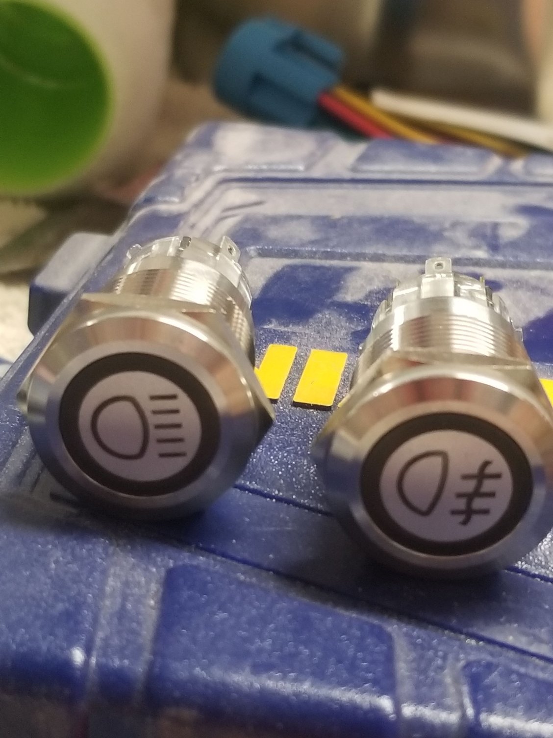

Fog light illuminated switches with 5 leads (amazon...5 dollats each) includes wire harness

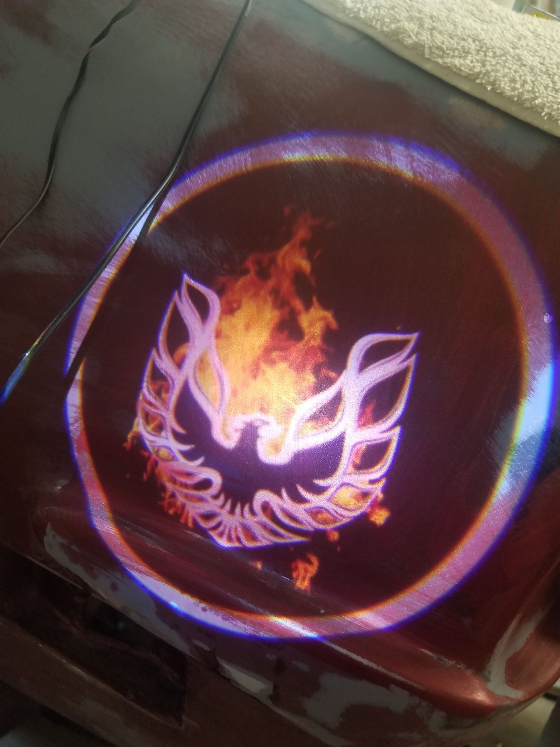

Pontiac trans am under door....under sideview mirrors projectors (wire these into the do.e.light circuit so when you open the doors they turn on and illuminate the ground unless you want to wire them in with the above switch to be able to.turn them on when you want to (if under side view mirrors or illuminating against your rear hatch glass or front or rear cwnter panels...up to you to be creative with these.
These projectors are crazy bright and crystal clear regardless how far from the floor or ground or under hood or whatever you are trying to illuminate.

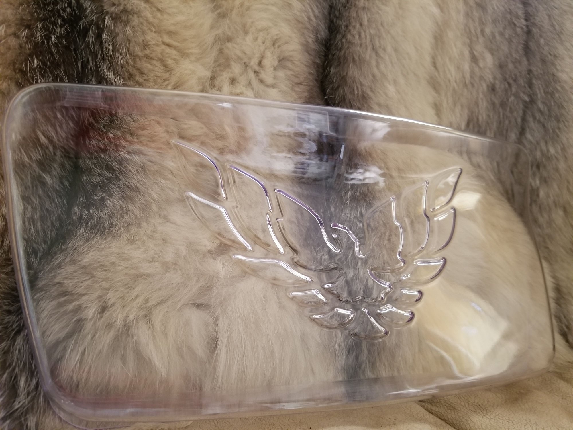

Just got my new clear front license plate cover that Ill be airbrushing soon and illuminating with a programmable LED flexible light bar so I can program it for holidays and such
For instance, 4th of July, ill program it to fade from Red to White to Blue, for Halloween Ill program it to fade from Orange to Purple and on Christmas, ill program it to fade from Green to Red to white. Things like that.
I need to buy a bird sticker to put on the inside before I scuff it up slightly and paint it white to match the car and then after the paint cures, peel the bird with an Xacto knife and keep only the raised bird clear so that's where the glowing lights will be seen the rest will be white and ill be painting it from the inside so it will look like it has 12000 coats of clear over the white paint.
Ill take photos of the project as I go from scuffing to painting to the light bar and mounting the light "brain" or programmer in the center console unless it goes on my cell phone but rather have a controller in the car.
So stay tuned for photos/vids/Animated GIF images in next week or two.

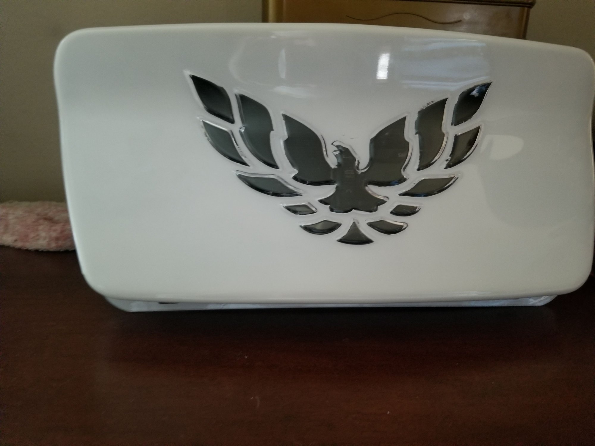

Default Finished my Illuminated or "LIT" front "Phoenix" Firebird project
I got a chance to finish my front illuminated fire bird license plate cover yesterday I think it came out fantastic....
last night being new years eve I did not want to take even the slightest chance with getting pulled over so i kept it powered off but now I will set it to drive with it glowing white and with the hand held remote can scroll through the various light programs and it brings the front of the car to life and gives it a million dollar statement. I plan on doing the door panels next and I will probabl y start making full kits to sell.
kits will include all the necessary wiring and wiring connectors..
full detailed instructions with detailed hi res photos for ease of installation...
fully cbc cut lexan door panels with choice of decals. (Pontiac emblem..."Trans Am or Pontiac" lettering or the Phoenix fire bird decals)
1 hand held remote to make all 3 light kits work in sync (remote is IR so no line of sight needed...will work from 50 feet away and can tuck the lighting control module up under the fuse box on drivers side under the hood)
kit will include the clear front license plate cover
computer cut decal to use as paint mask
To produce the best results possible so after.painting the inside surface of the cover...peel the decal with an x-acto knife and then bolt onto the car after installing the light kit
if anyone has any interest in this setup...IM me here and that way I can get an honest opinion of the product...difficulty level of install...and hyper accurate detailed instructions review etc.
ill try to upload a few videos to show the frint bird.
Jenni
Clear front license plate cover airbrushed from behind so bird is able to be illuminated wi th programmable LED sequential lighting set with hand held remote
