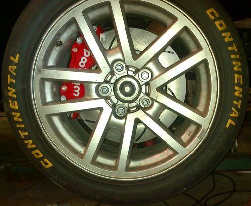

First, if you're looking at HPDE, you would be surprised how far an aggressive pad on the stock LS1 brakes will carry you. I'm running R-comps and my tires are the limitation on my brakes. My track pad mix is a Hawk DTC-60 on the front and HP+ on the rear.
As for tires, it's been easier to find scrubs to fit the 18" x 10.5" wheels. I started by buying a staggered setup of OEM C5 Z06 speedlines. I prefer a square setup, however the staggered set still feels good to me as long as I adjust the other factors properly to account for the car being more prone to understeer. I don't have any problem with fitment of the staggered setup as I'm still running the LS1 brakes (as noted above).
As for the brakes, I will eventually upgrade to either the C6 kit or the CTS-V Brembos. I'm leaning towards the Brembos and if I went that direction, I'd just pick up another pair of the 18 x 10.5" Speedlines. Plenty of these pop up for sale at the Corvette Forum, so it usually isn't too tough to buy the pair you need. Interestingly enough, there's still a market that exists for the 17 x 9 C5 Z06 front wheels, so you wouldn't have too much trouble moving those.

2nd gens have a different wheel offset than 4th gens and corvettes, so I had to use 2" spacers. With that in mind, 4th gen Corvette 17" Sawblades and 4th gen Camaro SS 17" wheels fit fine. It looks tight in this pic, but there is actually about 3/8" space between the rotor and the wheel. Because of the wheel design, 4th gen guys would have to stick with the base corvette rotor size. And yes, I agree the CTSV front calipers would be much better than stock. There is no benefit with going to bigger calipers in back. I have stock 4th gen LS1 brakes on my back axle.
