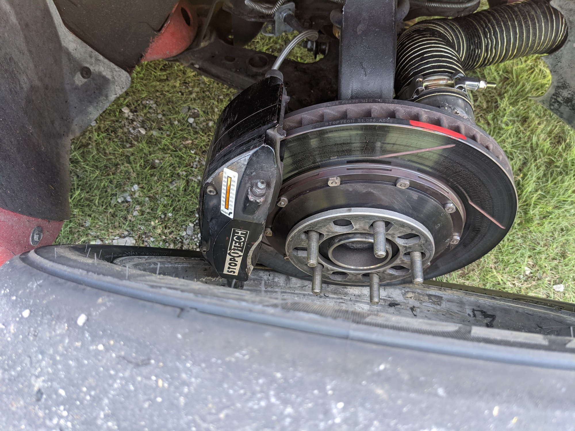

The calipers (outside) aren't getting hot at all, not even 400 degrees, but the rotor paint turned beige so they're getting around 1500 degrees. Seems a bit toasty. Pads were rock solid the whole time though. May have found my new fave if they last, and they were looking like they will. As for the weekend? I got 2nd in R1, R2 was an invert and I think I only finished in front of 2 people, R3 I got 2nd, and that qual'd me for 2nd in R4. I managed to hold onto 2nd even with a wasted 4th gear synchro. Every single 2 second 3-4 upshift was met with a grind and a decent chunk of downshifts out of 4th were as well. A couple were abandoned entirely which made for terrible T1 mid corner/exit speeds and some butt clinching entries into T2 with P3 scraping the paint off my bumper. I managed to hang on and eventually turn it up right at the end and get a little buffer between me and him. My fastest laps of the final were the last 3 as I slowly began to trust the car would make the whole session. Now if only I could knock out my next race weekend without trying to burn it to the ground of destroying something of significance. . .

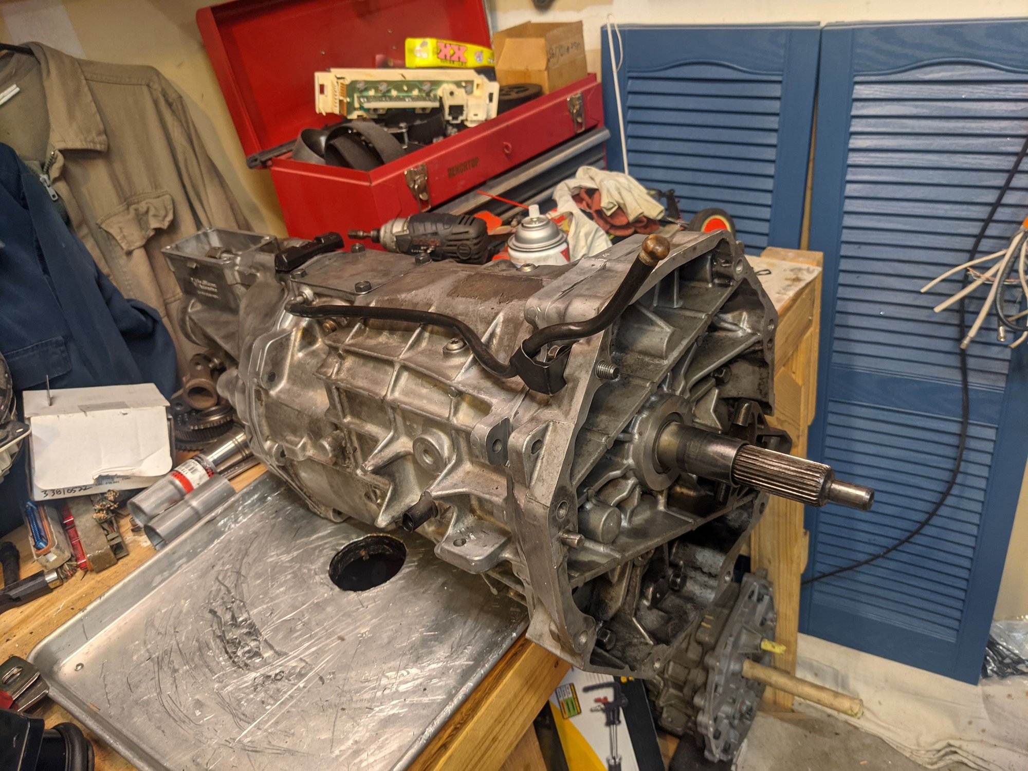

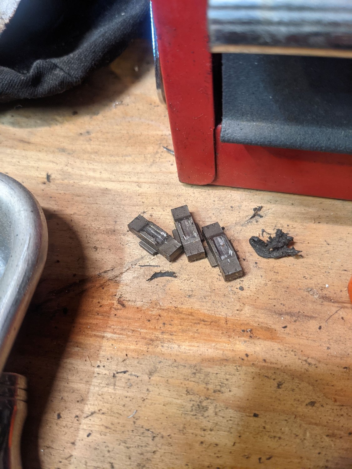

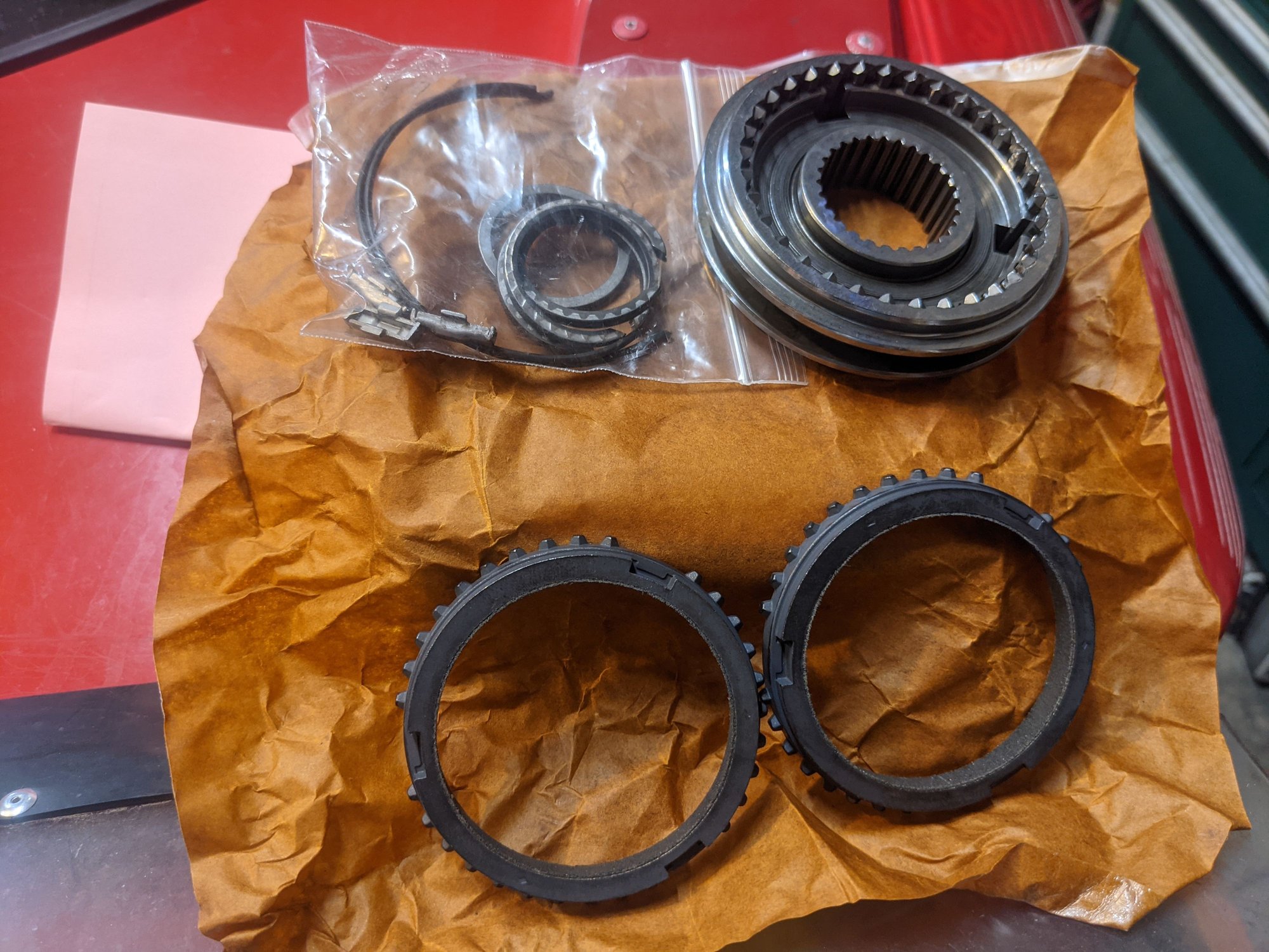

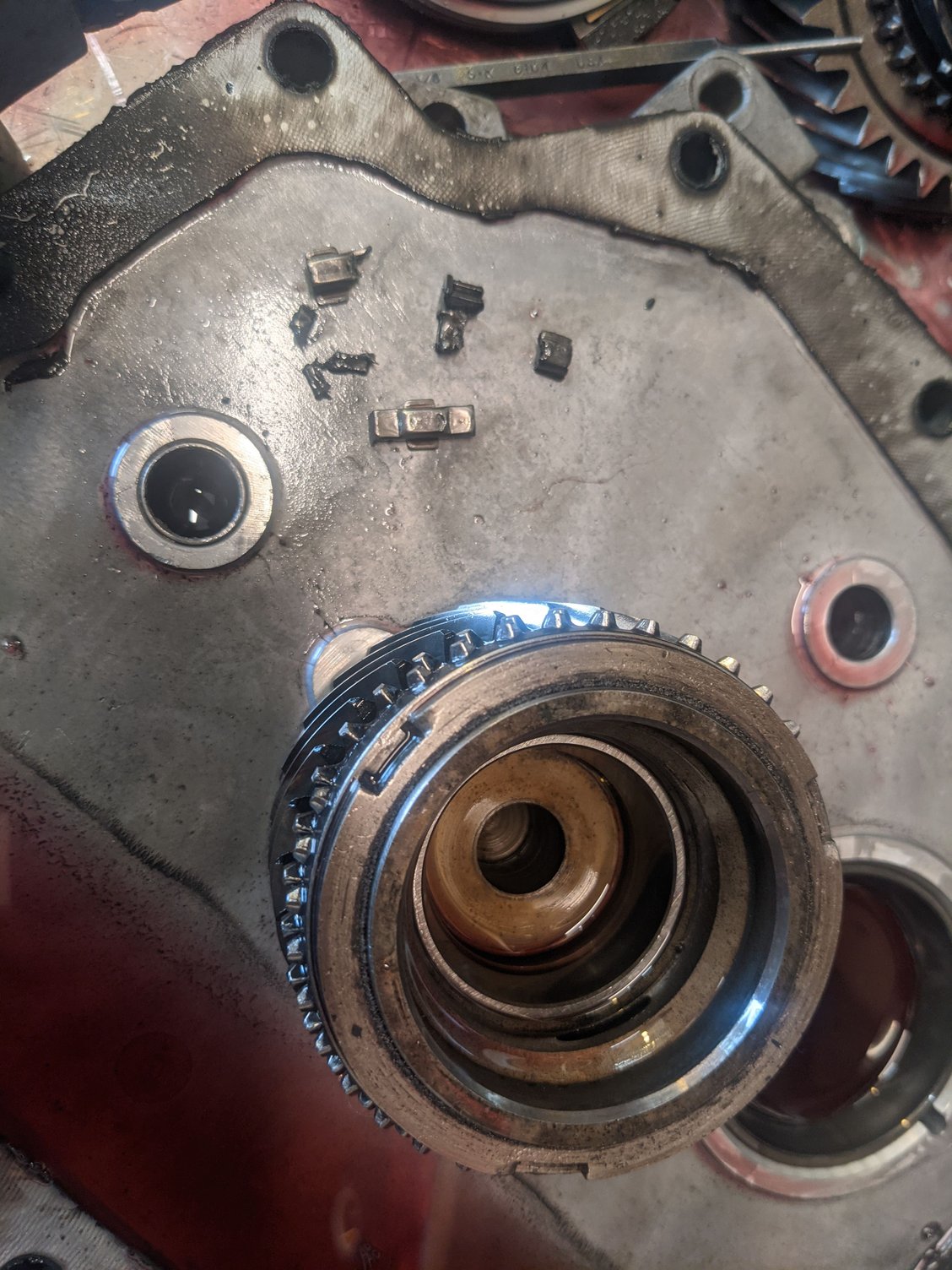

Last night I removed and disassembled the transmission. After some research today, it seems the keys were the root cause and not damaged by something else.
Not surprisingly it took the blocker ring with it. The hub and input shaft were spared though, so I'll take that! I put these stockers back in over the winter because the billet ones got chewed up.
But seeing how their failure mode is not one of explosion, I'll be going back to them. I have some for 5/6 and R that I was too lazy to install during the 2020 rebuild, so I'll be putting them into 3/4 and 5/6 before this goes back into the car. On the interwebz, Syncro stuff is all backordered. But this place up in Denver had everything in stock that I think I need, so I swung up there today. I really only needed a blocker ring for 4th, but I grabbed 2, a reverse hub, and a few snap rings.
I'd wanted to do the reverse hub when I had it apart to reseal, but was cheap/lazy and slapped it all back together. This should make me whole again, planning to reassemble and reinstall Monday. I'll be at the track this weekend directing and hanging out with no car. Gonna be a bummer with no car, but I don't want to rush its reassembly. I also intend to have the cool suit cooler built for my next event. I've about had it with sweating my *** off.

Your shift linkage and shifter tight, good throw on your clutch so not to ride on the syncros.
I had to drain trans oil full of metal bits at the track, with loud tink tink tink noise of gear teeth hitting the bottom of a steel barrel as spectators walked past.

Only thing I screwed up on the trans was running those stock keys, they're garbage.

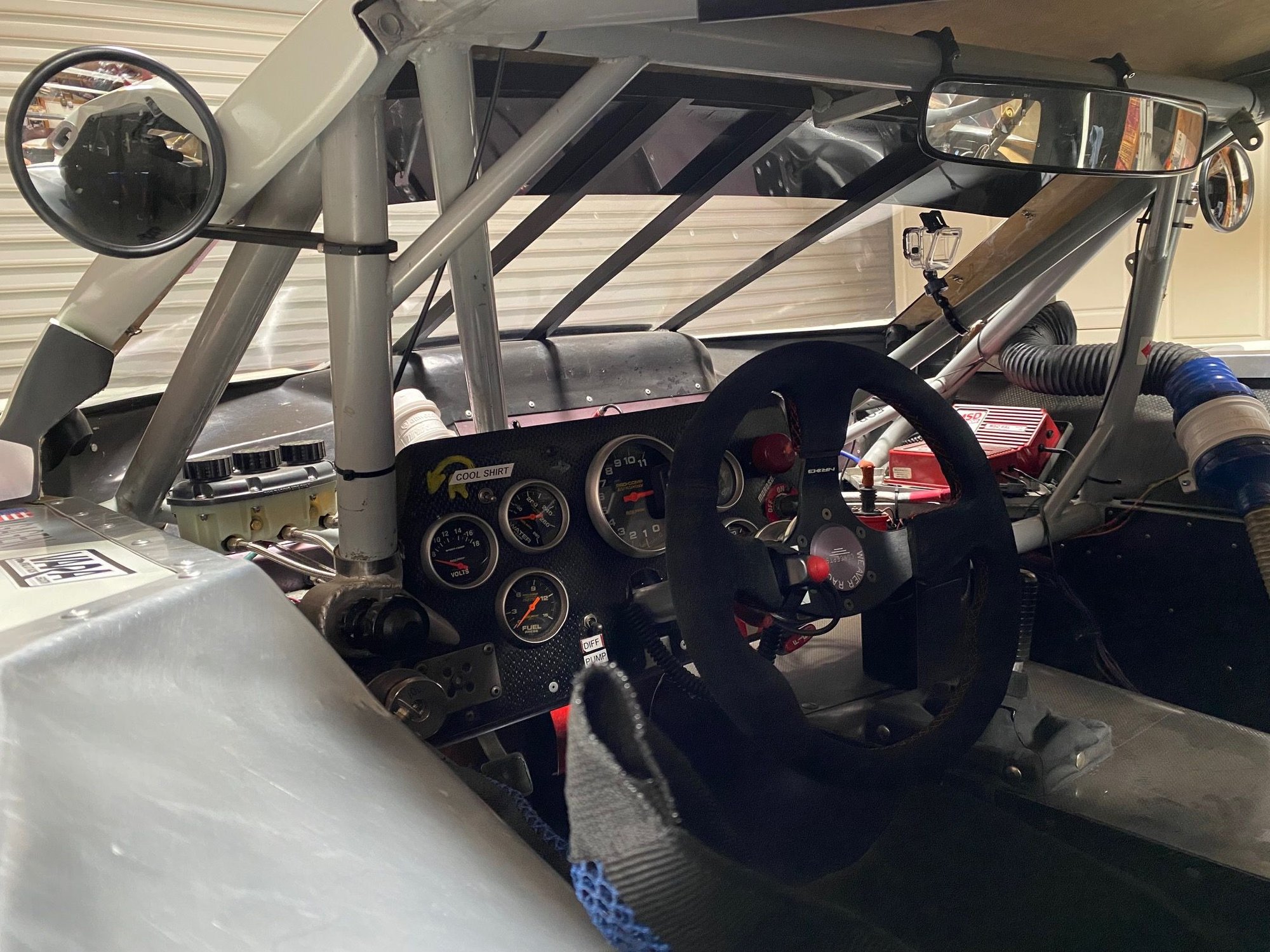

I wish to God I had the space for the helmet blower but it seems I have no helmet clearance anywhere for it sadly. After rocking the same hot, thick, cheap, bloated suit since 2013, I finally pulled the trigger on a new one that's a fraction as thick. I got the black and red version.

​​​​​​Looks like I'll be securing that ducting and repeating the rotor paint experiment at the next event. Speaking of the next event, I have about a year's worth of pent up *** whippings to dole out. Keith I know you're reading and if you're man enough to get your car together you better know what's headed your way!

On the brake duct I had luck with two little holes 180 degrees apart drilled in the Red flange.
Then attach hose and run a tie wrap thru the holes and around half of the hose.
I did that on the brake cooling plenum too. (tough to do as you can't see in the brake flange)
It's tough to have a solid capture with the hose clamp on the fiberglass or plastic flange.
My helmet has the blower attached to the side as I do not have any clearance above the helmet.

I got the cheaper hose this time so it doesn't hold itself in position as well as the other stuff, lesson learned there. I think I'll try to zip tie it to the edge of the bumper beam. If that doesn't work, maybe I'll just rivet it to the duct similar to the way you zip tied yours.
My seat has those head saving dealies on either side, so a side duct wouldn't work for the helmet either. Who knows, once I get a few more things sorted maybe I'll decide to spring for a new seat to enable that.

I guess I've been assuming the vent won't fit. I'll have to sit in there and have a really good look. It's nice to be focusing now on stuff like this as opposed to fixing mechanical shortfalls of the car. I've also long wanted to augment the factory mirrors with something that clamps to the cage too.

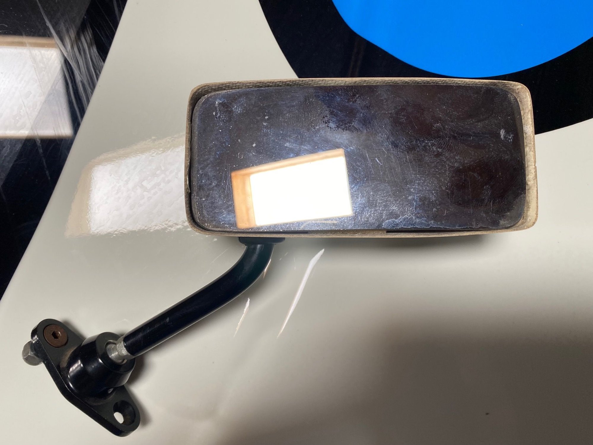

Right driver equipment, drink bottles are next?

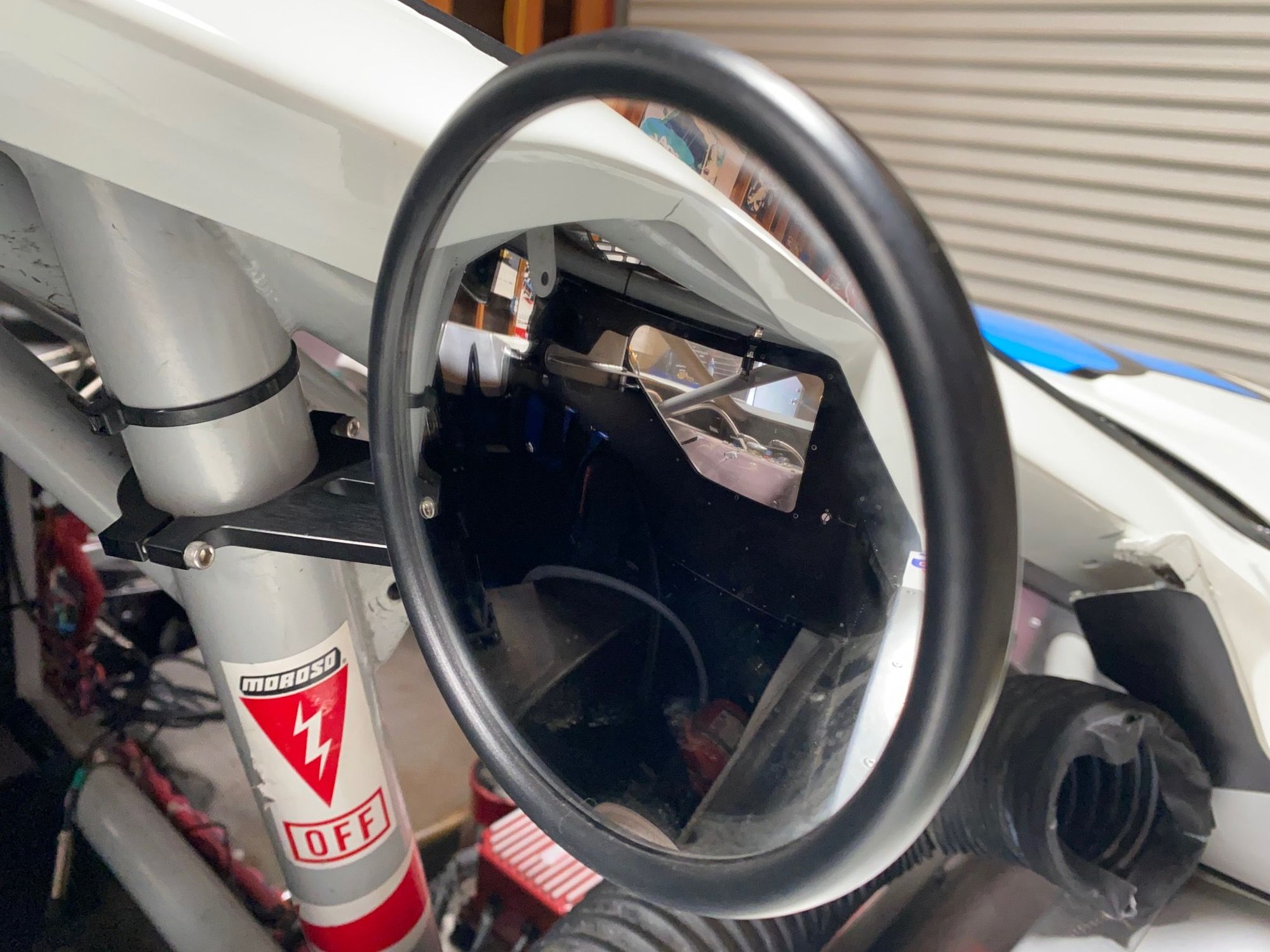

Replaced the rectangular side mirror with big 5" round side mirrors.
Huge improvement, best $50 I spent on the car.
Mounted high and forward easy to see from the corner of your eye.
These billet brackets are slotted 3" to 6".
Depending on where your bar is, if I had a longer bracket could try it with mirror mounted a little more forward.

Time will tell if they stay red. I also got the transmission buttoned up.
What a nightmare. It's not a difficult thing to assemble, but it sure kicked my *** this time. I installed new blocker rings in 3rd and 4th, input shaft and 3rd gear were unphased. The hub showed some wear, but not as much as the one I tossed when I rebuilt it in 2020 so it stayed. I also replaced the worn reverse syncro hub and now 1-6 all have billet keys. I found broken key springs in 3-4 and 5-6, so changed those out as well. Hopefully it's all good and doesn't leak, but it probably will.

Oh sure get the fancy Longacre mirrors.
For several reasons (rear wing, rear firewall/plastic window, Hatch plastic window, roll bars) on my 4th gen rear visibility is difficult so I went with the 5 inch school bus size mirrors.

About the same price but a bigger mirror and a longer mount.
I saw these on other race cars so no shame having bigger side mirrors.
I got the mirrors from Amazon but can't remember where I got the mounts, found these at wine country.
So $50 a side.
Ok the $16 each for the 5 inch mirror from Amazon.
Amazon Amazon
Longer mounts for $58.
