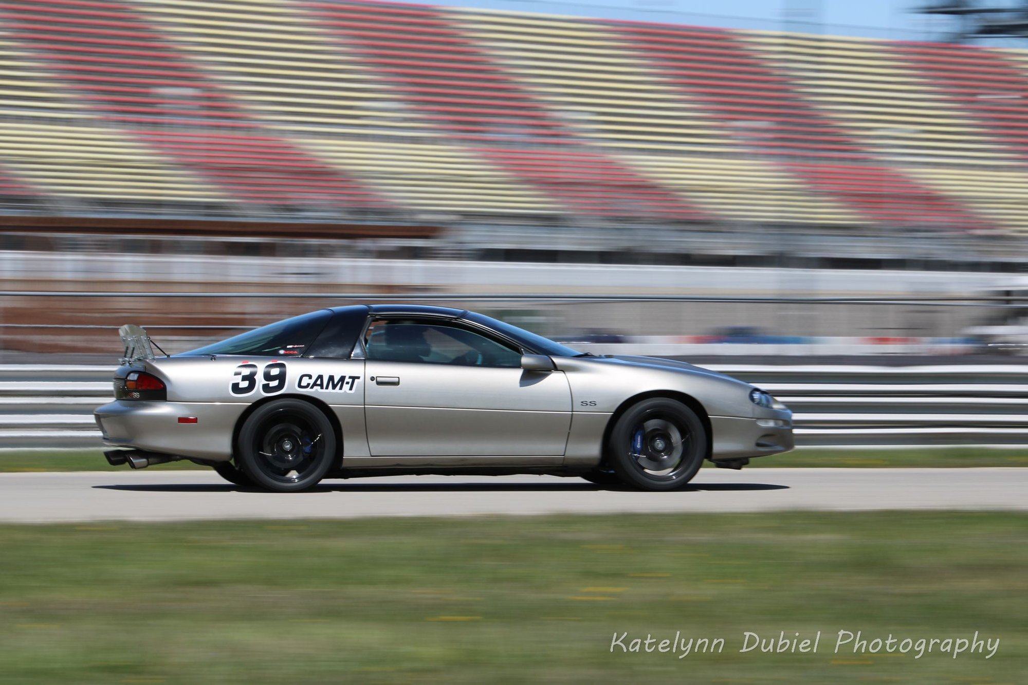

I will share my experience. I have had my car for 20 yrs now, ugh. It wasn't set up for AutoX and I ran some and it was sort of fun, but not competitive. My neighbor bought a C5 FRC and I made it my mission to beat his car. I was a good 2 sec behind as my starting point. Now I have spent a "bit" of money and a lot of time dialing the car in. It still weighs 3400#. I consistently run faster than his car and my car has done pretty well overall. The last AutoX with 162 cars I finished 5th raw time... many Vettes and one C5 Z06 finished ahead of me by 0.2 sec. There were C5/C6/C7/C8 vettes there.
My point, C5 are incredibly competent AutoX cars and a great way to go fast cheaper. If you want to be different and put the time and money into it, an F-body can really scoot. A 6th gen camaro, even as a 4cyl, is a killer AutoX car as well and easier to drive fast as a novice.

I do not know how nuts you plan to go or if you want to try to optimize the car for AutoX. I'll just give you my input if you want it or not about pad selection. Rear wheel hop is a real problem in these cars when you start getting AutoX tires on them. You can make it better with all the suspension parts, but ultimately you will end up reducing brake bias to the rear, one way to do that is with pads. My car has Carbotech front pads, and ACDelco ceramic in the rear, even HPS would cause wheel hop. HPS are a good street pad, but are not that aggressive, if you really want it to stop (and dust terribly and sound like a dump truck) you want something more aggressive, HP+ even. If my pads ever wear out, I would buy G-LOC.
FWIW I drove an AutoX today. I ran exactly with a Camaro SS 1LE properly prepped with a good driver (.003 sec) and about .05 ahead of a C5 Z06 also well prepped with a good driver. I have a lot of money into my car... tires alone are $1500.
