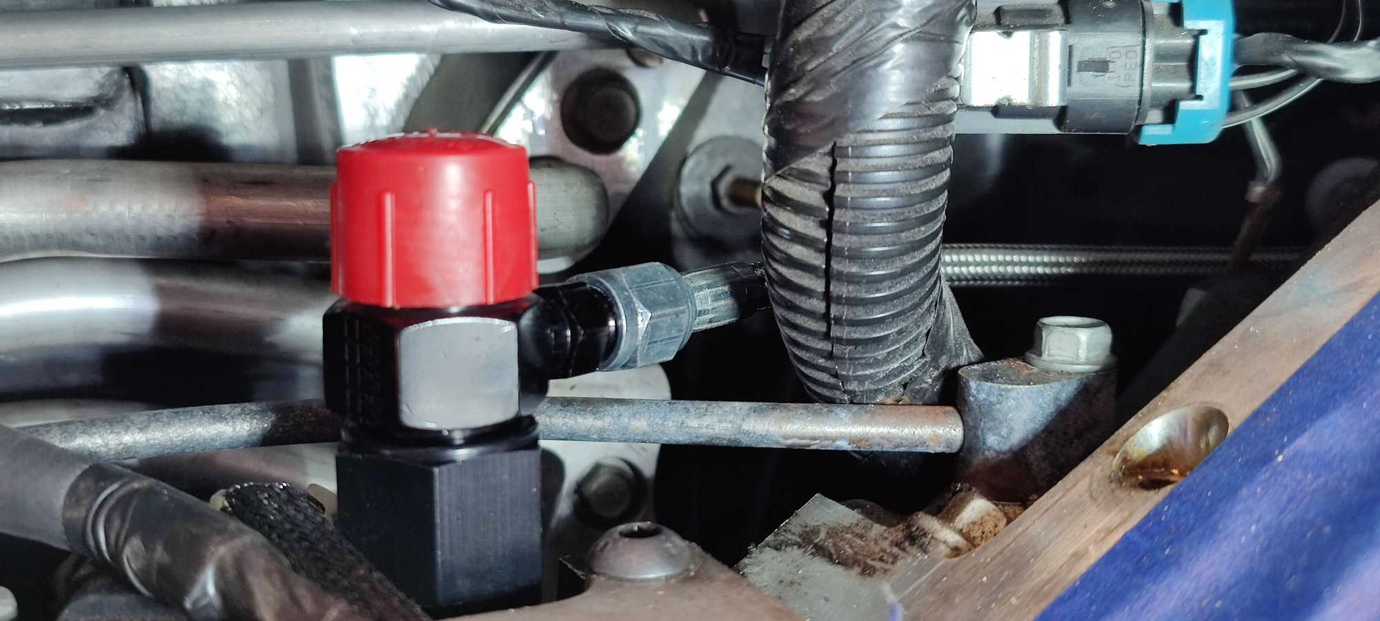

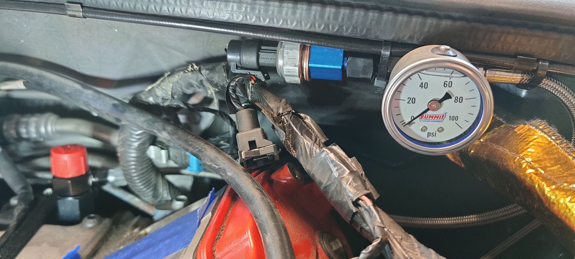

On my C5 I ran it to the pressure sensor behind the intake, and remote mounted the sensor. Will that fit in a 4th gen Camaro?

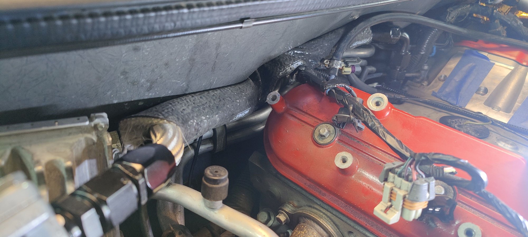

Thanks, I don't think so, Its a very tight fit back there on the Fbody

LS or LT? I'm running a oil cooler sandwich on the side of my LS pan for a 94 Formula, with lines running into/out of the front. I've put a T into the return line with a one-way valve in front of it to insure the Accusump only pressurizes the block and not towards the cooler. Yes it's tight under there but you can get creative.
