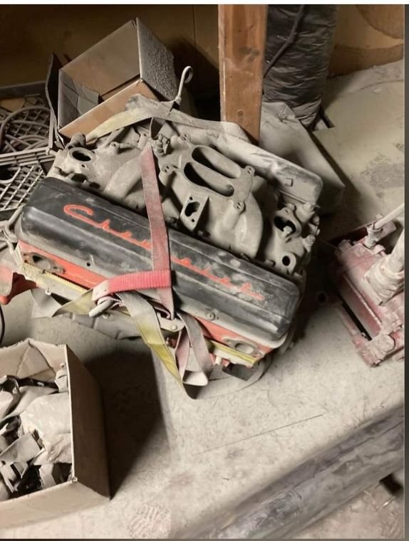

I have a 64 1/2 327. I'm looking to pull this from a K10 i own and go thru it. The truck came with a cam the po was going to install but didn't. its a Elgin E-916 P .453/.453 lift 284adv. 230/230 76overlap 112/116 center line, looking to run this with a set of 906 GM Vortec heads with LS spring mod and intake. I plan to run this in a Camaro I'm still looking for the right one. any tips on this cam vs buying one that's better suited?

Bump.. picking up a 283 today. its gonna be good..
