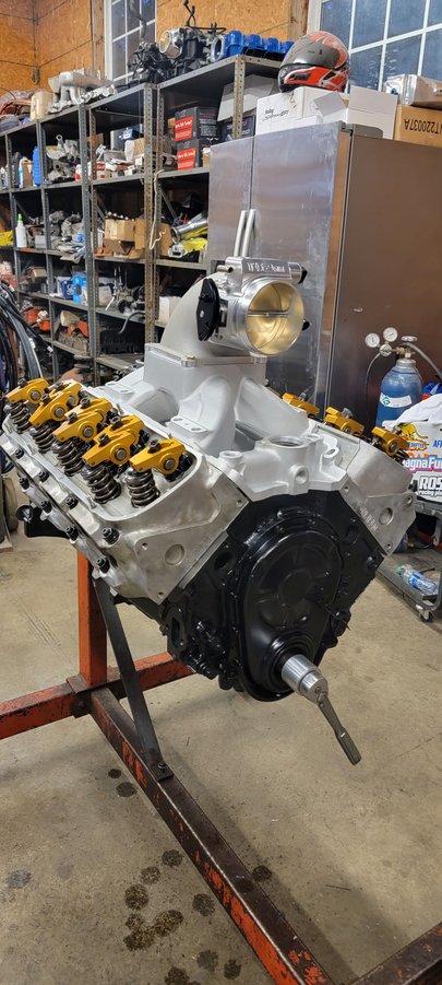

Old Mar 23, 2022 | 10:43 AM
Tss4.8's Avatar
Joined: Jan 2017
Posts: 8

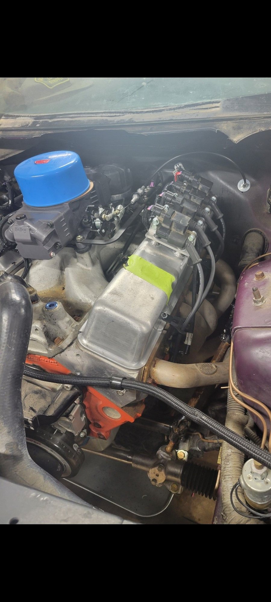

Correct, the dual sync provides your cam and crank signal. You just wire that into the Holley and set up your ignition parameters like shown in that link from the Holley tech forums and you'll be good to go. Since the harness I have is a universal throttle body type it had the ignition connector already wired in so the dual sync was plug and play but you could make your own connector or get the corresponding one for the Dual Sync, pin it and run the wires to the correct pins in the ECM. I can look at my notes if you'd like exact pin numbers and such. It's not a great picture and my car is absolutely disgusting but here's a look how I have the coils in my 95.
