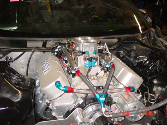

here's a 10.2" deck 572 with a two stage dry fogger. MadMan did the headers for us.
More pics please
the suspense is killin me!

You still need a distributor with a crank trigger. If you don't want to run a conventional distributor you need to use a front mount like this:
That was a 401" sbc that was in the firebird when I bought it. All I have left is the headers, complete efi/nitrous intake and converter.
The firebird is at Thunder Racing getting MadMan's magic done to the suspension, then it will be headed back for the power new powerplant (and major re-wiring job!)
The new motor should be here when the car is done at Thunder
The 572 Camaro has already been through a divorce and has since been parted out.

Hey Brady, are you guys re-using a stock rack, or what advice to you have?

My advice it to use the MadMan/Thunder Racing rack. That's what we use in all our stuff.
Yeah, it's a shame about the 572 car. We've got a video of it floating around here somewhere.. I think XXX has it, but it's like 85 megs and he doesn't posess the intellect to re-size it..
