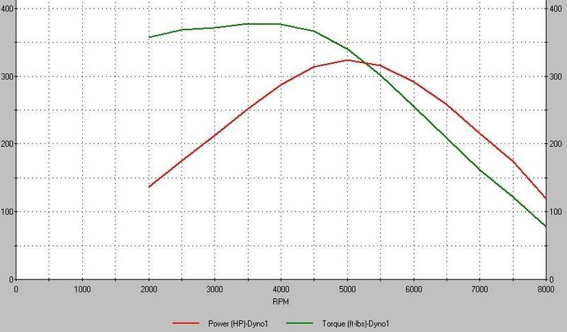

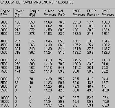

hey guys im building a mild 350 that im putting into an 86 mazda rx7 its an extremely budget build considering im still in school but was wondering for those that have desktop dyno could try a combo for me
350 block bored 30 over
sealed power cam 288 298 duration 214 and 224 at .050
.442 .465 lift ground on a 112 lsa
ive got a weiand dual plane intake manifold idle-6000 rpm
edelbrach 600 carb (1406)
heads are stock off an l98 flow numbers aren't too impressive 199 cfm intake
about 120-130 exhaust (these will cork it i know) around 165cc intake ports
the heads are 64 cc chambers we are looking at about 9.5:1 compression with the speed-pro flattop pistons with valve relieves
i am expecting to make about 275 horse or so hopefully

mine showed 270 at 5-5500 rpms

thanks i appreciate it, about what i was expecting how did the torque curve look?
