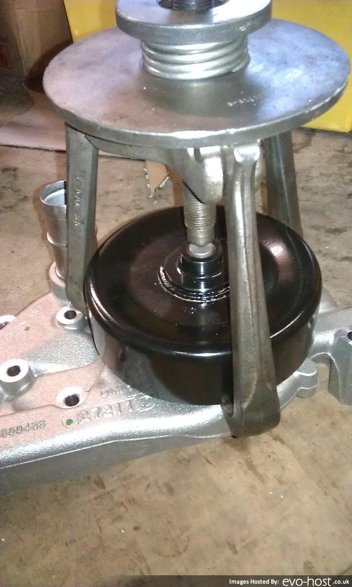

no problem. I just got my ls2 pump in today as a matter of fact.....what is the preferred method of pushing that pulley back 11/32nd's?

I get the pumps complete for just under $200 shipped and have been selling them as part of the bracket sale for $200. I don't make anything off it and am actually losing money by the time I've pulled the pulley, and have been considering raising the price a little on them.
You can use a large 3 jaw pulley puller to do the job yourself, but you just have to take it slow and reposition the jaws from time to time to try and keep from warping the pulley much. Just make sure you don't pull the pulley too far forward.
There is another option that will save you from having to pull the pulley though it will be more expensive. I have been told someone makes spacers that will being the pump in line with the main drive, you just need to also get a corvette tensioner to mount to the pump. I have not yet looked into how much this costs though. I think they said it was Wegner that makes them.

oh ok. it needs to be PULLED out (not pressed in) 11/32nd's. I totally read that wrong then. Now i just need to wait till next month and get my fuel system and 3.4 pulley and find out my belt length. Got my br7ef's at .026 last nite and they are in the heads now. I laughed at how easy it was with the motor out.

Are you applying heat when pulling the pulley, or just doing it cold ?
I always pull them cold. I don't like the idea of heating them because I don't want to run the risk of the pulley softening and warping more.
I use a 2 foot long pipe between the jaws to hold it steady and provide leverage and a pipe over the socket when pulling. The hardest part is getting it to initially break loose, so I do 7 or 8 90 degree turns then loosen it up, reposition the jaws, and do it again. Repeat until it begins pulling forward. I use a micrometer to measure the depth from the pulley to the top of the shaft and try and stop close to .25" deep (for a total of about 3/8" pulled since it starts with the shaft a bit forward of the pulley).

No, not applying the heat. My torch would liquefy the pulley most likely. No, I am just putting my 3 jaw on, and finding something long enough to give me leverage, and apparently I need to find a micrometer somewhere and measure it. I certainly do not want to flex it so I will take my time. I am a pretty slow paced guy anyways when it come to these things. Took me a month to put the procharger on by itself.

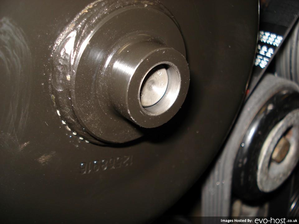

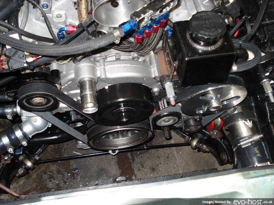

New pump arrived today via SDPC !! Superb service from them, I only ordered it on Friday morning.
It did take a bit of effort to get it moving, but wasnt that bad really. I did put some tension on it then stop and tap the top of the puller with a hammer for a bit though.
Makes a huge difference at the front though. My crank pulley is a F-Body offset.
it looks more than it is, it's only about 4.5-5mm though ( 195thou )
