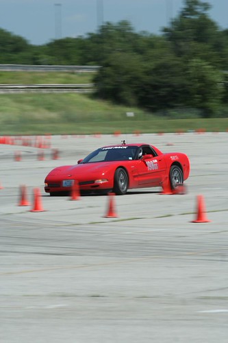

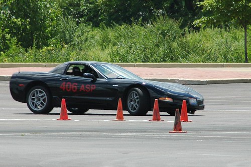

Your car has alot of body roll in the picture. Maybe you should tune your suspension.
lol... silly drag head. Typical, most with no experience think you need to have zero roll, and super stiff suspension where as that couldn't be further from the truth. I think my suspension is "in tune" for what it is considering I drove to that event pictured, made no changes what-so-ever to my car (tire pressure was even set for street driving at the low 30psi) ran with and beat some modded C5 and Z06s and drove home again with no changes. My car is a full weight street car with simple bolt ons. Koni SAs, Strano Springs, Strano swaybars, Adj PHB, SFC/STB (although these did nothing for me), Nitto NT05's, stock replacement blank rotors and Hawk HPS pads. Then headers, Y-pipe, catback - thats it.
As for body roll, check out these vettes going through a similar turn to mine:
