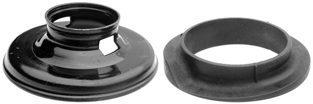

Was the metal sleeve intact on the upper mounts? The shock's shaft slides through that sleeve and there should be no play or wiggle in it. You also have the dog bone isolator piece put inside the mount?
New mount, intact:
Isolator:
Spring sits on the seat (looks like this) compressed with the spring compressor, mount goes on top and should sit on top of the shock shaft and not on the spring (if it does, spring needs compressed more), then the isolator fits down inside the mount, then the nut is fully tightened. Then the spring compressor is released (making sure the mount is aligned properly with the base so it can bolt up to the car straight).
I'm just trying to cover all the bases and verify.
I always recommend replacing the mounts. More often than not, if you don't replace the mounts (and I just get new isolators too, only $5/ea), you run into problems. Been there, done that! I too took apart the one side several times due to a banging noise and found that the metal sleeve had pulled out of the mount, so the shock shaft would freely move through the mount and then tap on the inside of the shock tower. Handling on that side also sucked due to the shock not damping the spring properly.
