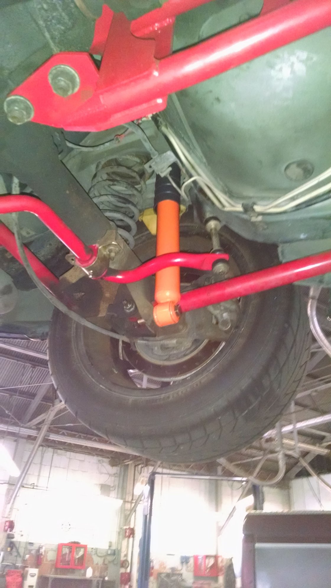

Got the rear str.t shocks installed and wow what a difference. Can't wait to tackle the fronts tomorrow with new bushings. Thanks for the advice to not use the gabarge monrore sensatrac.

From: Beaufort, sc

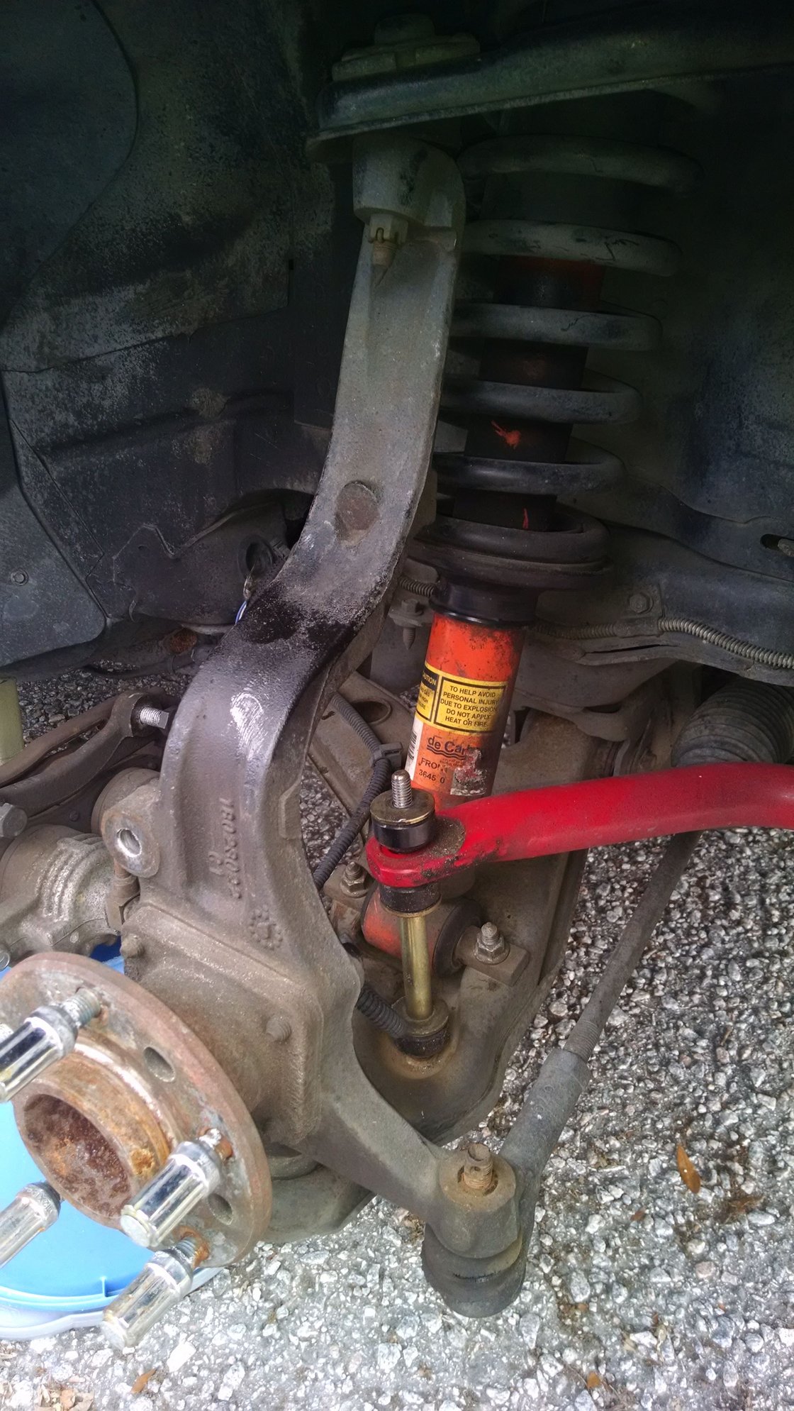

Tearing into the fronts.
