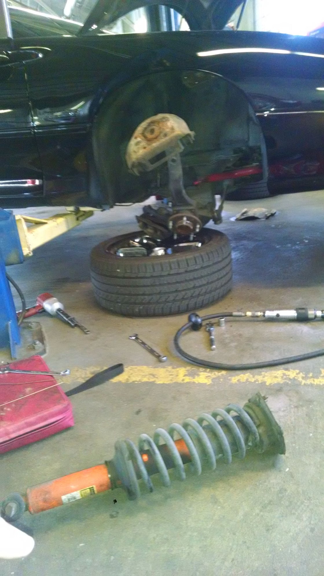

In the process of redoing my front suspension, and I need to replace a mystery part. Would also love some advice on just about anything that gave you some issues and how you solved it. I'm replacing upper and lower a arms with BMR parts. And Monroe struts and strut mounts. I can't figure out where to order the part the strut mount mates up to.

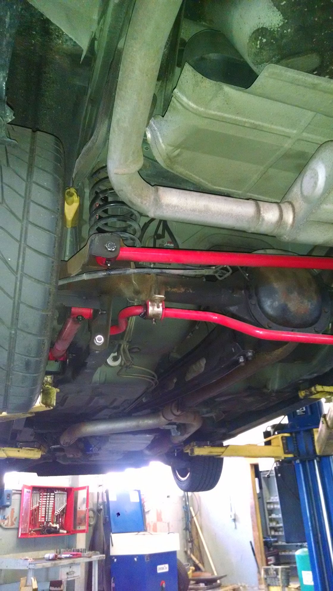

also upgrading torque arm/ cross member , and tunnel brace

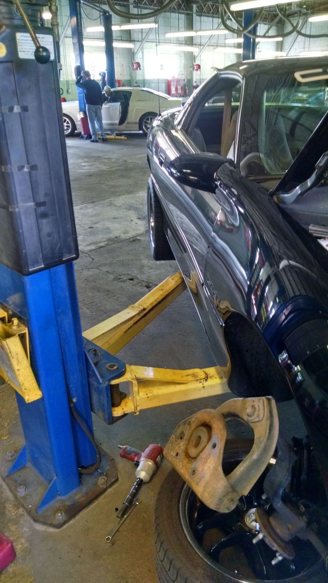

the mystery part is the rusty one above the upper a-arm

looks like you're talking about the Coil Spring Insulator

That's the thing the rusty thing the upper a-arm mounts on and the strut mount meets?

Okay so I figured it out. Its the upper shock mount. I think I'll clean it up and check if its just surface rust or if its deep. Is that just one piece their?

I am guessing you are talking about the actual mounting plate that the arm bolts to? I had someone a few weeks ago asking about one as well. I could not seem to locate one other than through the Chevy dealer, who does sell them. But, only with a new upper arm and complete setup for $330ish per side. I would find a local body/paint shop who can sandblast and paint or powdercoat it for you to be the most cost effective route. These things seem to be nearly impossible to find new

The weather has finally got better. new weekend project ive been putting off for to long.

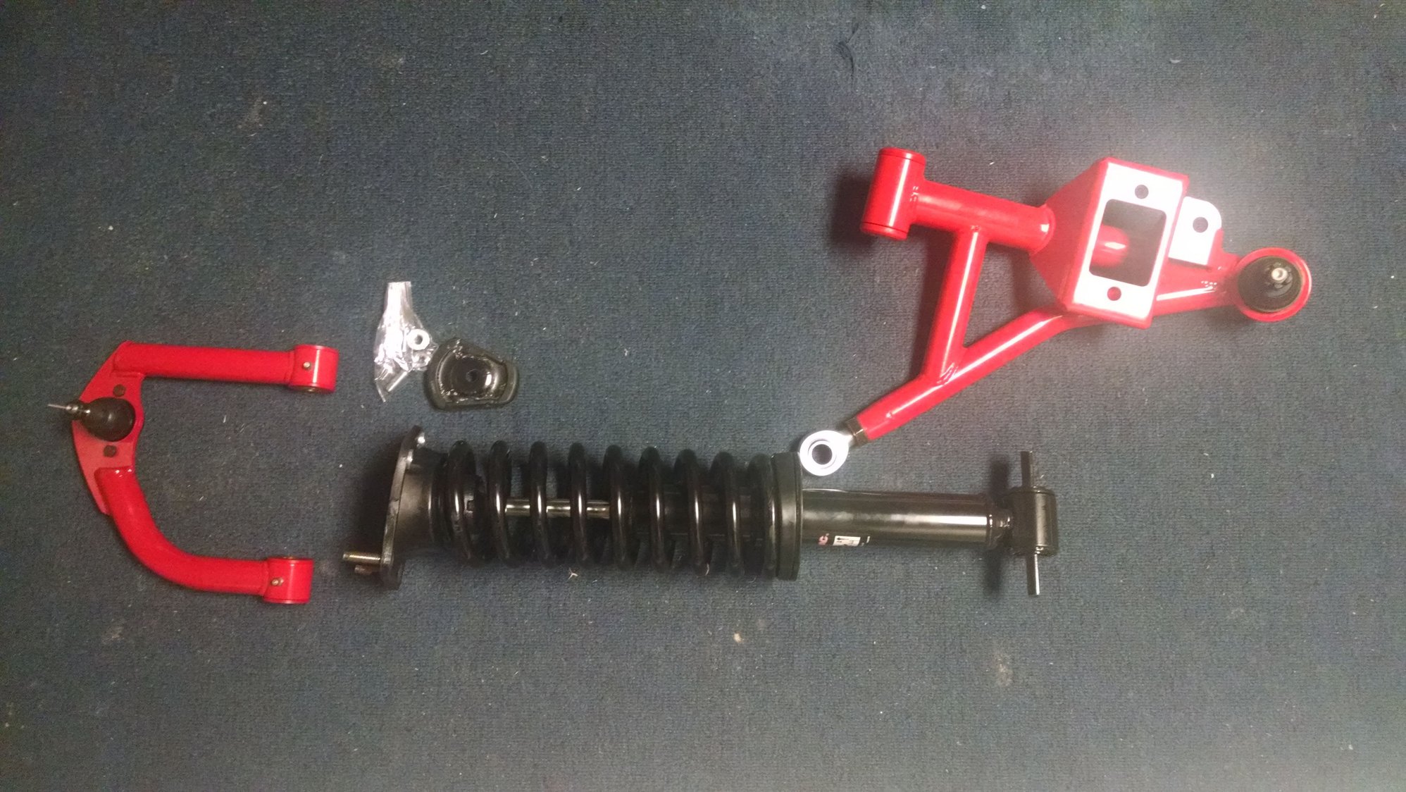

At the point of wanting to throw a wrench. Notice what's not on the shock mount in the pic? I was pretty sure that went on there.

oh and yes, I see you didn't install the insulator on the upper shock mount, definitely need that so you don't shred your upper mount.
