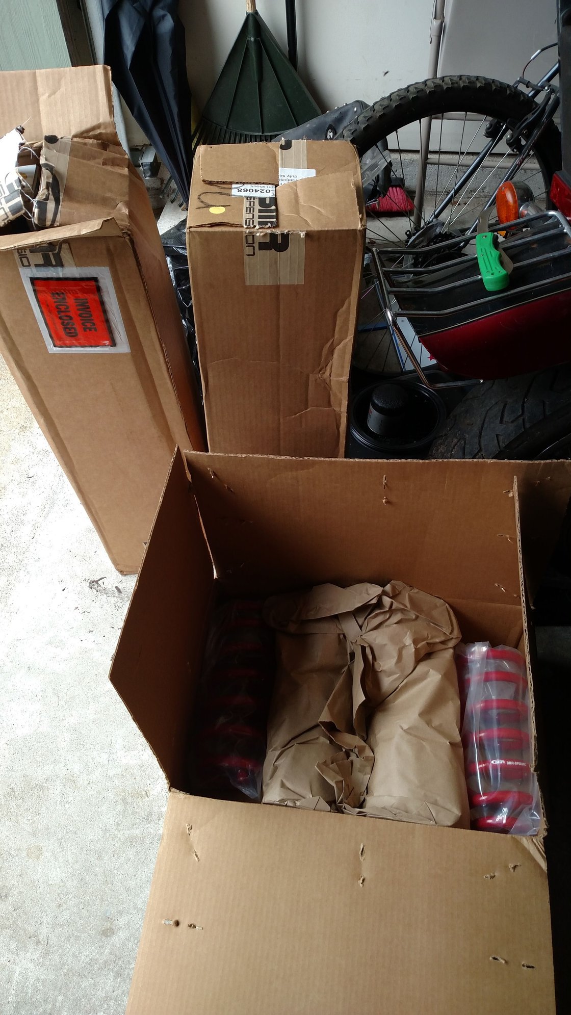

Time to get to work. Thanks for the help and fast shipping!

Woooo!! Parts!! Update us with some more pics when you're done.
