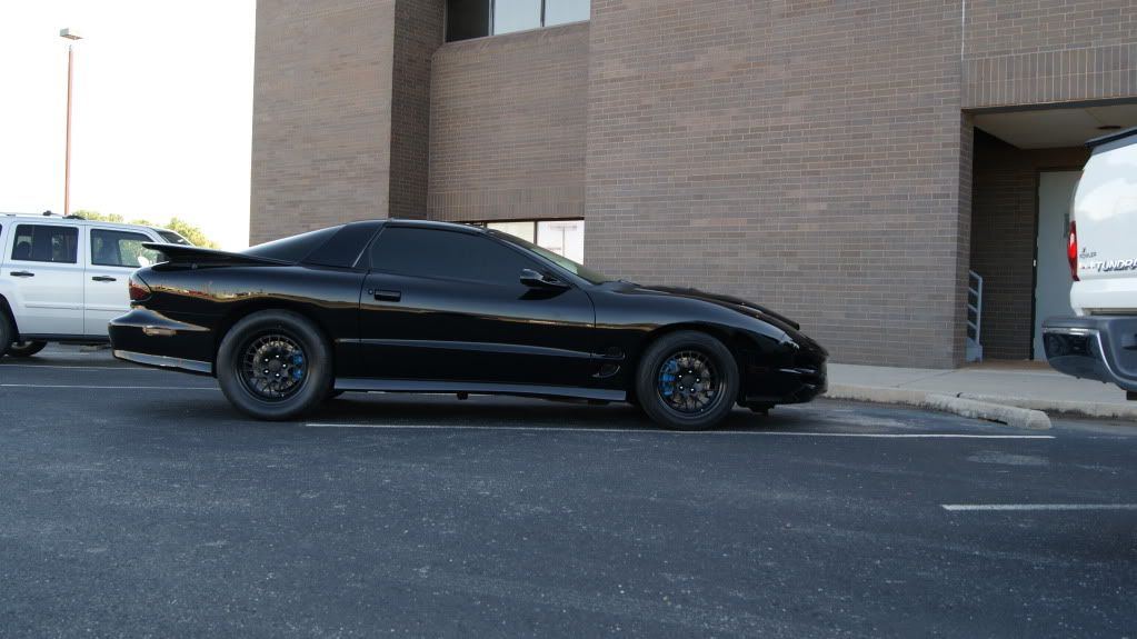

I have a 1998 TA WS6 that's been lowered 1.5" on God only knows what springs and KYB rear shocks.
I just bought the car back, and since my specialties lie in the area of making motors turn instead of messing with suspension, I thought I'd get some opinions.
I am looking for that aggressive "face down, *** up look" in an attempt to help fit more tire in the rear to help put the procharger HP to the ground.
I Already know I want to run QA1 front coil overs and either SA or DA QA1 rears. But I have no clue where to turn to for springs to accompany the rear shocks. Car is 50/50 street/strip, I don't care about ride quality and money isn't an issue.
I was considering turning back to stock springs for the rear? Anything to give me more clearance for a taller and wider rear tire with the BFH mod and fenders rolled. Here is a picture of about what I'm looking for, with maybe a little more rear tire:
Any advice is appreciated in advance! Thanks guys!

If you are going for as much rear height as possible the stock spring will give you the most, but I dont think it will aid you with weight transfer like you want. I was running qa1's sa with an eibach spring for a while, and with an 18"wheel and a 35series tire it was 26.75" from floor to bottom of the fender lip. It had a semi raked look since i dropped the front down to 26" from fender lip to floor on the same size wheel with the qa1 sa coilover.
