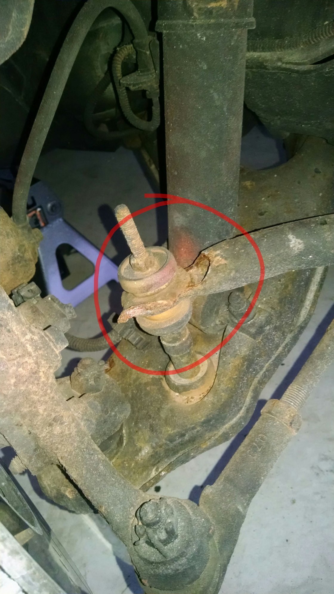

Thank you for the insight Sam I appreciate it. I am ordering your springs with the Koni shocks next week. I also just found out that my front sway bar is snapped at the end (see photo) so I might as well get a new hollow one from your site while I'm at it. I think I'm going to keep the rear one stock. The car tends to oversteer quite a bit.

If you want to do a front only that's fine, we can do that. But there are two things to consider along with that. One being that the front bar is busted and what's left of that attachment to the endlink is just flexing, meaning you don't have nearly the front bar you should have even from a stock part, which will make the car more prone to oversteer. Two being that from there we don't put a massive rear bar on like most others do anyway. I'm the original guy who ran a 22mm rear, most others are still 25mm and/or solid. I'm the only one with a thin wall 22mm rear just because I don't want too much rear bar.
Again, up to you but I designed the bars to not be really loose on purpose which is what you are after. I think what you'll find with a stock rear and my front is that the rear is a touch on the lazy side unless you run more shock to crisp it up which can compromise the feel and ride more than you might like... and it does't help the balance if the car ends up tight. You can always add a rear bar later if you try it this way (front only) and it doesn't pan out.
