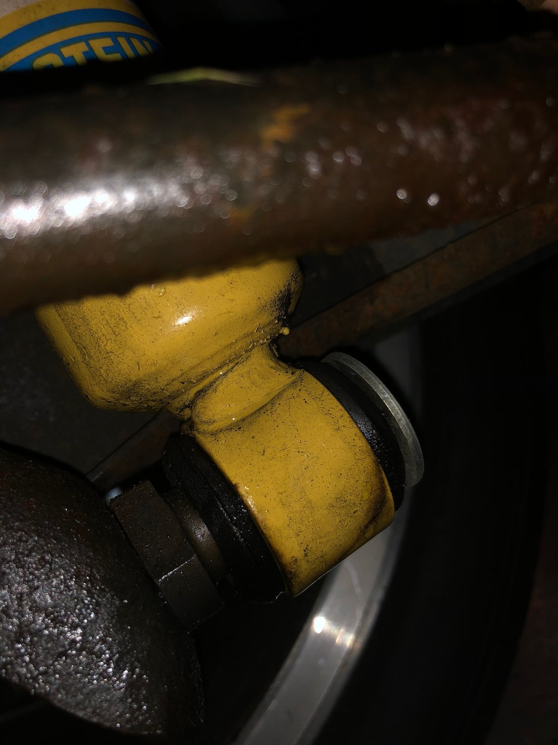

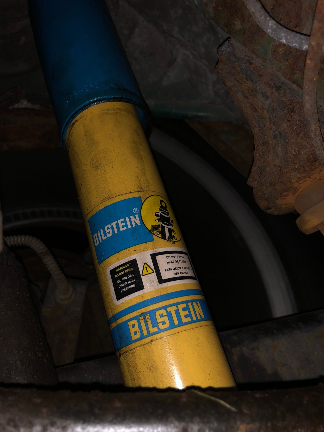

looked under my car today and saw this. It looks like this one shock is leaking. There’s no way it could be bad already I haven’t even had them on the car for a full year yet and the car isn’t driven everyday. I really don’t wanna believe it’s bad already

going to message the company tomorrow morning. There’s gotta be a warranty on them. Doesn’t even feel bad at all the car drives the same as when I got them put on. Would I be okay driving around with it like that or should it be fixed immediately?

if the oil and gas charge leak out....it just a stub that goes up n down....and makes the good shock on the other side work harder i bet.....change out as soon as ya can IMO
