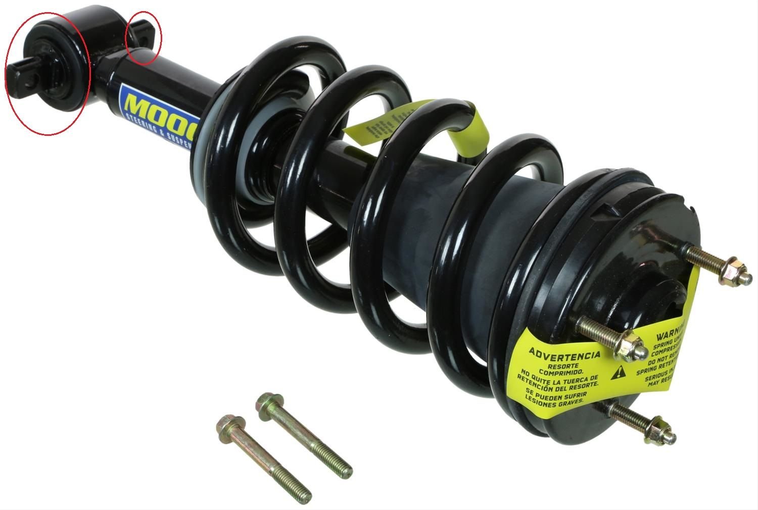

the pic below is for reference usage I was having a hard time trying to position for the 2 slotted holes on the front passenger LCA. is the area circled able to be rotated? it was position at like a 45 degree angle against the 2 slotted holes on the LCA. also the brand I got is a suncore which was from advance auto parts, not moog like the pic below
Old May 9, 2019 | 09:11 AM
99Silver6.0's Avatar
Joined: May 2002
Posts: 4,440
Likes: 93
From: Spring Hill, KS
This is the picture (borrowed from here) I was gonna use to put my stuff together. If yours are flat they will need rotated close to the same position as the old shock.

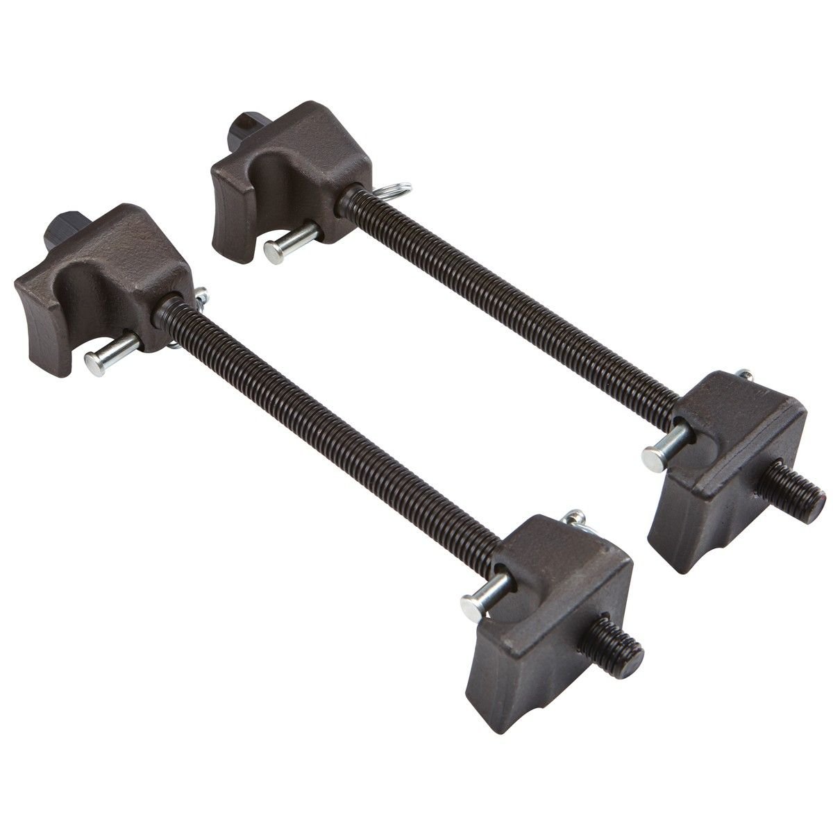

well when the description says complete strut and spring assembly is "plug and play", its not always that. the OSC I bought from rockauto afte ri returned the suncore brand to advance auto parts also had the same issue with the 2 lower holes for the LCA at an off angle. I went to advance auto parts for the strut/spring compressor loaner tool but all they carried were this:
^ how would this fit in a coilover/strut setup?
so I went to autozone of all places and they actually had the loaner tool I was more accustomed to:
so I had to compress the spring and loosen the top mount bolt and rotate the coilver/strut so it was aligned to how the OEM was. basically some of these complete coilover/strut assembly were positioned reversed when they were assembled.
