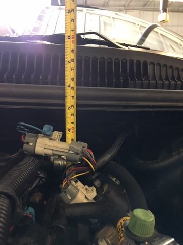

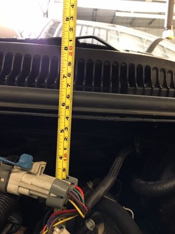

Spohn's.
Stock pedestals with UMI solids.
Spohn's.
UMI's.

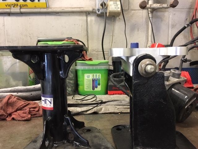

Comparison of the height difference on a bench.I didn't take a picture of the other mounts but I believe the difference was even more.
Not exactly the most scientific test but the pictures make it pretty clear. I never noticed how much it raised the engine until I worked on a stock Trans Am and I could immediately tell the engine was further from the cowl.
Again; not bashing Spohn at all, I have quite a few of their parts on my car, in fact the pictures of the mounts installed on their site are of my car. I'm just not sure why they insist on telling people they don't raise the engine when they clearly do. I don't run either of these mounts now, I should measure to see if the Hooker's changed anything.

oh....you have the spohn solids....i have the spohns that use the stock clamshells.....the pic shows a little....looks to me to be about 1/8 inch comparing the pedastals together.....but more installed......strange
my kooks headers and Y fit great with my setup........the TSP headers and Y fit like crap with negative clearance
Ooooh hahaha, well that makes sense then. My exhaust was built before I got the Spohn's so it wasn't always that close to the floorboard. Like I mentioned before I believe the other side mount had even more of a difference in height which is why it's so noticeable in the car. TSP headers are nice for the money but there really is no comparison to the more expensive headers. I installed a set of 1-7/8 ARH's and the quality is top notch. You definitely get what you pay for.
