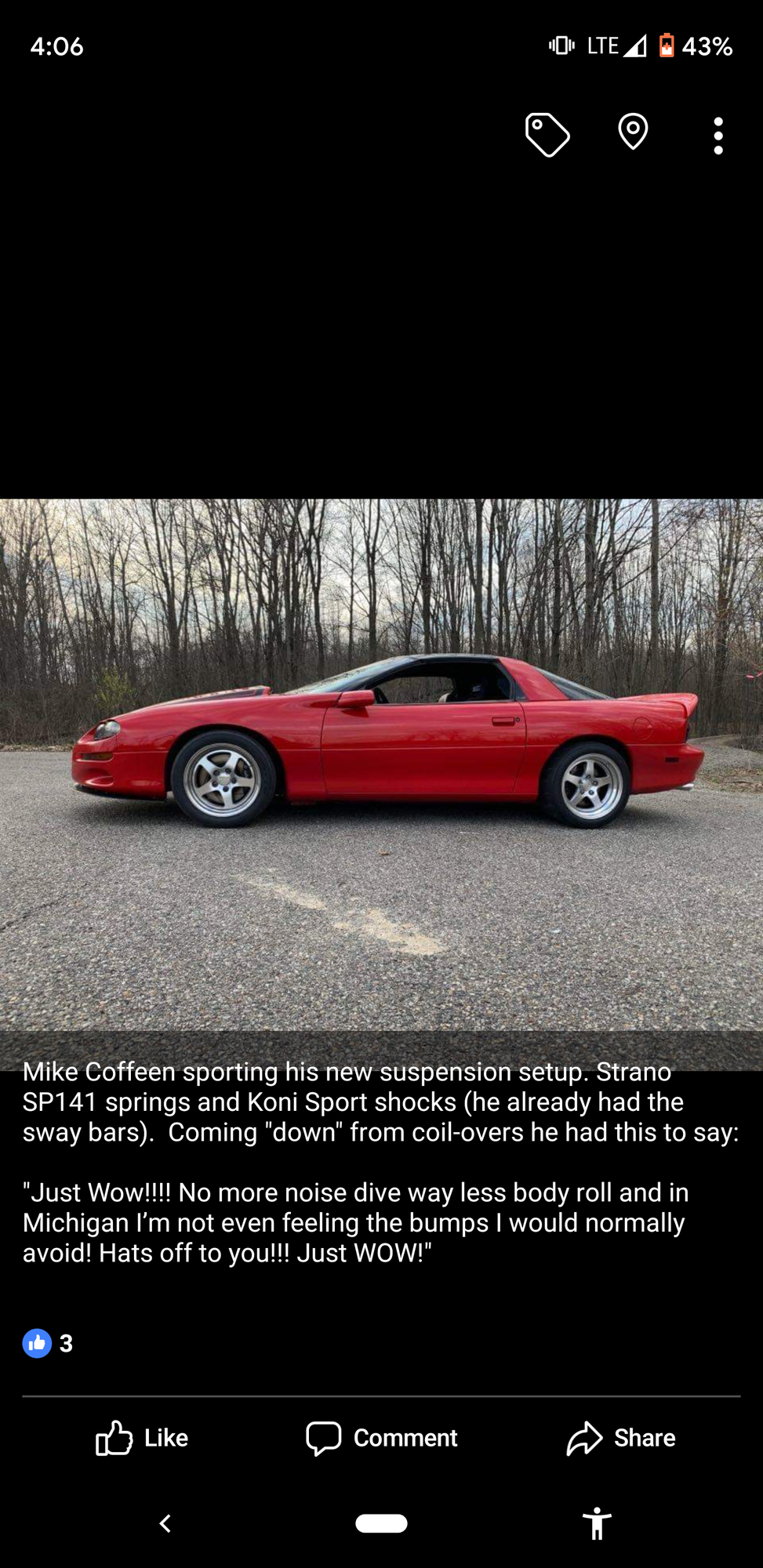

He came off of coilovers. Double adjustables in fact. Ironically off of spring rates that are supposed to be handling rates. And if it was as simple as what people think it is that would be one thing. But it's clearly not because the rates he had are actually the same rates that my springs are that he just put on.
I think he's going to add some more commentary although I'm not sure where it might be on some of the various Facebook pages, maybe he'll chime in here I don't even know if he's a member here.

A lot of times people want coilovers because they think it's magic setup but the main thing is just dialing in the exact ride height. Strano springs and Koni yellows is STILL the best setup for these cars for general performance. That's pretty much what I have and I run down faster cars on the track all the time and people are always surprised my old f body can pass their Vette, Boss, Gt350, etc and it's not radically modified. And still has great street manners.
