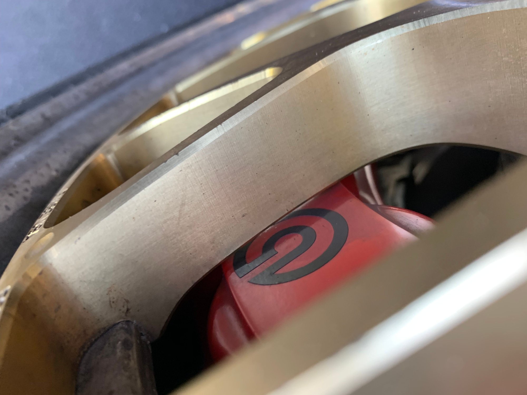

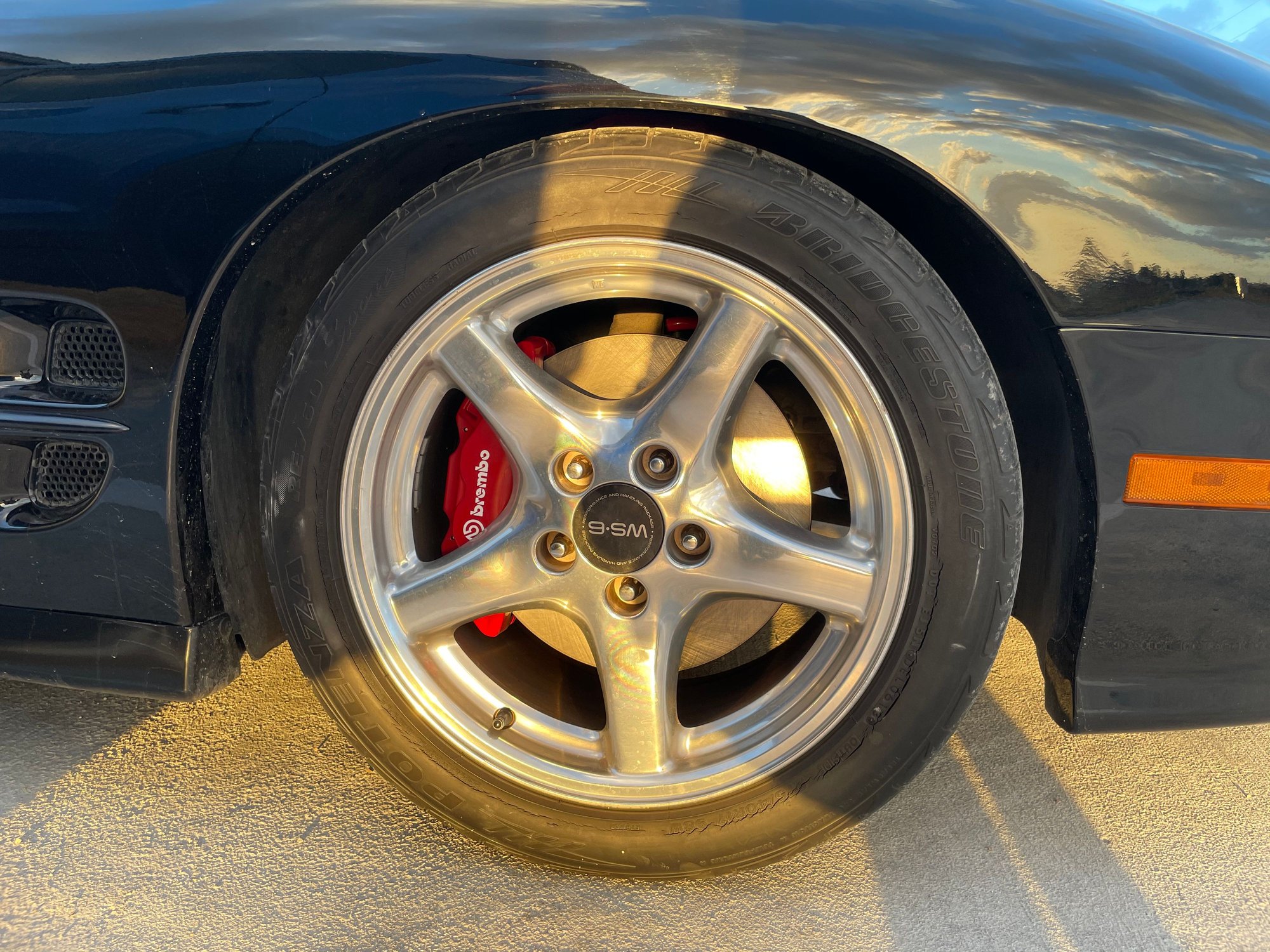

Went ahead and did the ATS Brembo retrofit to my 01 WS6 with factory 17 inch wheels and used the Eibach Pro spacer kit in the 15mm size. They clear but what looks and feels like a hair, to a point where it makes me nervous. Do I need to worry, or should I consider adding another 1-2mm spacer into the mix, swapping out for the 20mm set, or is there another recommendation? I'm extremely happy with the new calipers from a performance standpoint, and they look great as well.

If it clears it won’t move at all your fine if not I believe the smallest spacer I’ve seen is 3mm - mine are really tight too

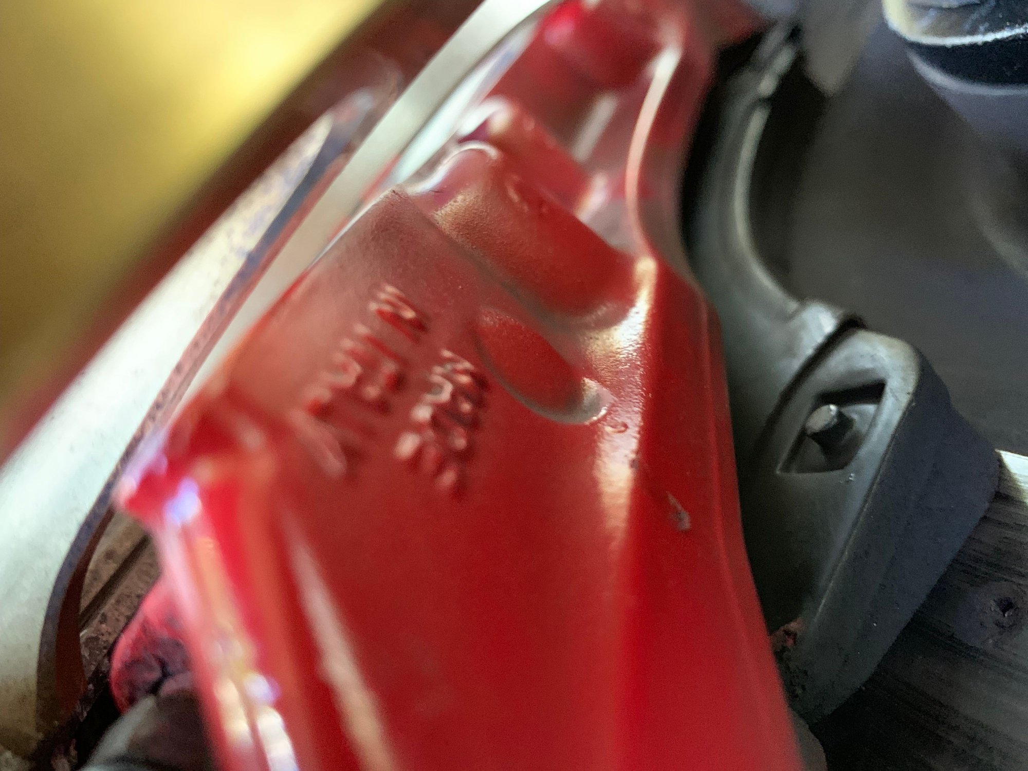

Just checked and I can get a single credit card between the wheel and the tightest point on the caliper, so I think its less than 1mm of clearance.

If you ever really corner hard there is a possibility of touching, not everything is so solid in place, stuff flexes. If your wheel hubs get some play, it'll touch sooner or later. I would not even drive on street with that little gap, and never autocross. A single 20mm spacer is def better than 15+3 or +5 etc, but if you're on a budget it's better than not doing it. Everyone has their own level of comfort/confidence, I err on the side of more confidence.
