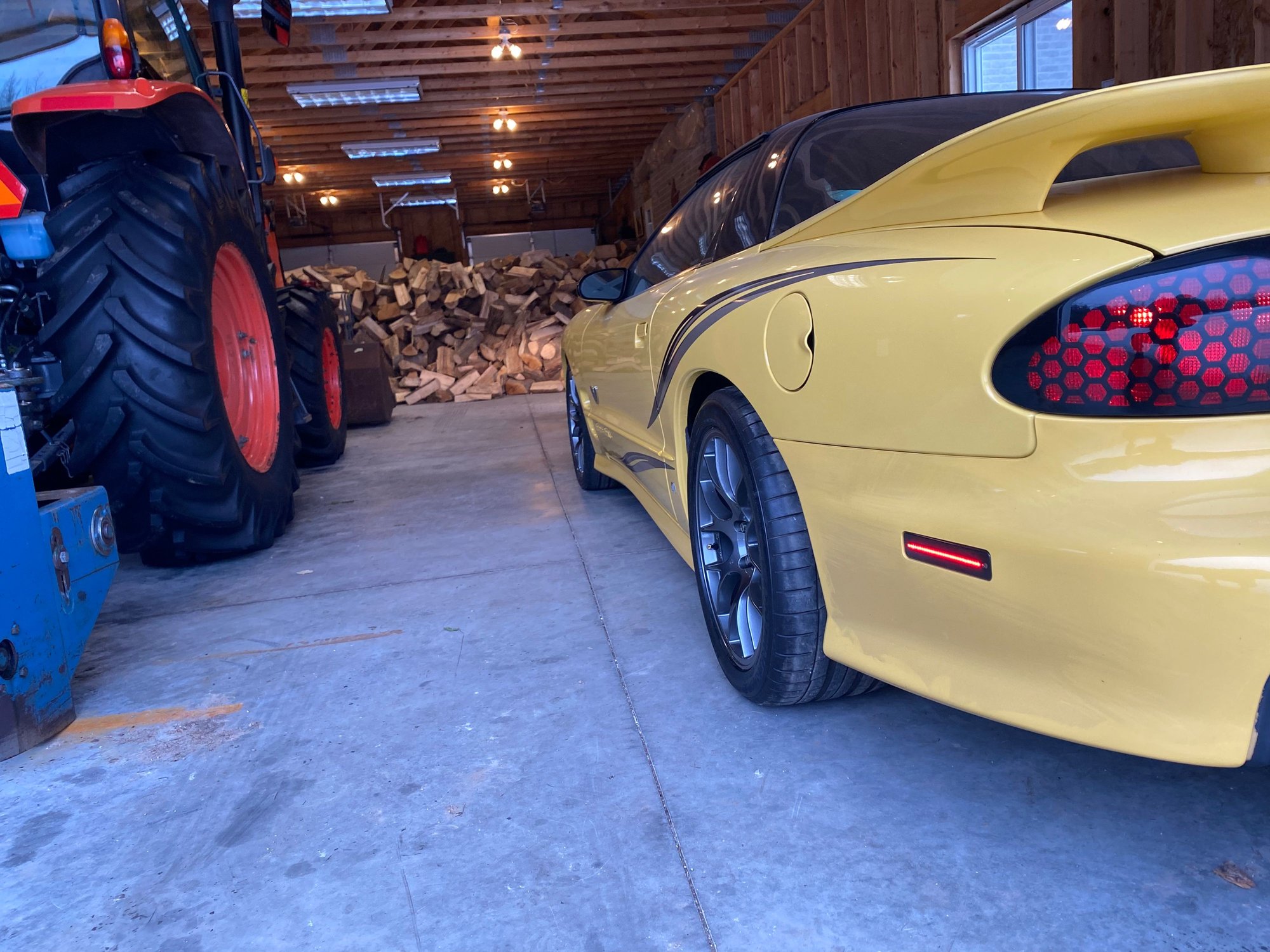

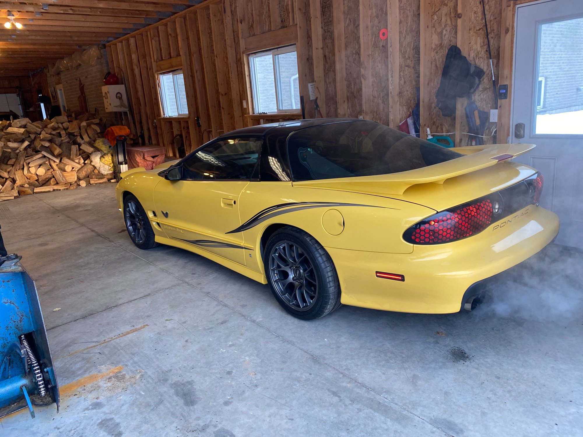

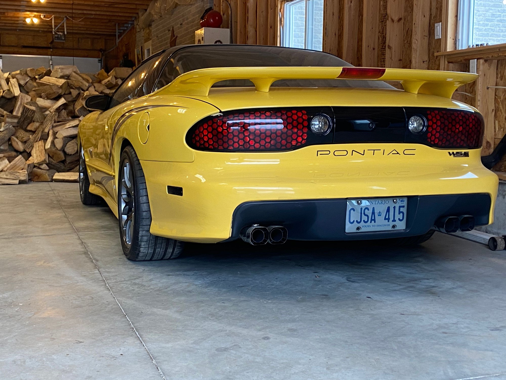

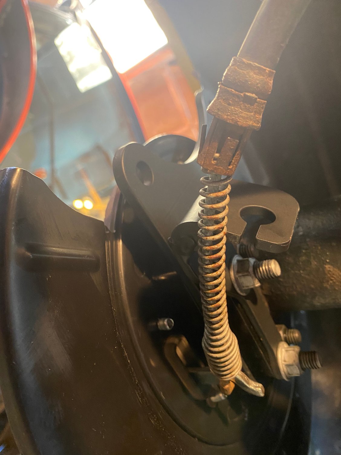

She’s back on the ground!! What a good feeling to finish it up. Wheels are Apex EC7 18 x 9 ET 31. Rears 18 x 10 Et 43. I think it’s the perfect fit as far as spacing goes. Still need 285’s up front. Just have 265’s on there now. E brake was a bit tricky to make work, had to buy cables from a pre 1998 car. Originals were too long. Check.

Did you get the rear parking brake to work?

Yes I did get them working after a few backflips. The original e brake cables were too long ( this is strange as they worked perfectly for some people) and had to buy 93 to 97 cables. They were cheap from Rock Auto. Then my e brake handle somehow malfunctioned and would not actually pull the cable when pulled up. So apart that came and it was that little ratcheting arm was not making contact with the teeth. So I actually made it work better by manually connecting it back together ( no more pivoting up and down) so now the handle engages way sooner and works good. ( before the handle would be straight up and down before engagement) can’t wait for the test drive in May.
Stock spring is too long.
