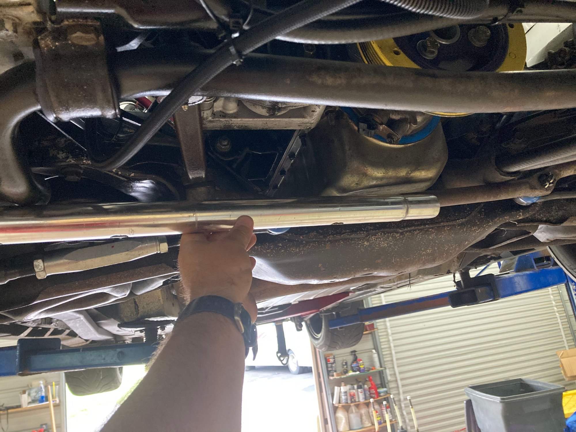

3rd Gen Racecar. Been fighting a crazy front death wobble under light braking. If I drive the car at speed and brake hard into the braking zones, there is very little problem. Only under light braking when I’m learning a new track.
ive replaced rotors and pads, shocks, steering box, pwr steering pump, tie rod ends, ball joints. Today I’m gonna replace the aarm bushings for good measure.
Was wondering if anyone has put a steering damper on a car like this? Was thinking about mounting the fixed end to my sway bar and the moving end on the center link.
Anyone think this is a bad idea? The sway bar doesn’t articulate too much at the morning point.
See picture for mock-up. Thoughts?

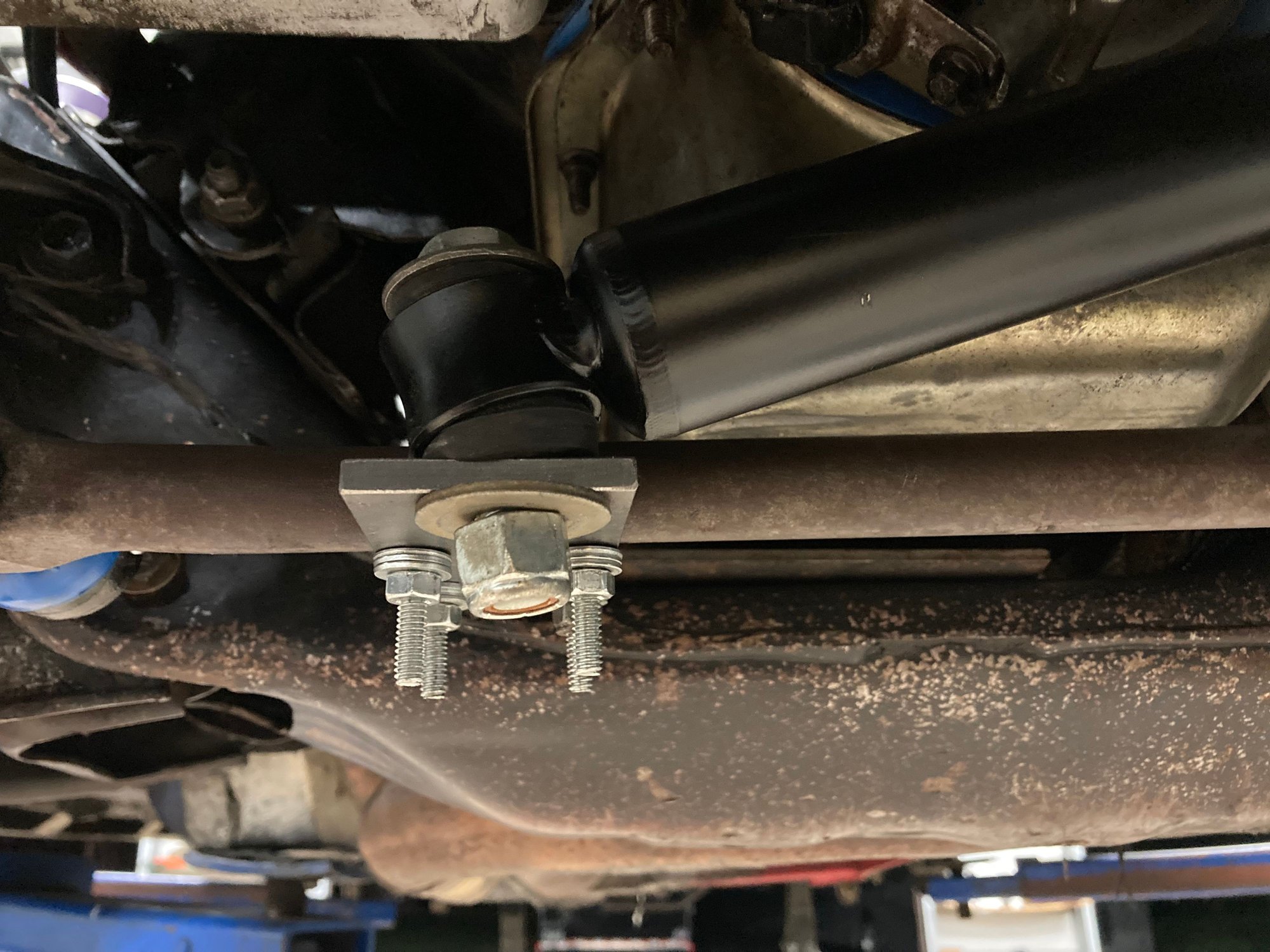

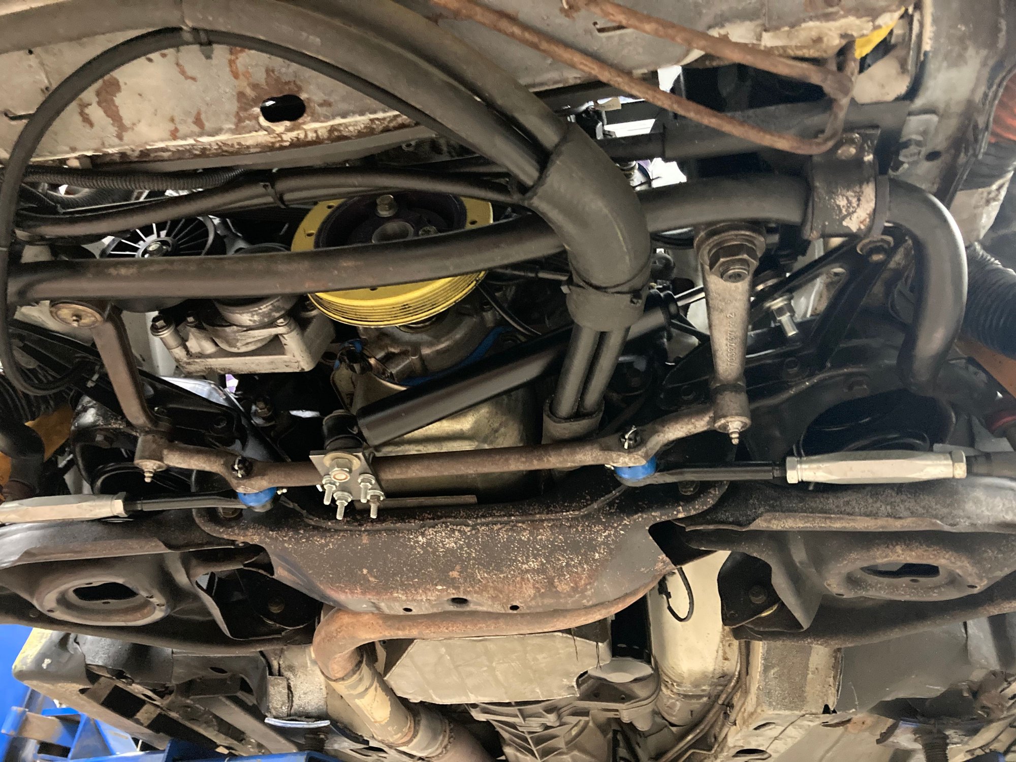

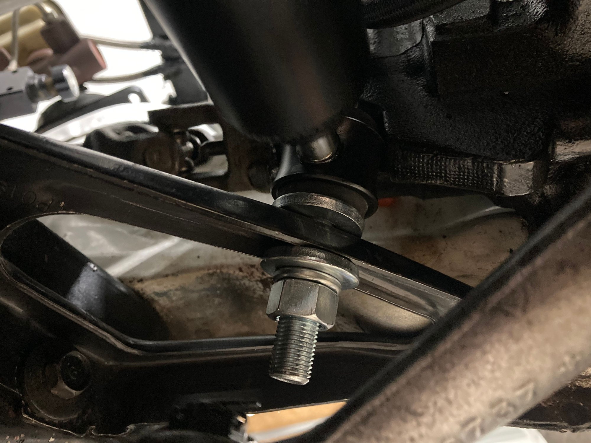

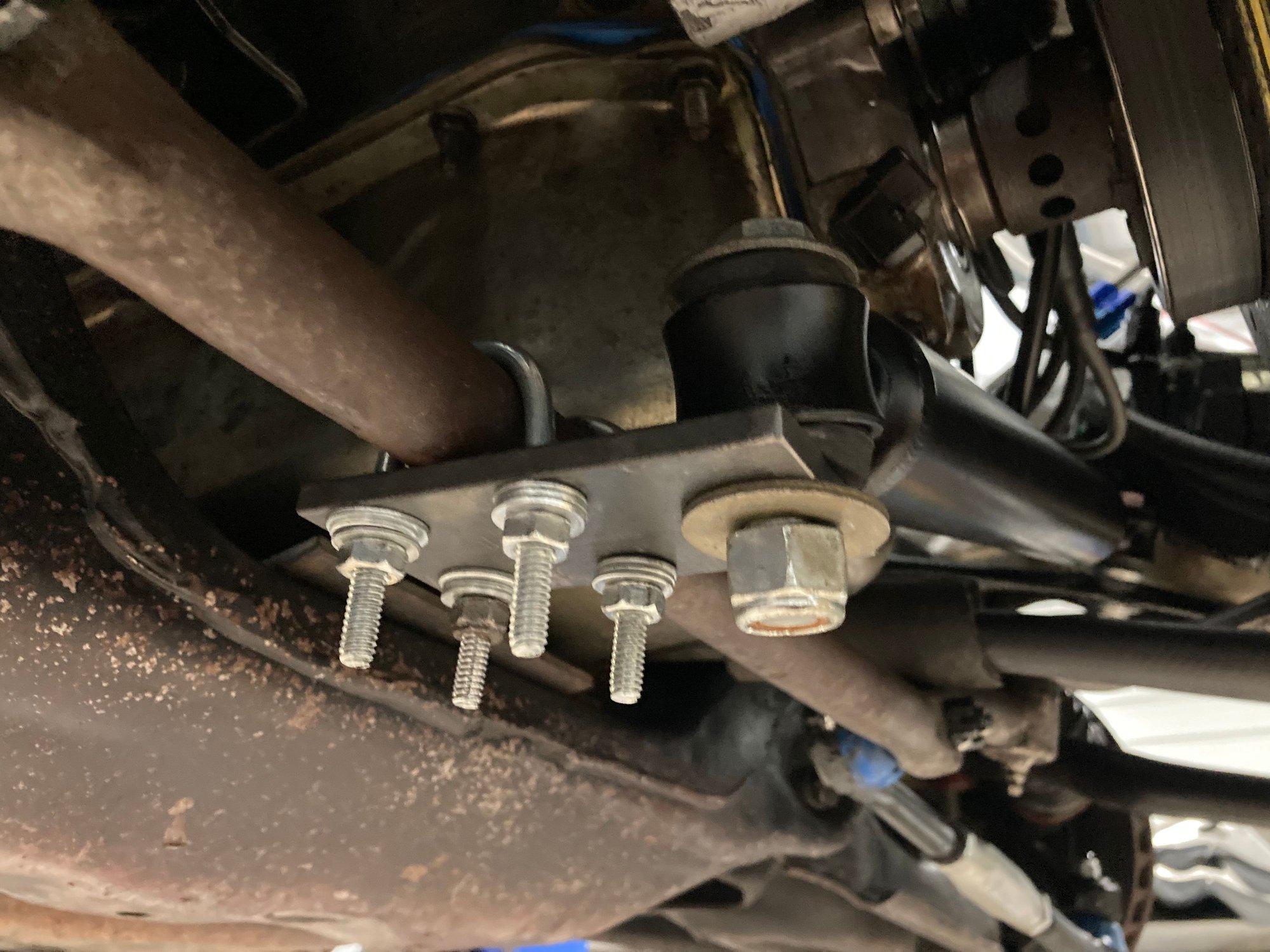

Anyways, some pictures of my damper project. Installed and has at least 1/4” clearance all around lock to lock.
