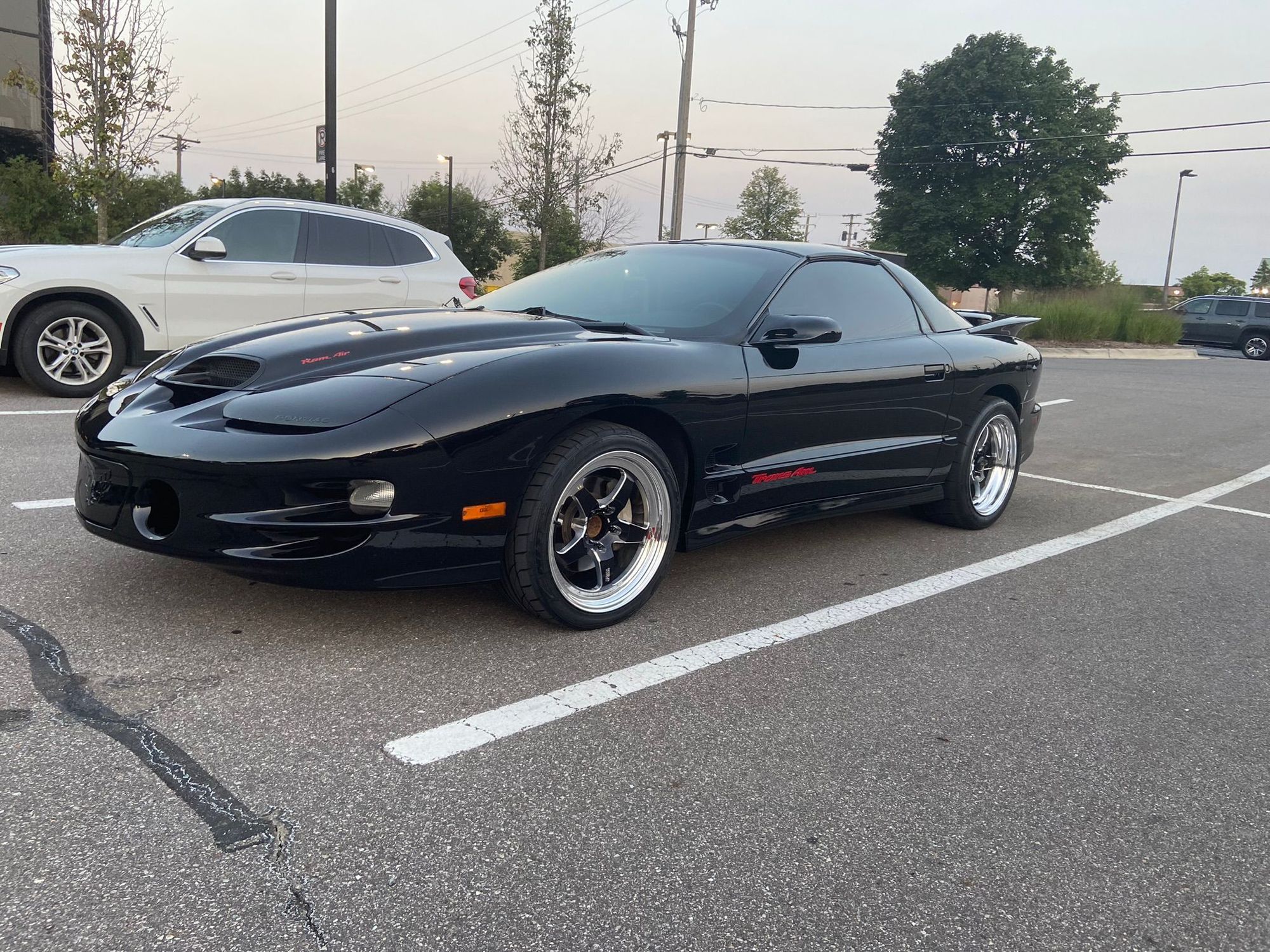

Thanks for your time! Here a picture of my baby- Just bought it about 2 Months ago -17,000Miles, Black on Black; Exhaust, SLP Intake, Blacked out tint, Weld Wheels on Nitto's
and for those of you with keen eyes, yes I am missing my front center caps - 2 were crushed in transport, weld is sending me new ones though.

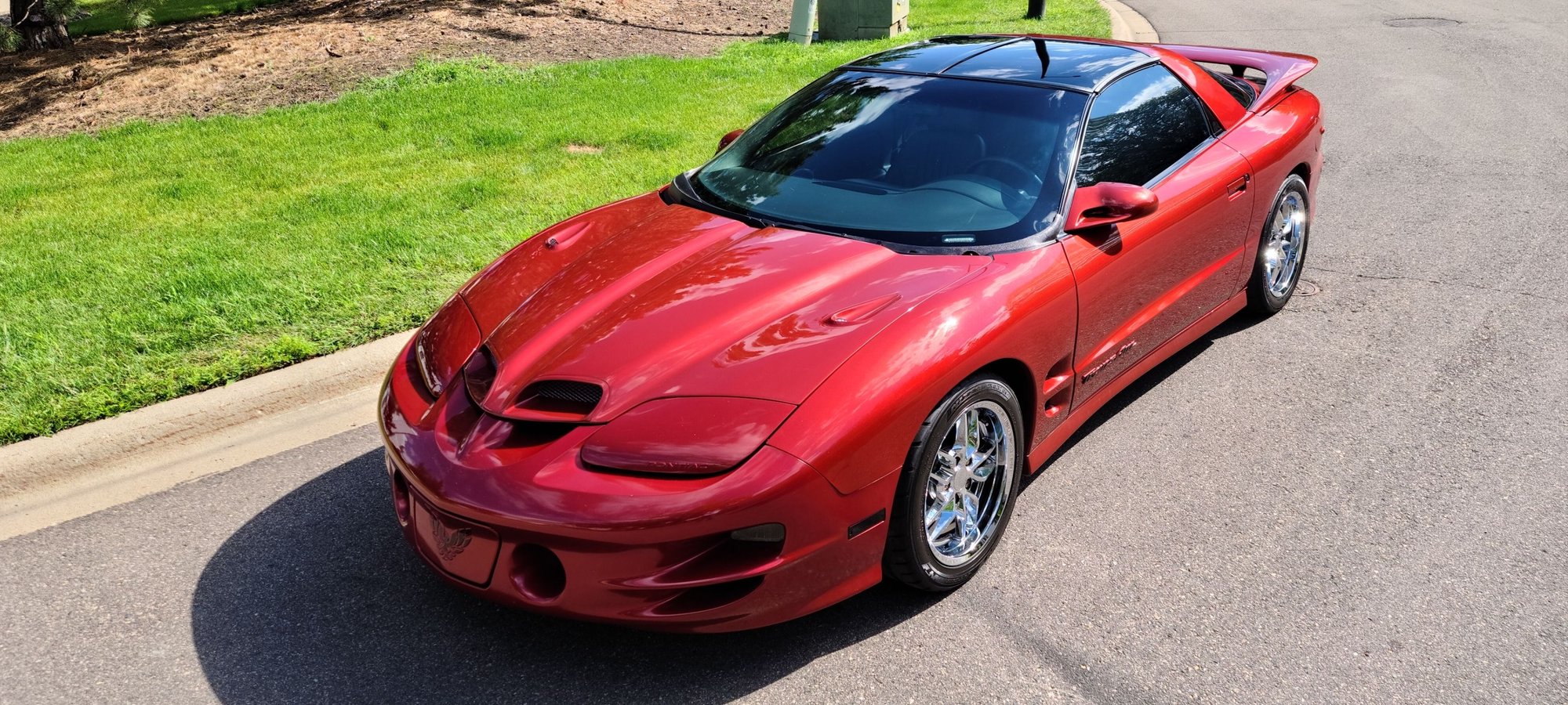

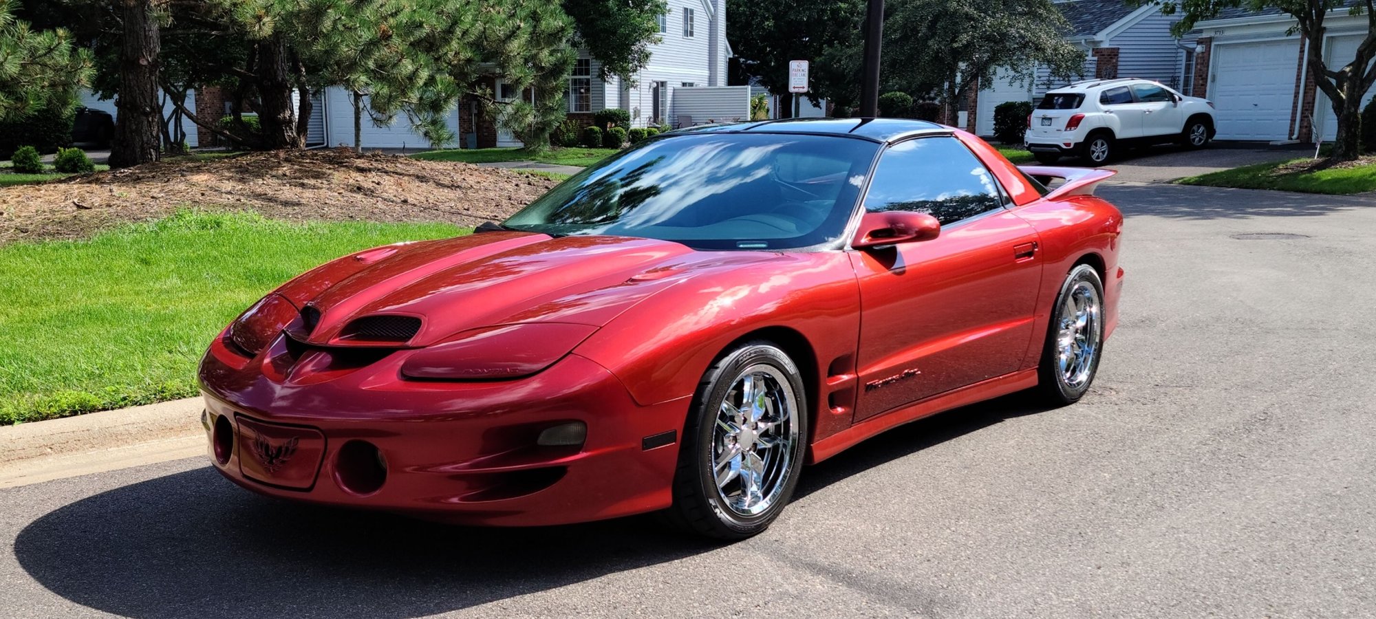

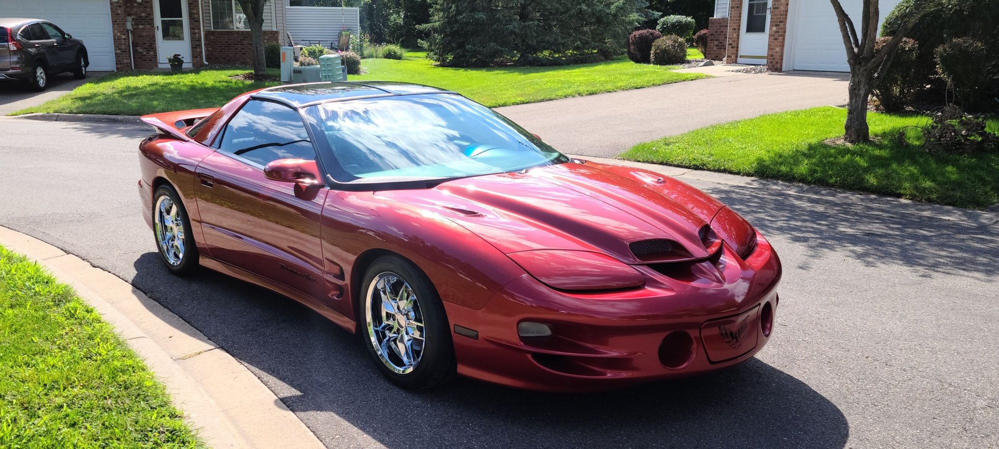

I went with Strano springs and Koni's Sport shocks about a month ago and could not be happier. Imo everything about it is perfect. Handles and rides so much better....I could not of imagined it would be this big of a difference.
From the ground to the middle of my wheel was at 28" front and back and looked like trash when stock.
Now it's at....
Front: 26 3/8
Rear: 26 5/8
Old Jul 30, 2023 | 11:07 AM

That looks amazing, awesome choice on the wheels and tires, what size?
Old Jul 30, 2023 | 01:25 PM
98CayenneT/A's Avatar
Joined: Nov 2013
Posts: 3,913
Likes: 366
From: White Bear, Mn
Thanks much !
Wheels are 17 x 9.5 with a 54 mm off set on all 4 corners.
Tires: 275/40/17 Nt05R on the rear
275/40/17 Nt05 on the front
Rear I'm running 15mm spacers with 3" ARP wheel studs
Front I'm running 10mm spacers with 2.5" ARP wheel studs
For the rear just make sure your bump stops are healthy or better yet just put new ones on

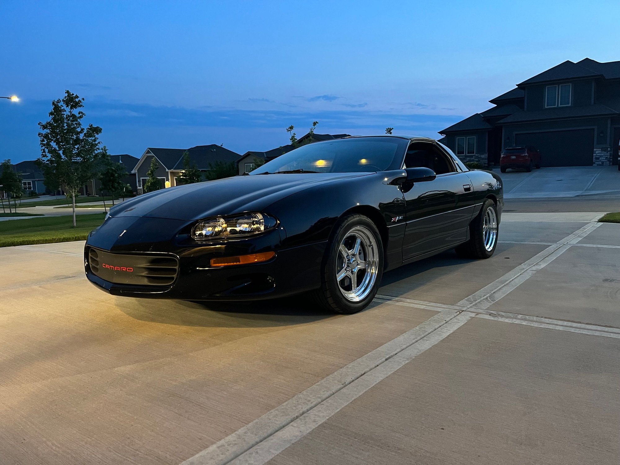

What a clean looking ride, sexy as hell!! What size wheels/Tires?
I am so skeptical about pulling the trigger, emailed Sam and he seemed to be hesitant about what option I should go with, and I will admit I didn't fully understand the email.
I know there is that one 2002 CETA owned by a guy named Tim - I wonder that he's running
Old Jul 31, 2023 | 08:24 PM
99Silver6.0's Avatar
Joined: May 2002
Posts: 4,440
Likes: 93
From: Spring Hill, KS
Thanks! 17x9.5 wearing 275/40/17’s and 17x11 out back with 315/35/17’s. The drop really isn’t extreme. I would not have wanted it any lower than this. I never bottom out or scrape on anything though. Not even my ARH Y pipe scrapes on anything. It ticks up better than the stock exhaust did.
