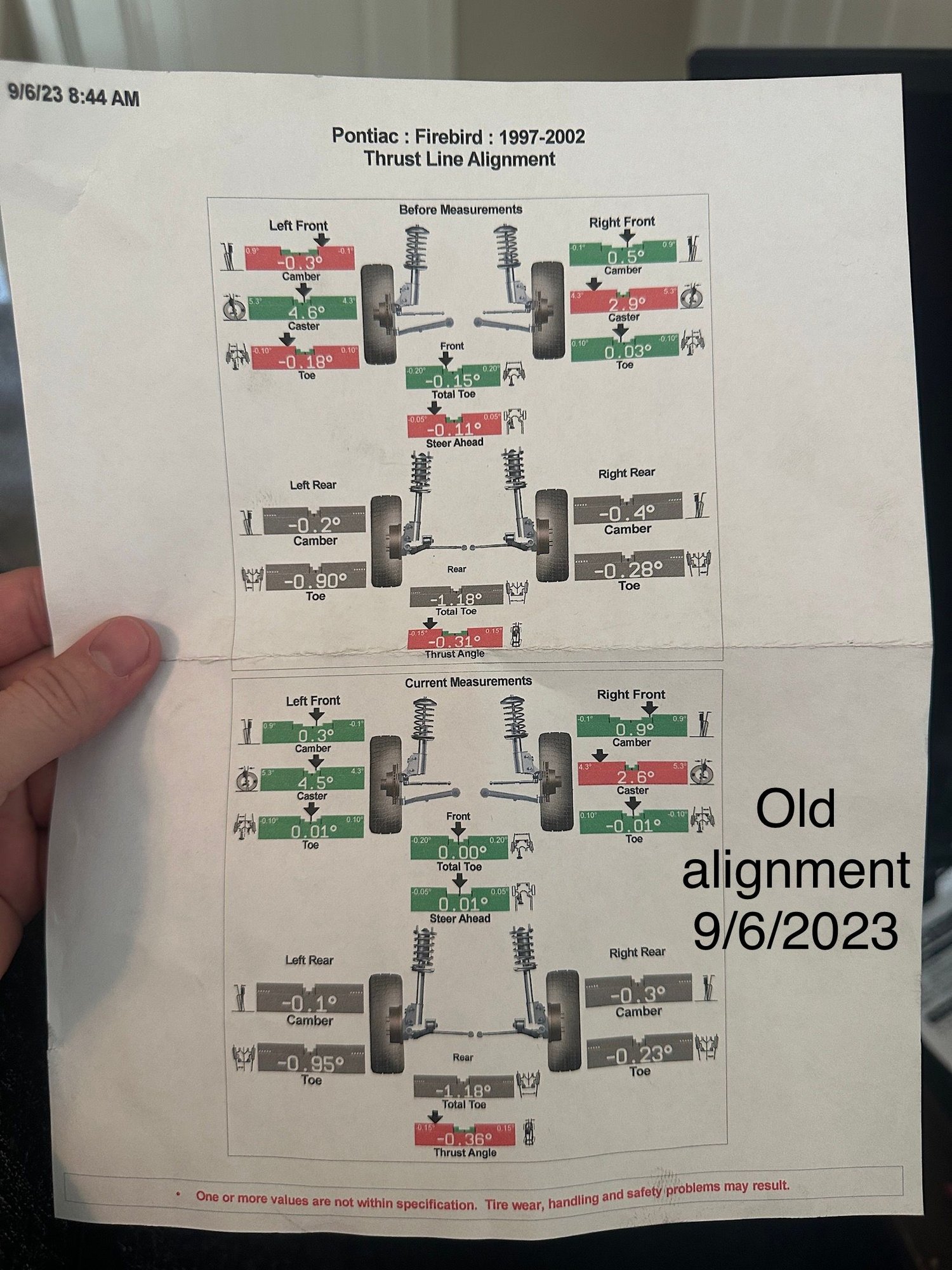

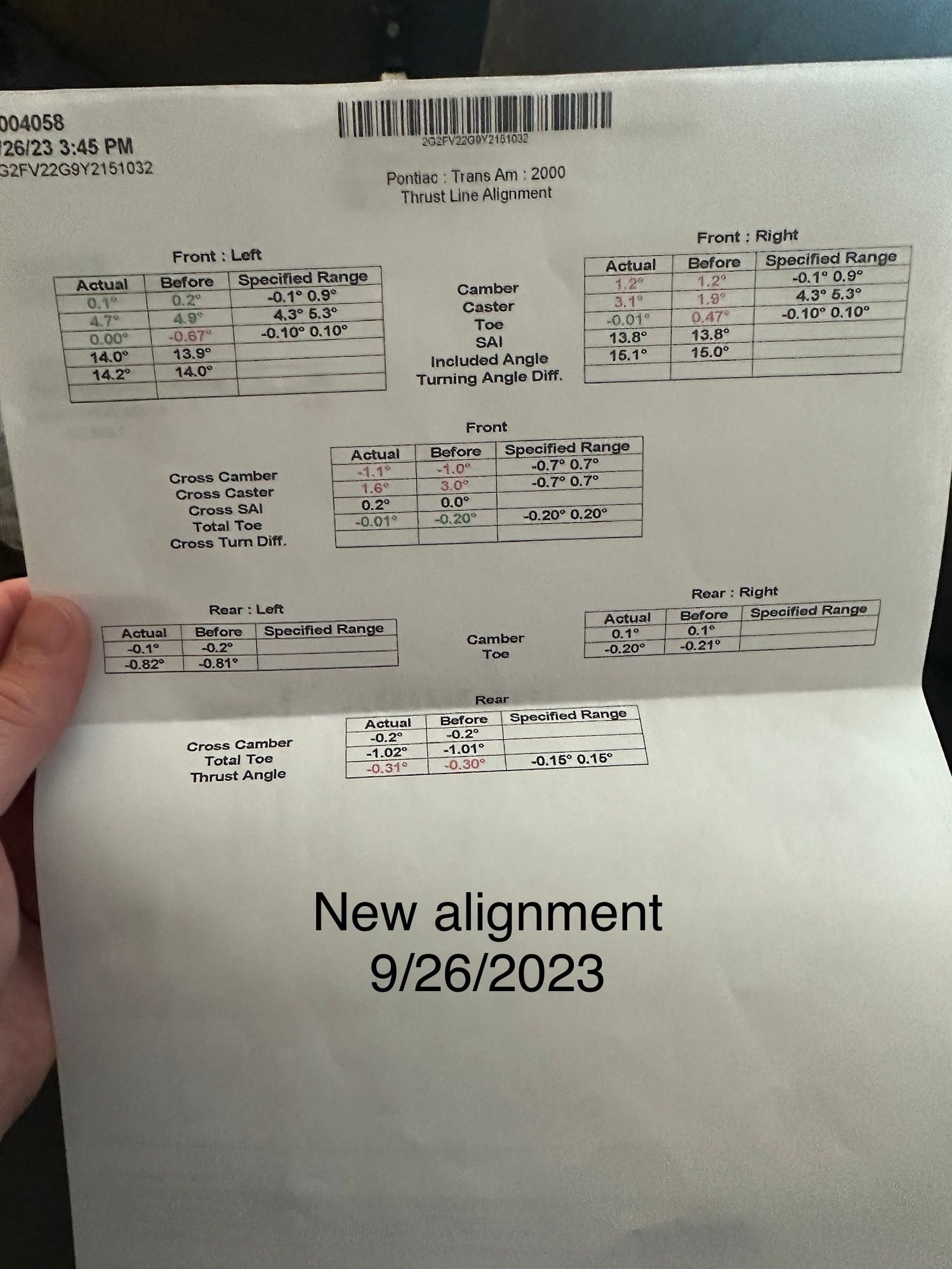

I have a quick question for the knowledgeable people here. I recently bought a 2000 WS6 and it pulled super hard to the right I took it to two shops and the second said they noticed the K member was bent and more than likely in an accident. I replaced it with a tubular K member which allowed them to adjust the front right caster from 1.9 to 3.1 on the passenger and 4.6 on the driver side. The thrust angle is also at .31 and the toe in the back is -.82 and it still pulls hard right. What should I be looking for to fix these issues without spending thousands at a body shop to have it scanned for frame damage? Any advice would be great. I was thinking of looking at getting adjustable rear lower control arms and panhard if it would help.

Toe out in both rear wheels seems odd, like really odd. Thrust angle would mean the at as much as one side is out, the other would be in, roughly speaking. And the rear camber isn't nuts, which makes me wonder how this is happening as it's not likely a bent axle.
The caster in the front, well that is almost assuredly a bent steering knuckle.

I am wondering if the rear control arms are bent and that’s why the thrust and toe is so off. I order a BMR adjustable panhard to fix the rear wheels sticking out more on the drivers side. I heard the knuckle bends easy if there is a collision with the front tires so I may buy one and see if that fixes it at all. But would putting on a new knuckle fix it by itself without replacing anything else if that’s all that is wrong?

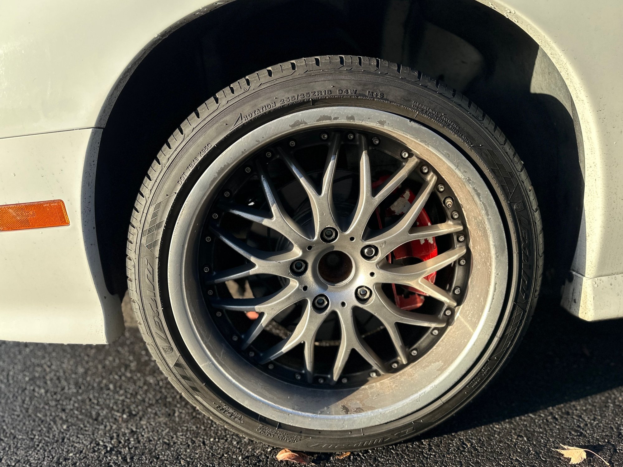

there is about 1” difference from front fender to tire between the driver and passenger. Driver is 4” and passenger is 3” and the passenger spring is way more compressed.
Hard to see in the pictures but I'd say this is another indication that something else is bent in the front.

yeah it is kind of hard to see. I can’t out my fist between the passenger side fender and tire but i can on the diver and then some. I know these cars lean more in the passenger but I wouldn’t think this much, at least my last Trans Am was near perfect. Do you have a suggestion what I should check for? Was thinking upper arms, shock or spring.
