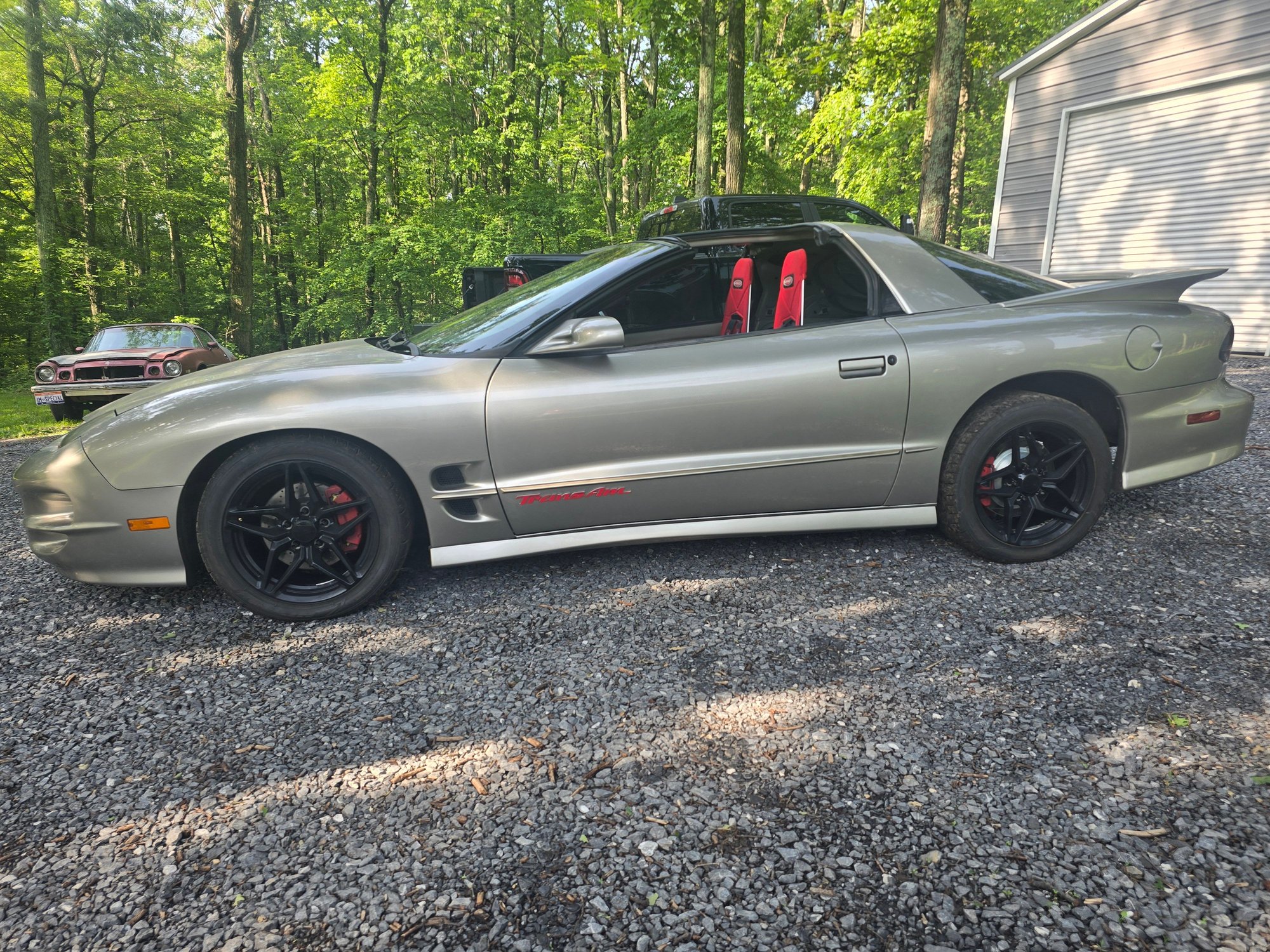

This is how mine sits currently. Pic was from this morning after a short trip to get a good data log. The umi crossmeber is what scrapes for me. You can see the garage entrance in pic. It's an incline leading into it but not that bad . Factory 10 bolt umi torque arm relocation with driveshaft loop. 275 40 17 on all 4 corners. Handles awesome
Why does your rear wheel look like it's way too forward??
camera angle
