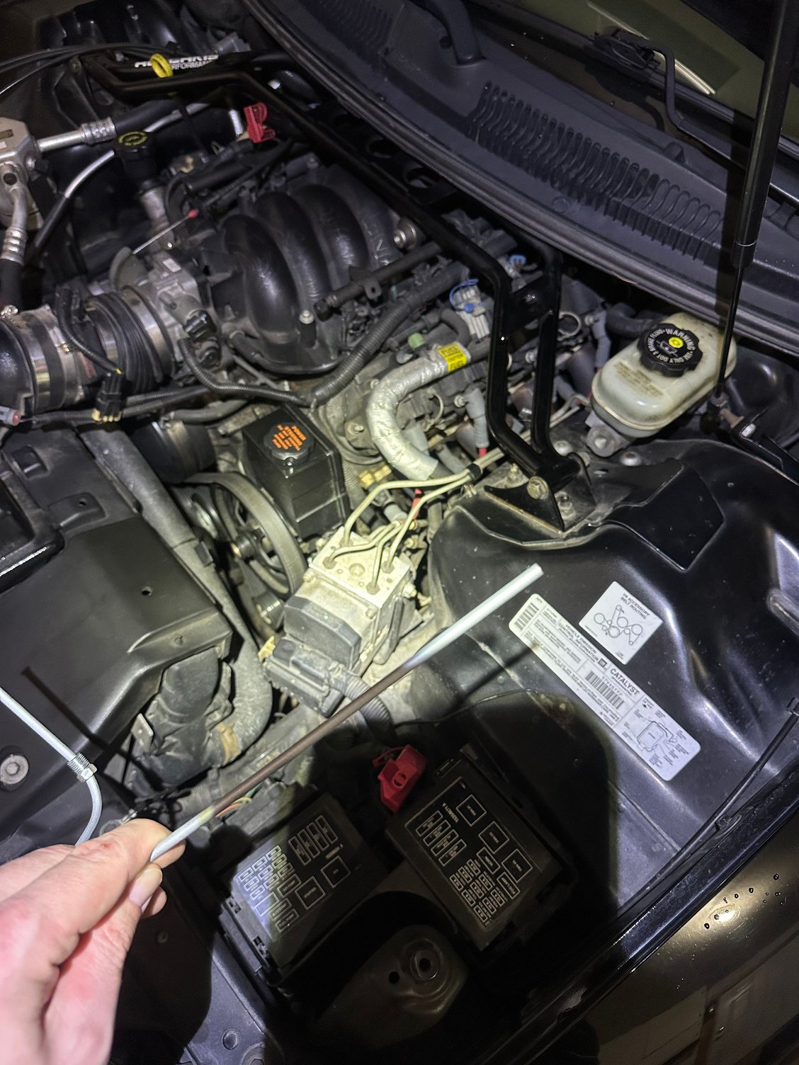

So I ordered the SJM line lock kit with ABS delete a while ago. I’ve been kinda waiting to put it on cuz I’m nervous about flaring the lines. I got a flare kit, some flare nut wrenches, and I’m pretty sure I have all the tools I’ll need to do the install.
One thing I’m not clear on is I’d like to keep my stock braided lines, which is presented as an option in the instructions, but I’m not sure where to cut them. I’m also not sure if I will need any additional fittings once I do cut some lines. Some of the provided lines have no flare or fitting.
I haven’t been able to find many walkthroughs or videos for my exact kit on the 98-02 models, so I was hoping some of you might have some good info.
Will I need any extra fittings? This is my daily, so I can’t have it down for an extended time. I need to be able to do this in a weekend.

This thread has details for line lock and proportioning valve, completely deleting the ABS block.
