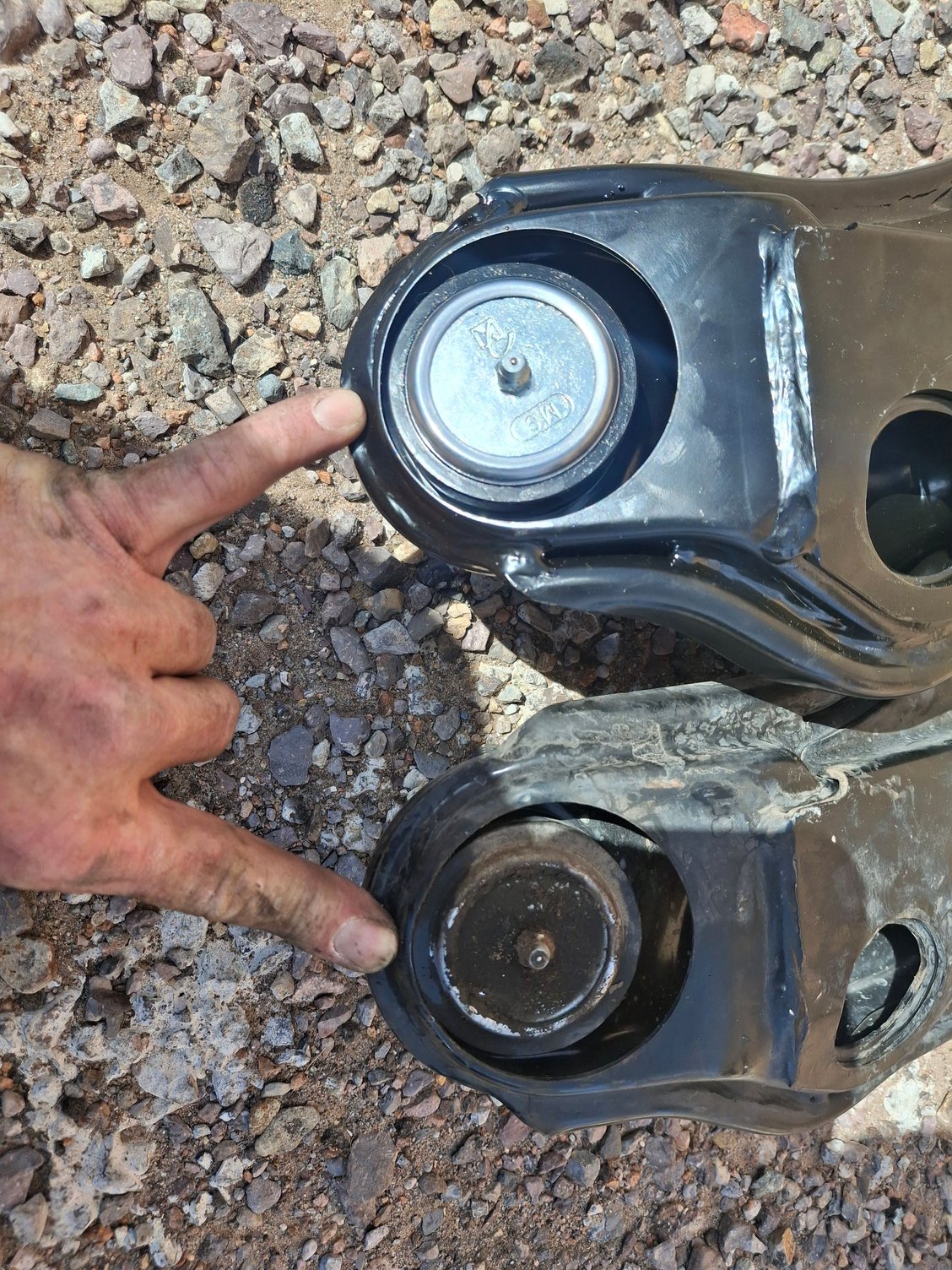

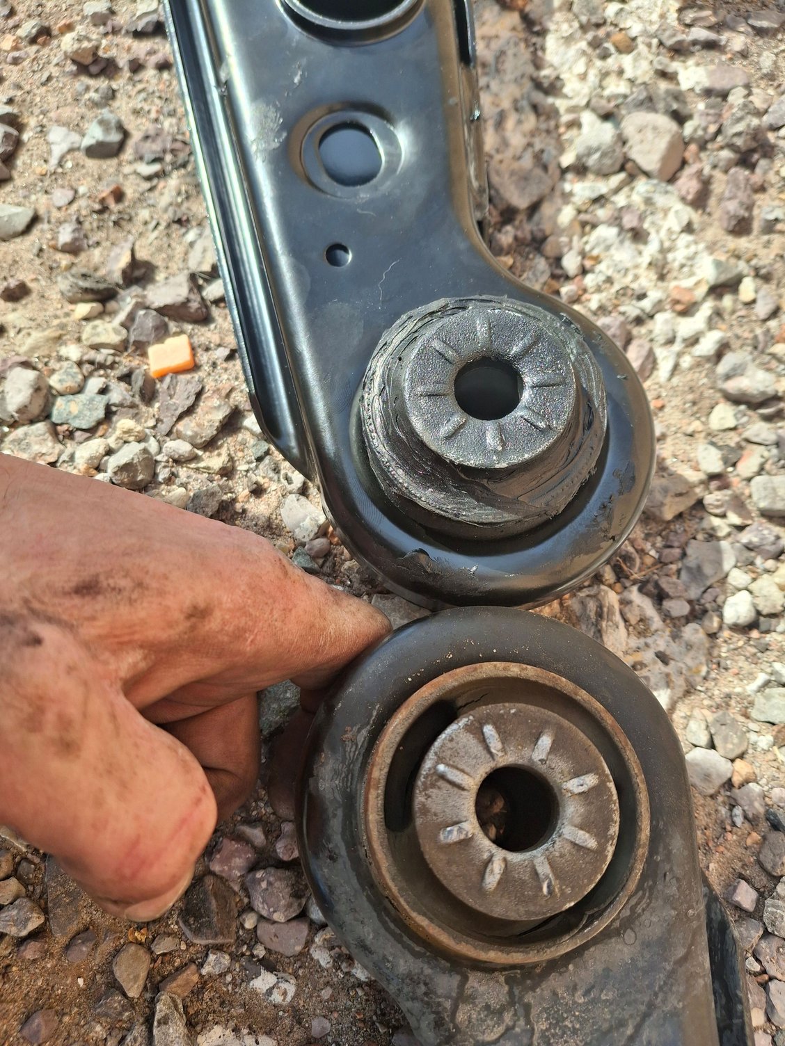

My buddy brought me his camaro with a front end issue after replacing everything. He used mevotech supreme upper and lower arms like I did but without window weld in the air gaps. It has some super stiff springs and anti roll bars.
The sheetmetal on his set of control arms bent at the ball joint press surface causing weird alignment issues under cornering but the car could be put into dead even alignment numbers on a rack.

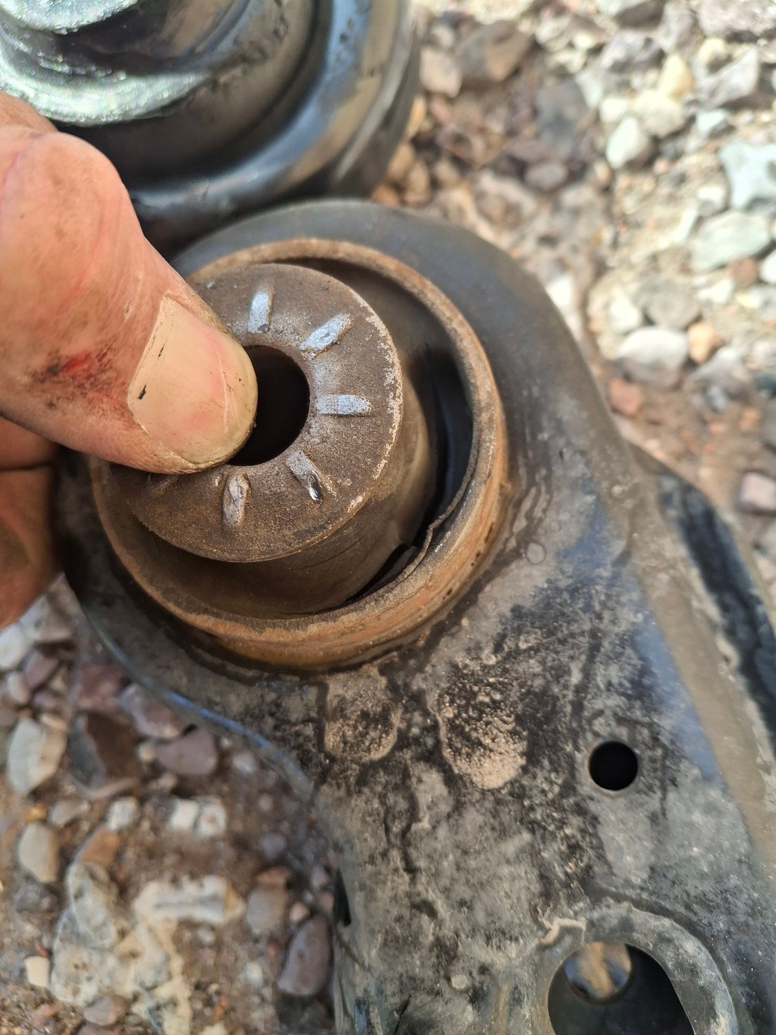

Pictures attached of a 1 year old torn mevotech bushing and bent control arms at the lower ball joint mating surface.
He swears no curbs and the car shows no evidence of any curb hits etc.

The ball joints were perfect still had preload and no play but the arms bent bushings went.
New arm and bush filled with window weld
Note ball joint distance and angle new vs old.checked my car and my arms have proper gaps still like the new here.
1 year old torn drivers side control arm bushing, manufacturer using garbage rubber.
