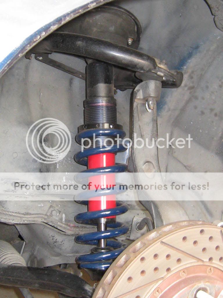

Finally got around to installing the QA1's today. The install went really well. Didn't really have any problems. The biggest pain was drilling out the jounce bumper to fit the shock because we really didn't have the right drill bit. It sits really low now. I really like it. Pretty much no gap. I set the **** to six clicks and honestly it rides better than it did before. I only had 55K on the old decarbons but it feels much softer. I thought it would be more bouncy or too stiff. It rides like a caddy as far as I'm concerned and I only have the fronts done right now. I will post some pics of the car after I clean it up a bit.

Here are a few pics. Let me know what you think.
Attached Thumbnails QA1's install.-img_1176.jpg   QA1's install.-img_1174.jpg   QA1's install.-img_1172.jpg   QA1's install.-img_1171.jpg

The fronts are coil over's, so you can adjust the ride hight in the front, correct?

Yep. I like them a lot. Can't wait to get the rears but it'll be a while.

What is the Jounce Bumper?

It protects dirt from getting into the shock and I believe it works like a bump stop when you completely compress the shock. You remove it from the decarbons and install it on the top of the qa1's.

Any pics with these on the struts?
