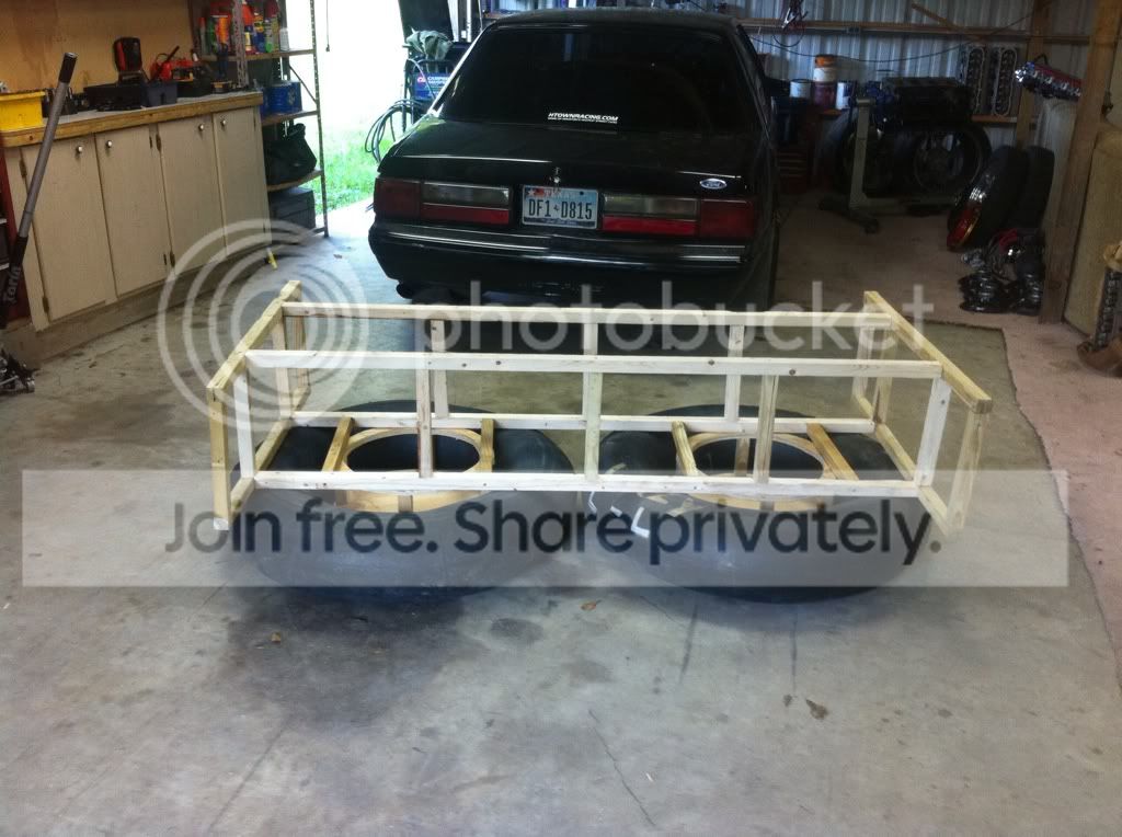

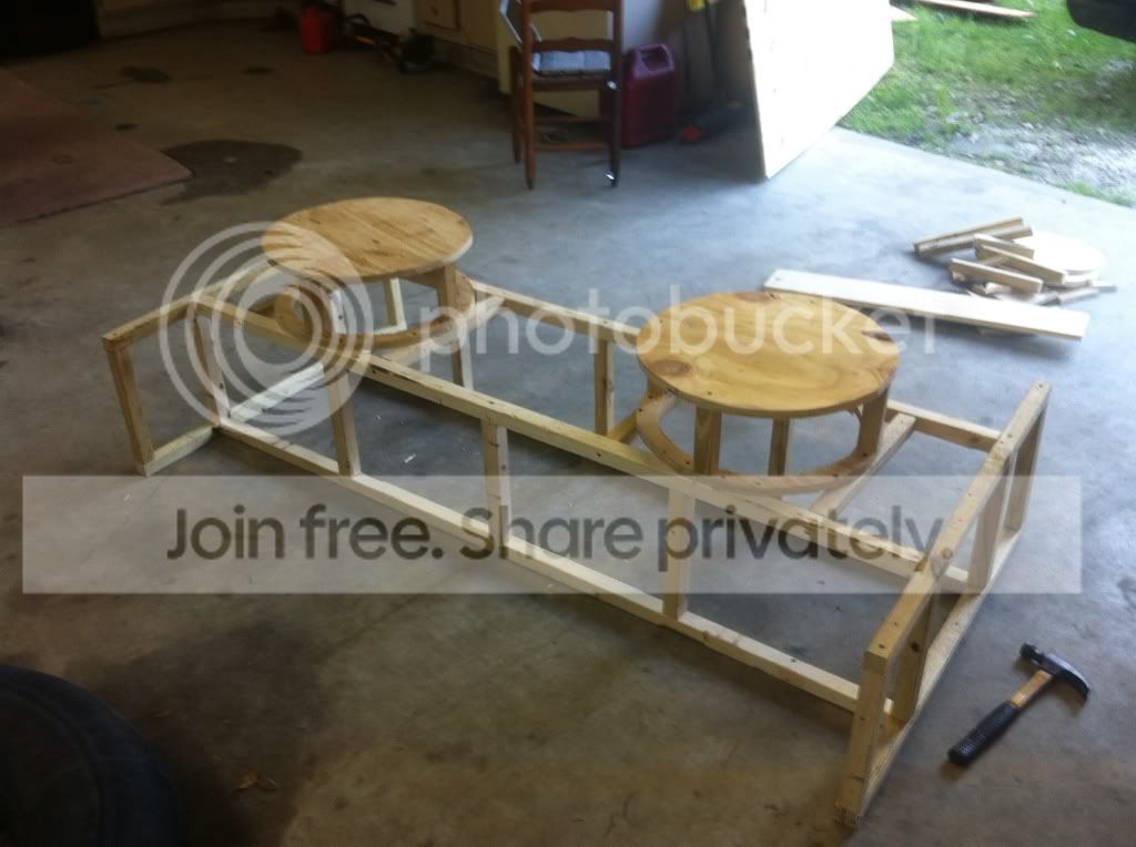

Well alot of y'all saw the one from last year it had 8 6x9s and two amps, this year I'm stepping it up a bit with 12 6x9s and 3 amps and the quality of it is goin up as well,

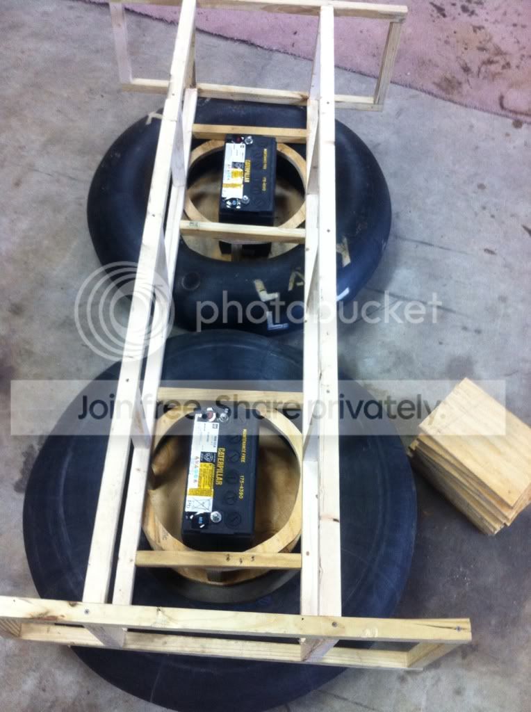

It's gonna have battery trays that fit down inside the tube to keep a lower center of gravity, it's also gonna have a pa system that will go through all 12 speakers and it will have an iPod interface which has a separate screen and controller that will be mounted on the outside of the box so once you plug in iPod everything will be controlled from the outside of the box, and everything will be powered by 2 caterpillar 1000 cca batteries
This one will be fiberglassed and painted lime green<~~per request of the wife
Here is a pic of the old one
And here is the start of the new one

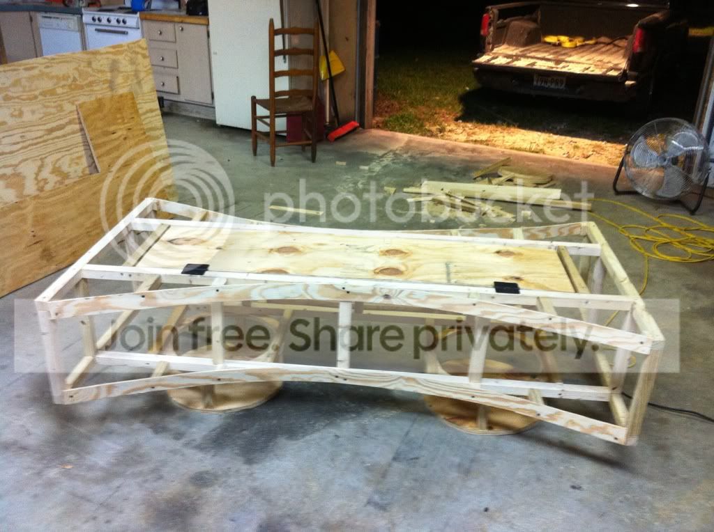

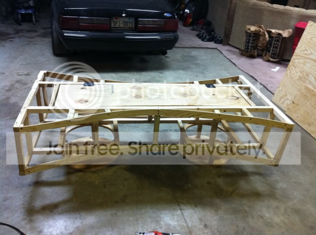

Got a lil more done last night, got the radius on and it def added the look I was hoping for and got the lid installed but the 3/4 peice of plywood is warped so bad I'm gonna take it off and get another sheet and make new lid,
New speakers will be in this week then I'll finish the speaker rings and get those mounted

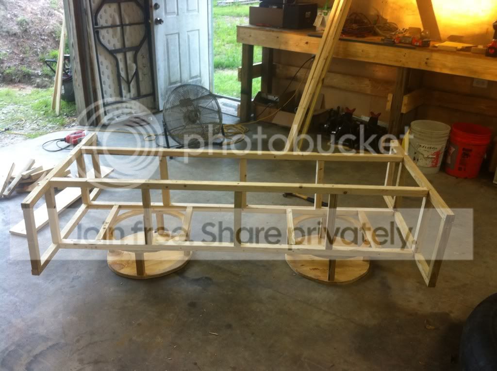

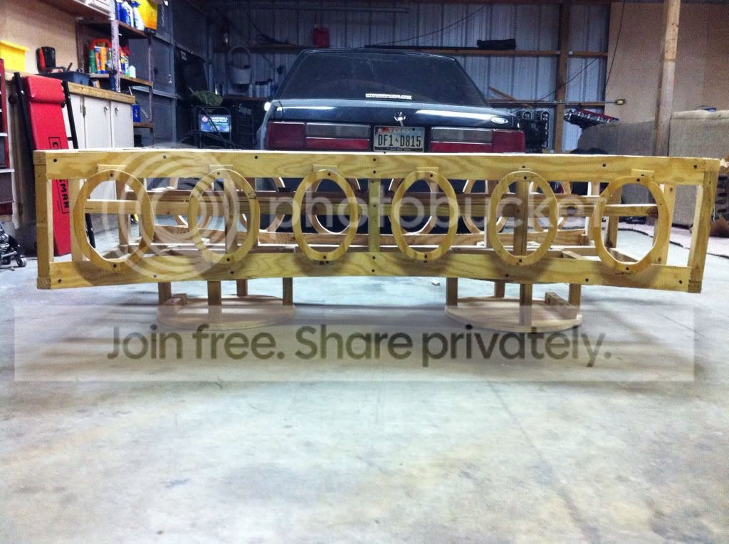

Got some more done tonight, Got all 12 speaker rings mounted, only got 6 of them braced was getting tired. Got the lid mounted with hinges and the amp rack mounted with hinges as well and also the battery braces
Almost ready for fiberglass
I'm also having a hard time choosing the color tell me what you think

Looking good. I like the green color on the Monster can...And forgive me for my ignorance, but how do you ground the batteries?
Old Mar 31, 2012 | 08:16 AM
jiveass's Avatar
Joined: Dec 2010
Posts: 17
From: Spring/The Woodlands
ground the batteries to what? hes just running his amps and radio off of it...
Old Mar 31, 2012 | 09:22 AM
Charlie Hustle's Avatar
Joined: Dec 2004
Posts: 627
From: Houston, Tx
Thats where Im lost. I thought the amps or batteries had to be grounded...
Old Mar 31, 2012 | 09:53 AM
jiveass's Avatar
Joined: Dec 2010
Posts: 17
nah...you can use batteries anywhere.....you connect the battery negative post to the chassis in vehicle applications because a lot of electrical components in the vehicle use the chassis as a source of ground, while still retaining a specific hot wire for each component. in this case, he can ground his amps and head unit straight to the negative post on the battery.
