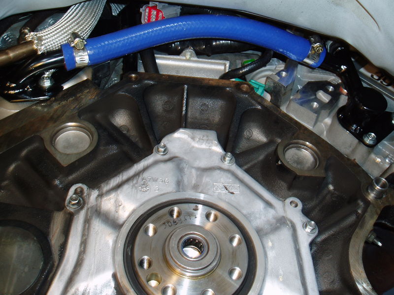

Pretty spot on, seating position and shifter position are not ideal, other than that I loved mine. I bought one new and had it for 5 years, full bolt-on, pullied and ported steggy blower, made just shy of 500 RWHP. A bad tune will kill these cars as it would any boosted car. The piston does have a tight clearance with cylinder wall that can be an issue if you are making back to back high speed runs, have detonation/bad tune etc...
If you want one, definitely look for lower miles, but I would not be so worried about mods, so long as they are done correctly.
EDIT:Should you buy one that does not already have an aftermarket heat exchanger for the blower, get a good HE and do this cooling mod from LDC, improves coolant flow from driver cylinder head to passenger...
