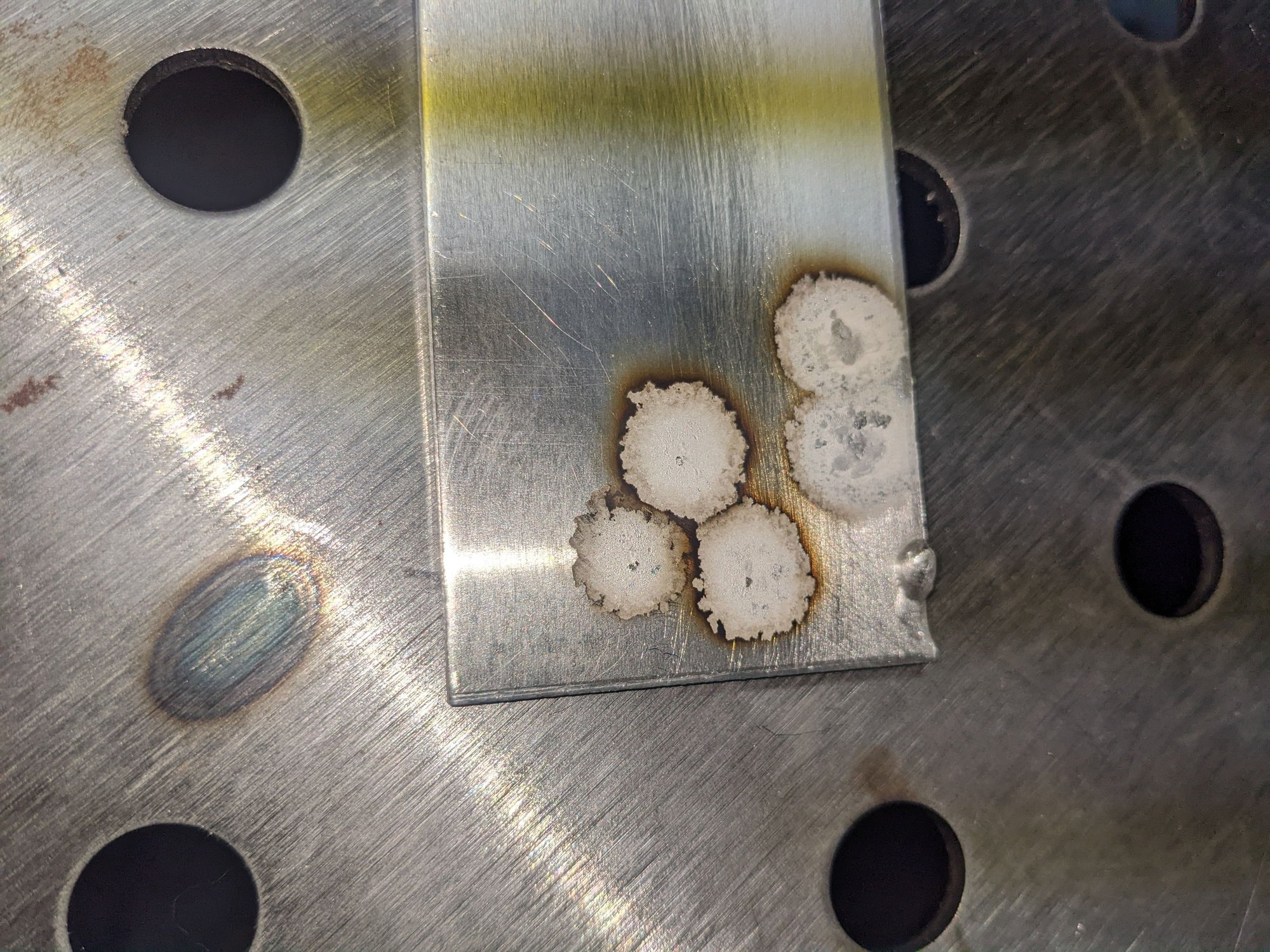

AlphaTig 203xi First time on AC aluminum. Cant get a puddle and just leaves white mark. Works good on DC. Pictures included...

Flip your leads, torch to negative. Unless there’s some kind of documentation for that specific machine that states otherwise.
Old Jan 11, 2022 | 07:29 AM
54F100's Avatar
Joined: Apr 2017
Posts: 67
From: Upstate, NY
Thank you!

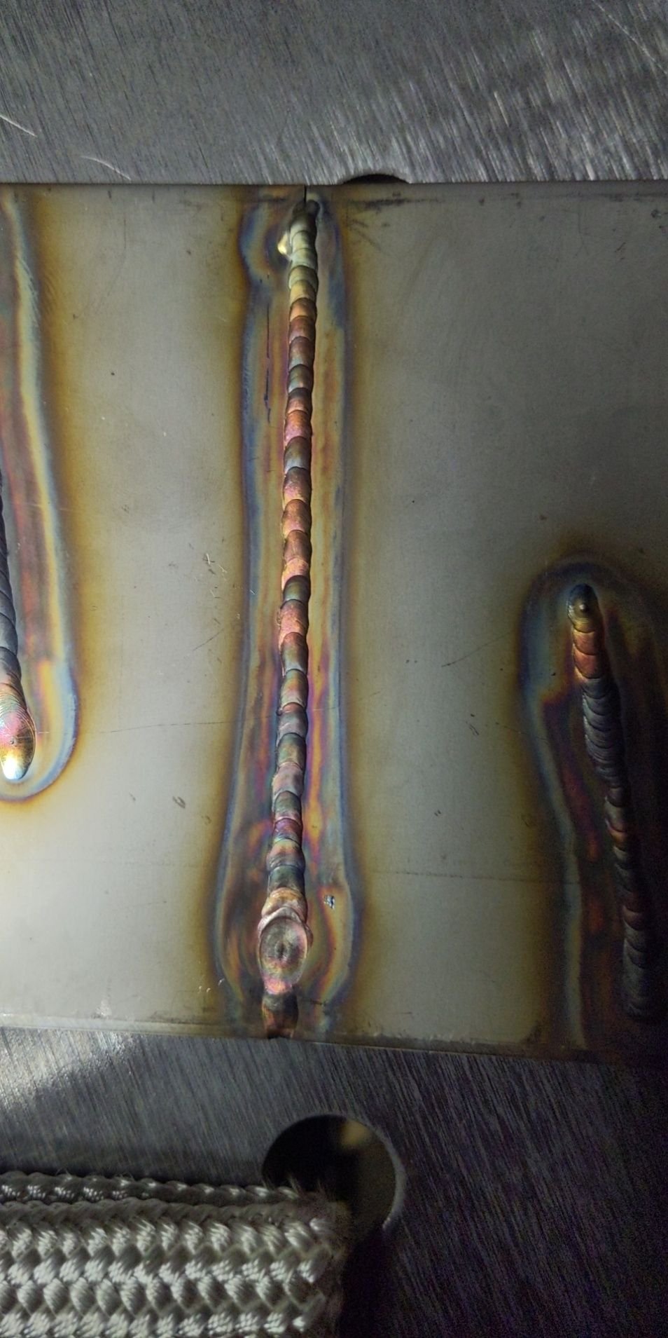

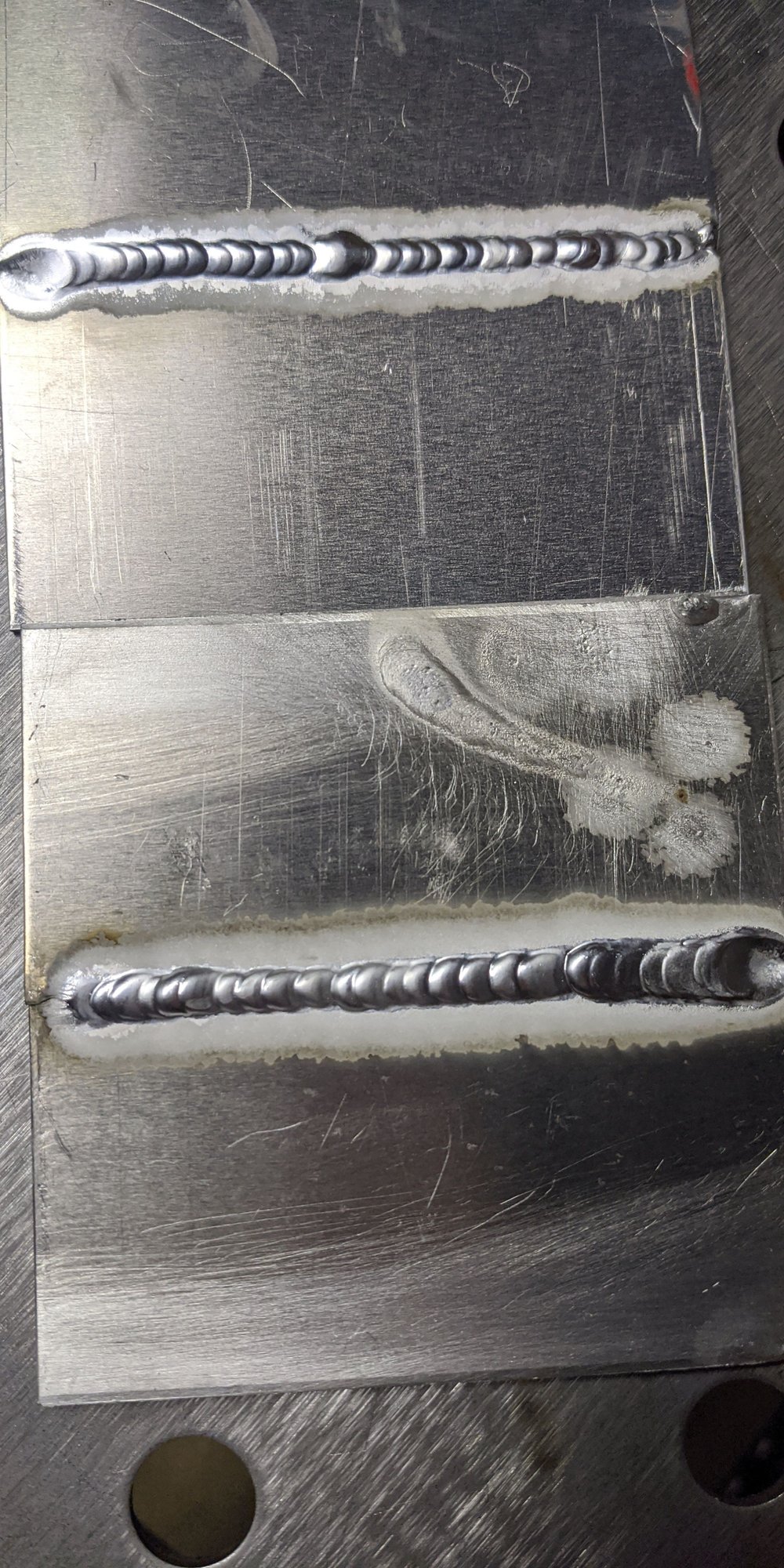

First time with aluminum and stainless....
Old Jan 16, 2022 | 05:21 PM
pdxmotorhead's Avatar
Joined: Oct 2016
Posts: 2,513
Likes: 480
From: PDX-OR-USA
Which gas mix are you using?
Old Jan 16, 2022 | 07:55 PM
54F100's Avatar
Joined: Apr 2017
Posts: 67
From: Upstate, NY
100% Argon
Old Feb 19, 2022 | 04:34 PM
Jimbo1367's Avatar
Joined: Jul 2009
Posts: 8,034
Likes: 663
For the first time, that looks good. Steady hand!
