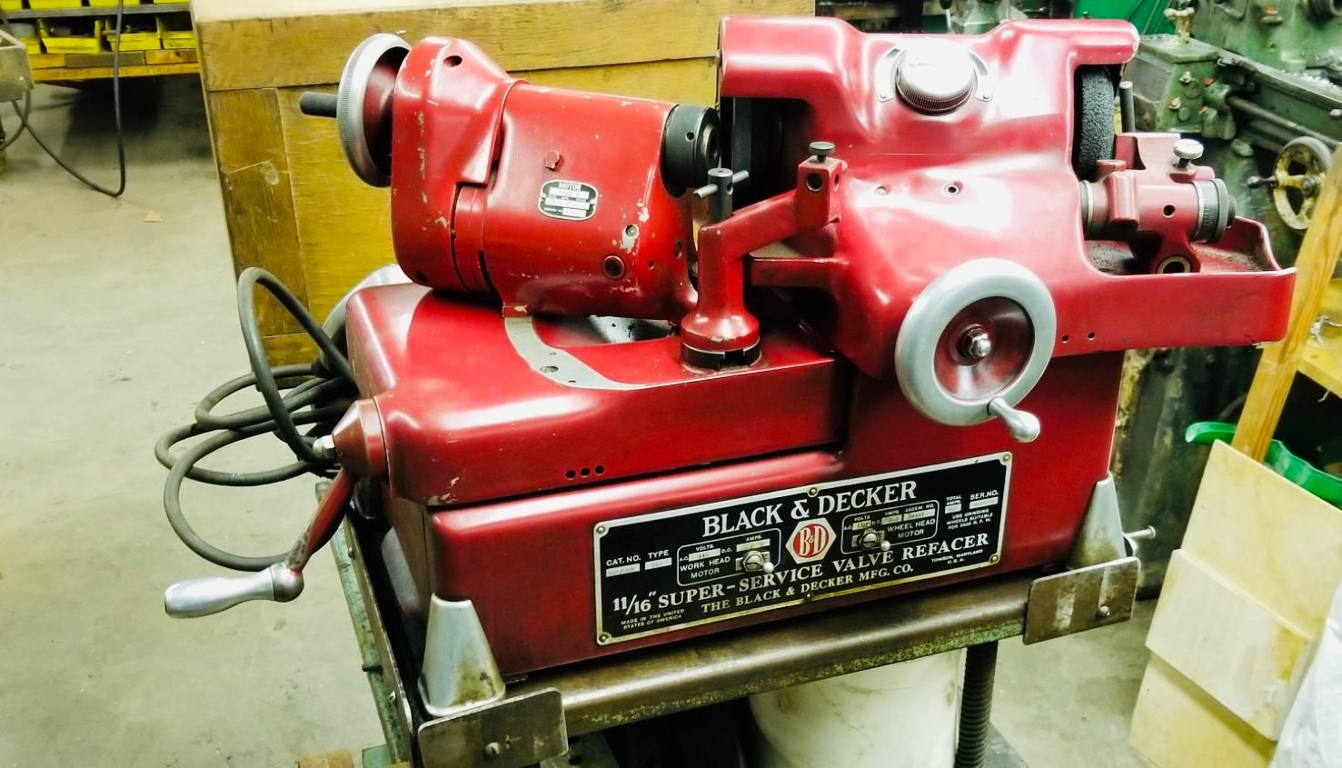

I've never seen anything like that. The ones I found were like big lathes.

We had an old Black & Decker set-up in the shop in the 1970-80”s. It also came with the angle drill shown above, that we used for grinding valve seats. The machine (refacer) that ground the valves is what takes up the space. IIRC, it had a footprint approx the size of a brake lathe. We bought it used. I remember tearing it apart to replace some motor mount bushings, electrical cord, belts, paint, lube, etc. While I don’t remember all of the details, I do recall that it was HEAVY. I see them for sale on eBay often. If you do opt for one of these relics, you’d be doing yourself a favor by finding a location where it can live without having to be moved. This isn’t mine, just a picture I found on the net that resembles the machine that we had.
