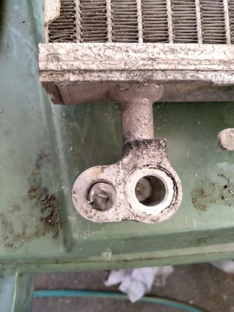

my new AC condenser didn't come w/ the lower stud where the suction tube connects. I have to reuse my orginal stud.
1. are these inverted torx sockets metric or regular?
2.did I already booger up the torx star head? yes I had vice gripes but didn't use much force.
3.can I tighten 2 nuts together and grip on the 2 nuts to remove stud?

1. There is no metric or regular Torx. Just Torx, Torx Plus, Security, Inverted. These should just be your standard E Torx.
2. Can't tell from the picture.
3. Yes, you can. It is likely seized in the aluminum though, and may require heat.
4. I do not know, but you could likely use any equivalent stud of any type.
