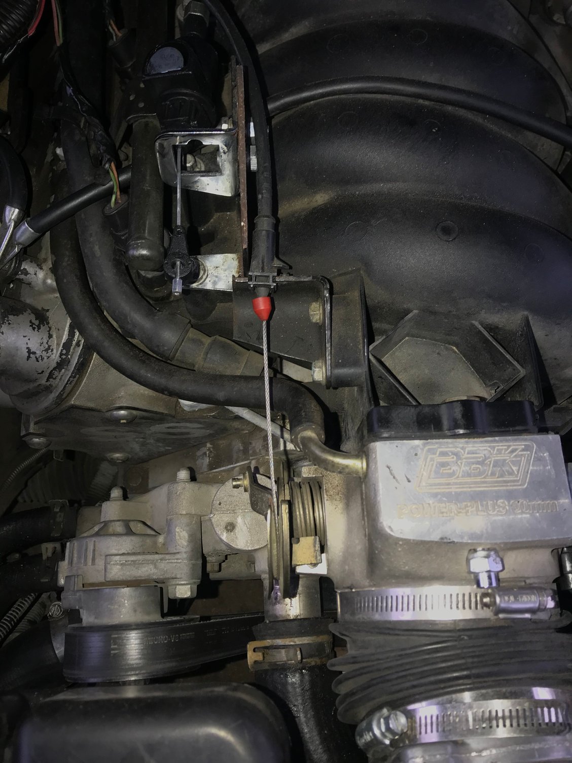

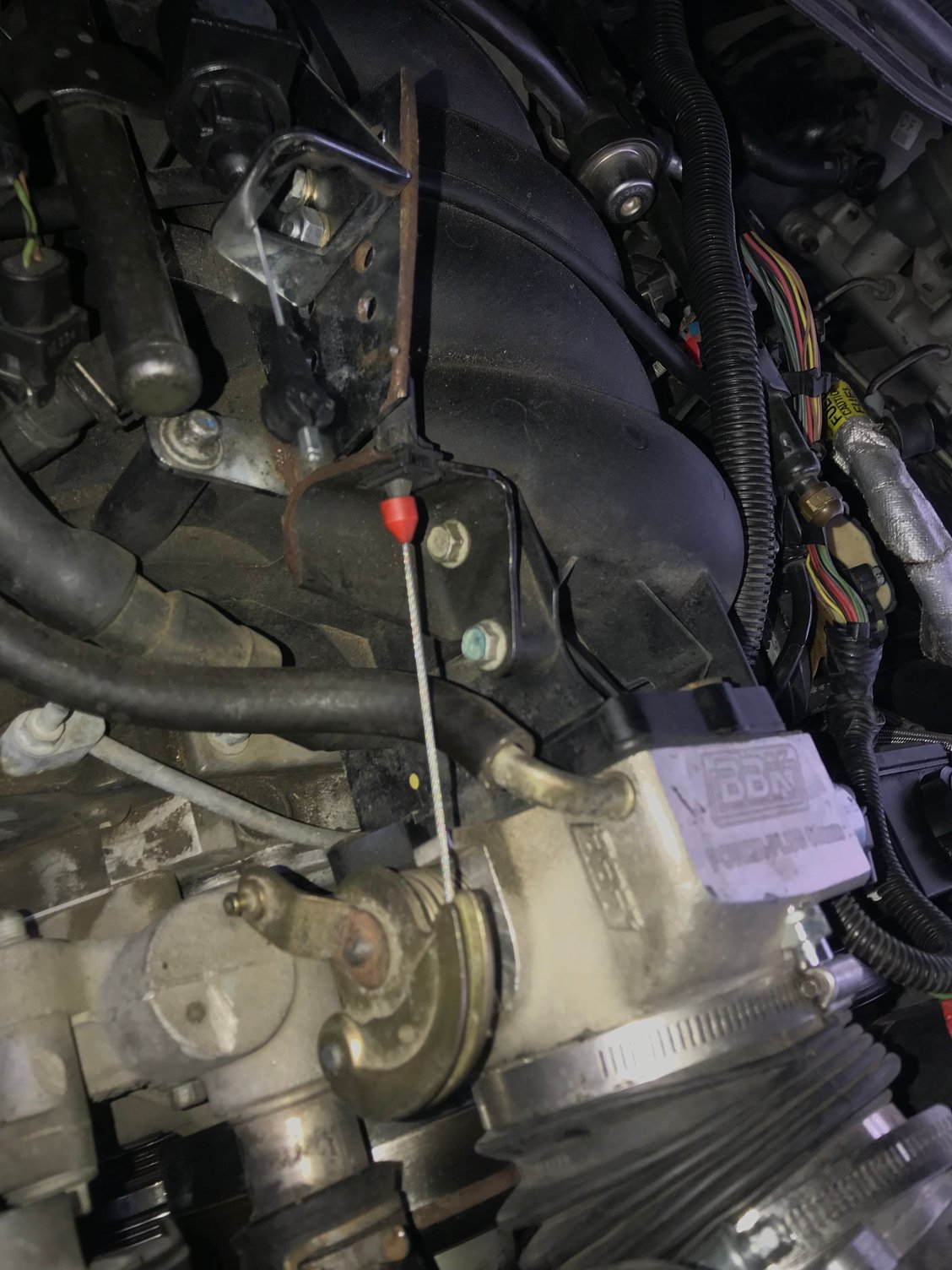

Hello precious owner made this make shift set up and confused on what I need to buy to make it how it’s suppose to be.
Attatched photos of current set up

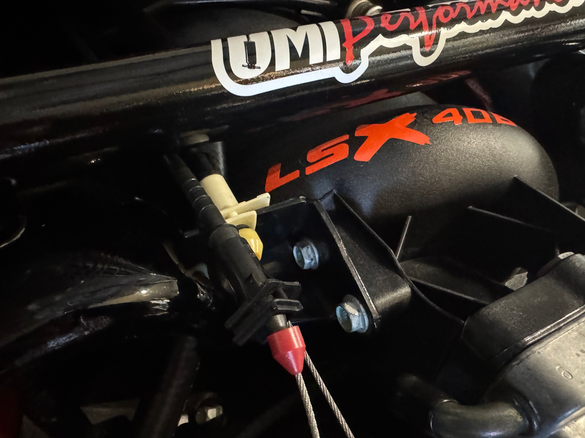

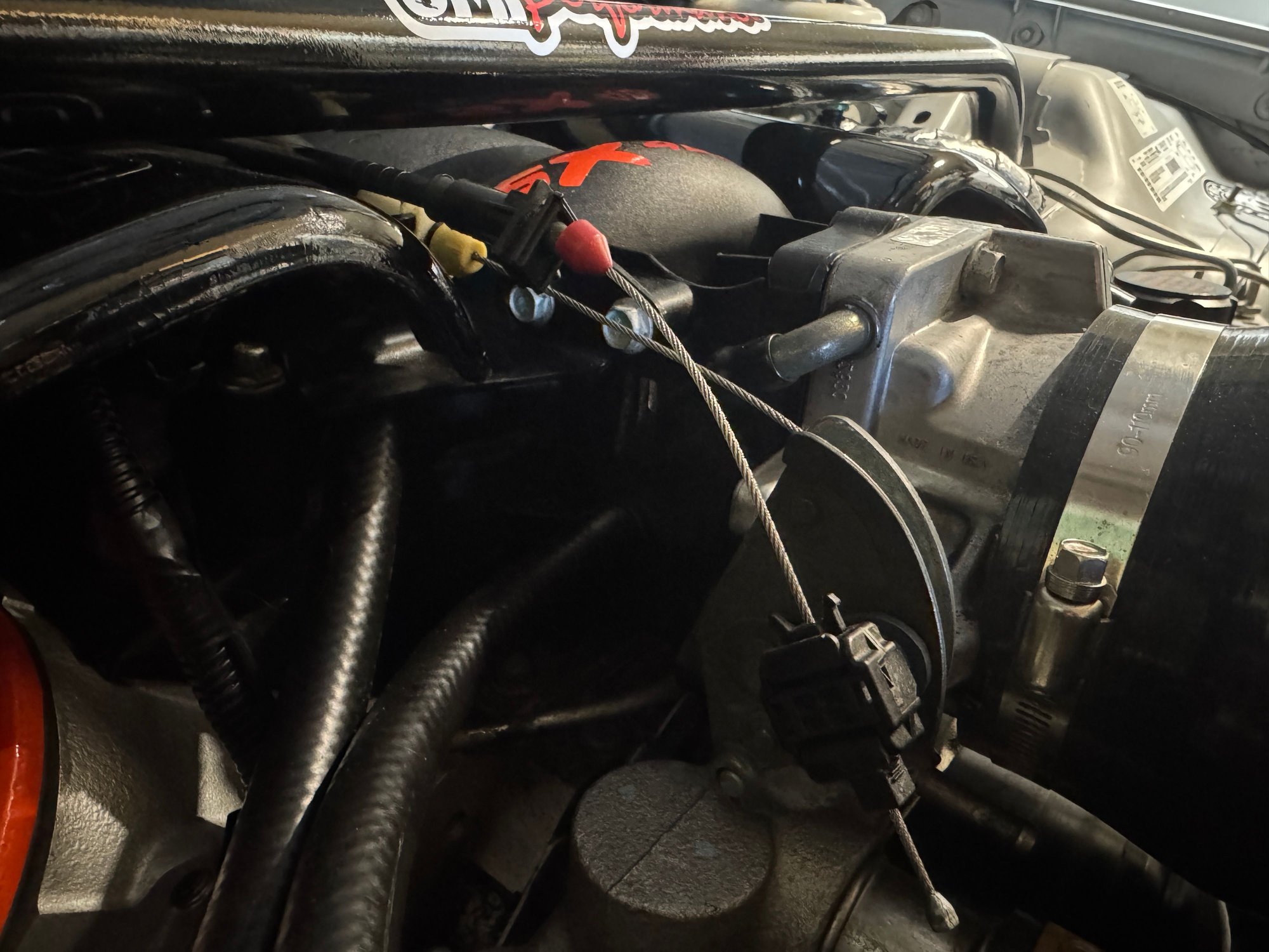

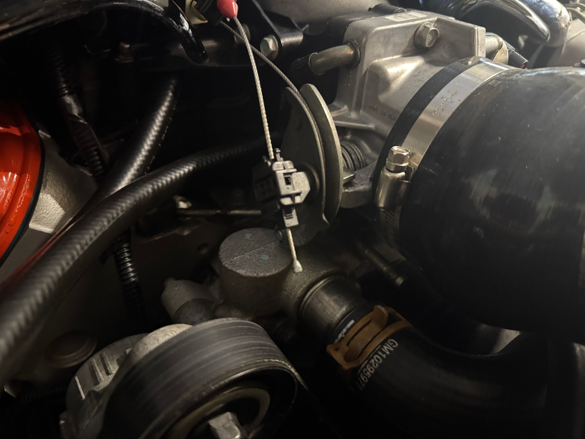

Are you wanting to replace the entire throttle bracket? This is how mine looks. I know they still make them. I was just bored yesterday and scrolling Walmart online and a throttle bracket popped up.

That car has been Frankensteined with a 700R-4 transmission. That kickdown cable setup isn't even close to working correctly, and I doubt you'll be able to make it function. Why not just replace the transmission with what should be in the car, which is a 4L60-E? If you want to try to make what you have work, buy this: https://www.bowtieoverdrives.com/cat...php?ITEMID=225 However, you could buy a used 4L60-E for that price.
